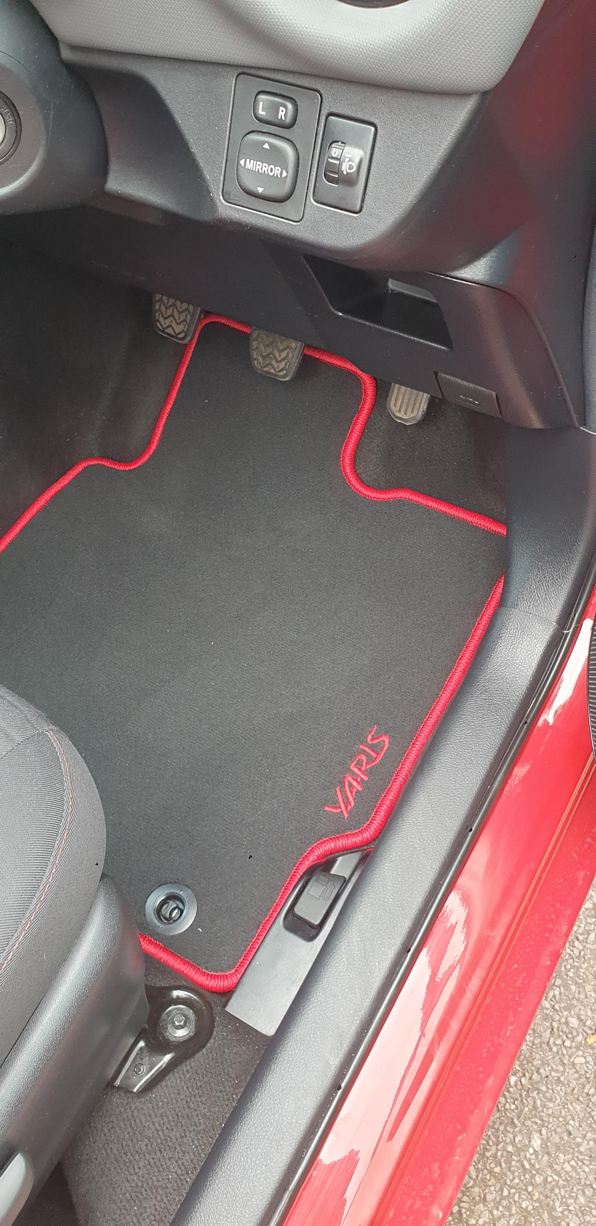

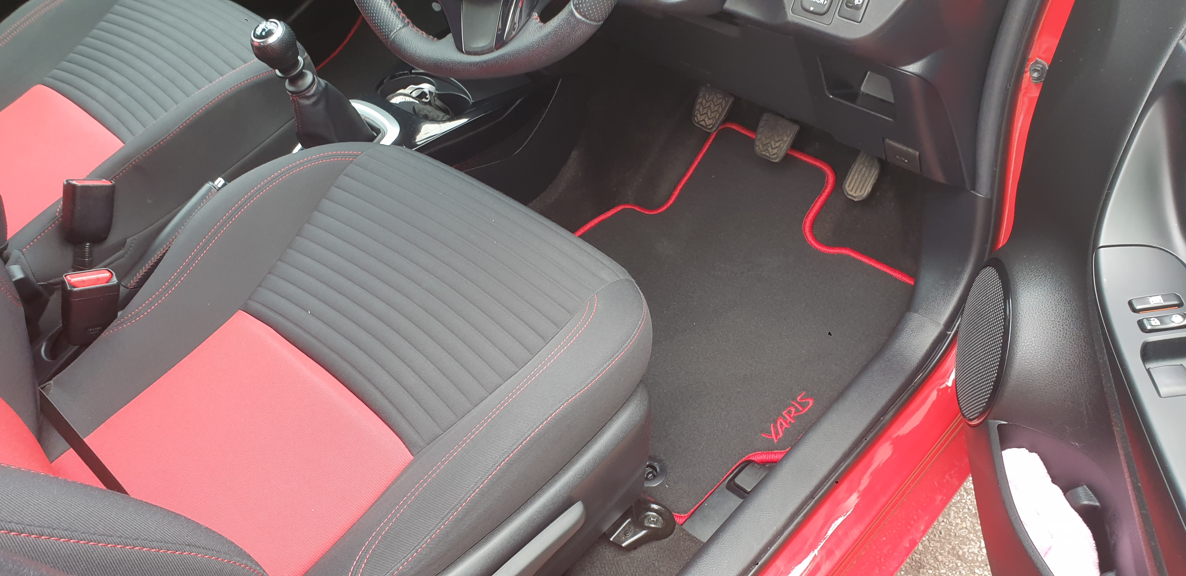

Just been at the dealer as I had to pick up my mats and asked them to have a look and it's all fine 🙂

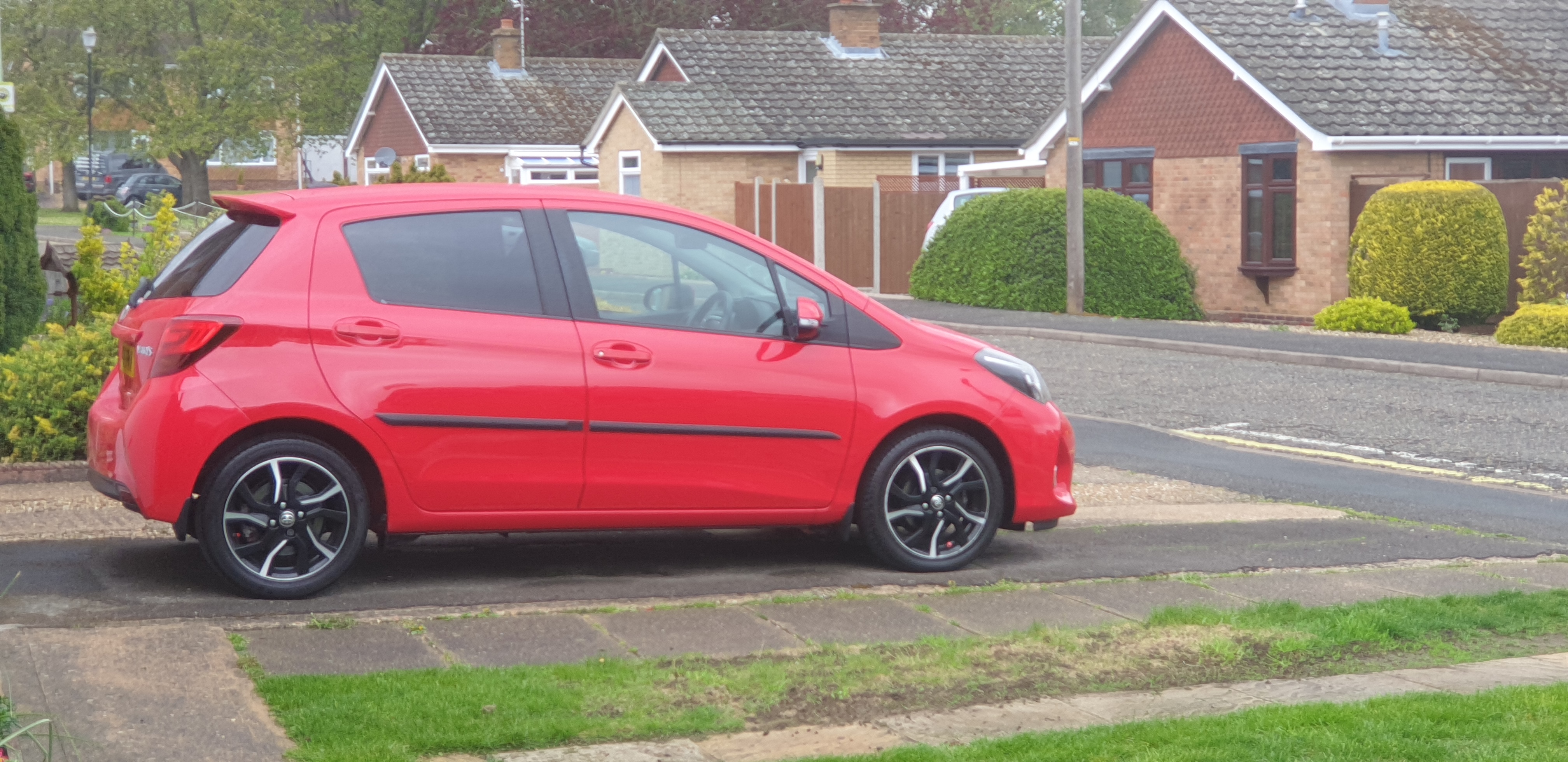

There are two unpleasant sounds , first one is the typical Toyota engine sound, all Priuses and other hybrids sounds like that, the second is more rough and keeps coming and going, that might be some pulley or bearings, whatever has ones and they rotate with the crankshaft or the belt itself, or even the timing chain. If it’s me I will change the Oil and do engine flush, than will change the belt with Gates, these are one of the best belts available and often fix exactly similar issues, however needs to be diagnosed first, than will look for anything else, but tbh if you don’t hear it inside, the engine is running sweet no need to worry to much, just enjoy your car, I like this red Yaris a lot , good choice 👍 🚗
