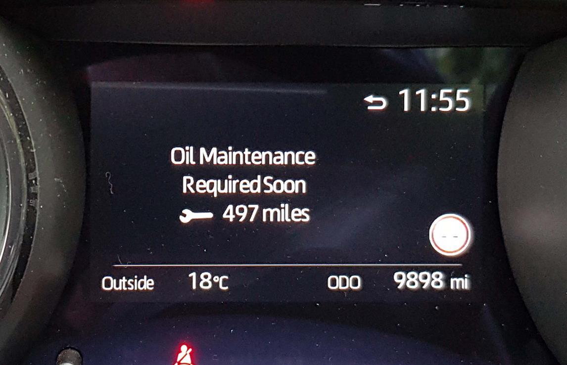

This warning message just came on as I was driving home this morning (see pic).
Considering my 2020 Yaris Mk4 Hybrid Excel (supposedly) had a major service at the end of June this year (according to Birmingham Toyota I purchased the vehicle from - and Toyota's database), should this warning message be showing?
Does anyone know of any circumstances / problems / faults which could cause this warning to appear in error?
...or do I assume that this dealer has lied about doing the service (to me and to Toyota UK) and is yet another complaint to add to the inexorably-growing list I am putting together?
Hope someone can help.
Cheers
Chris 🤔

Oh, dear, dear, dear ... The only reason that would appear is if the dealer hadn't reset it properly at the time of service and I believe I am right in saying that that requires Toyota Techstream in order to do that (which I'm betting this dealer-who-seems-to-be-on-a-mission-to-ruin-Toyota's-name of yours doesn't even have!). That dealer of yours is really outdoing himself, isn't he?!!

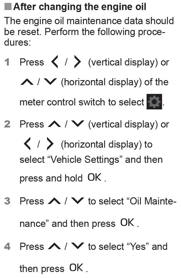

To reset go to      Settings - Vehicle settings - Oil maintenance
just seen Bobs above.  You Tube shows lots of “tricks”
Many thanks chaps. I didn't realise you could switch off the Oil warning via the vehicle menu.
