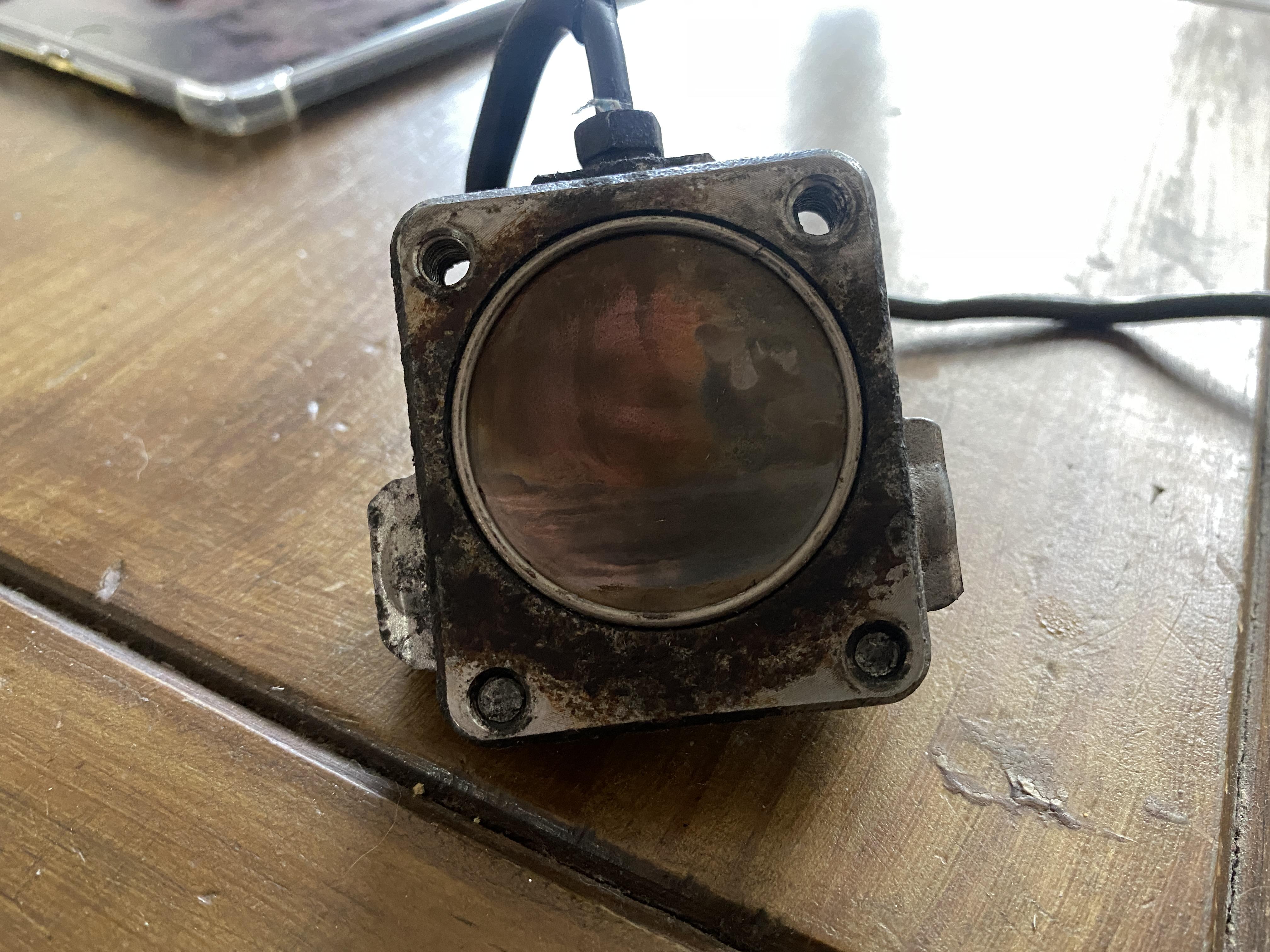

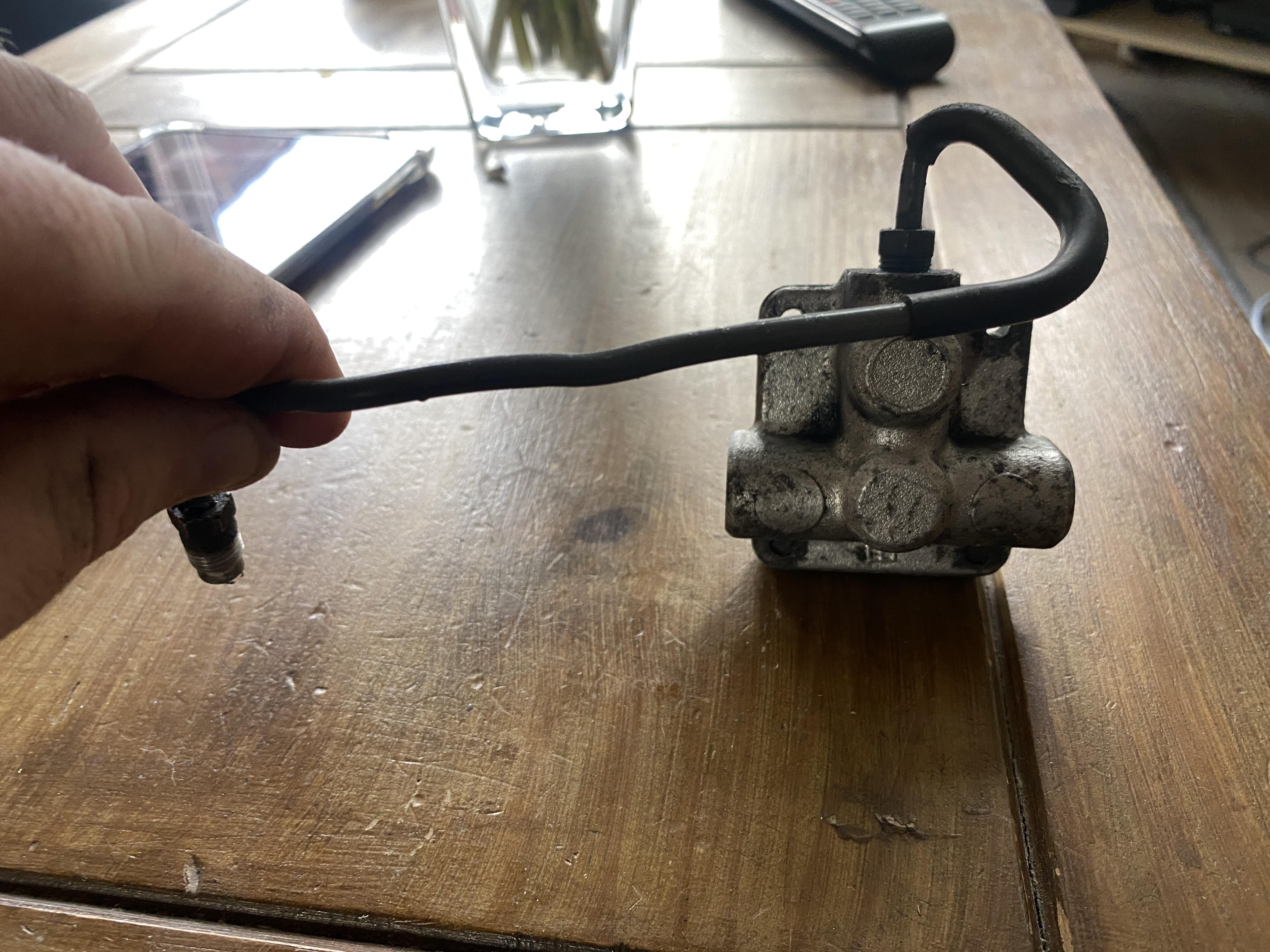

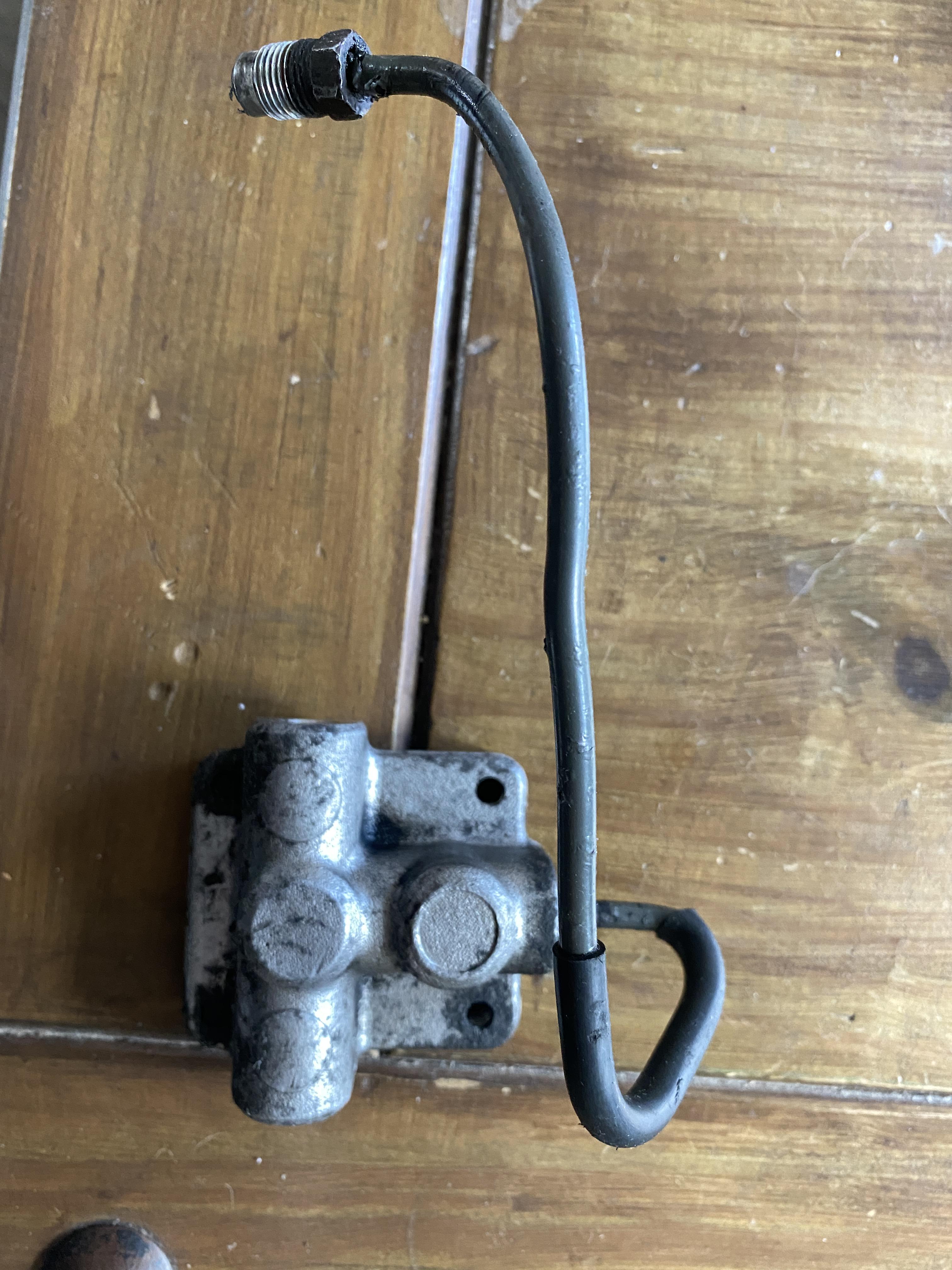

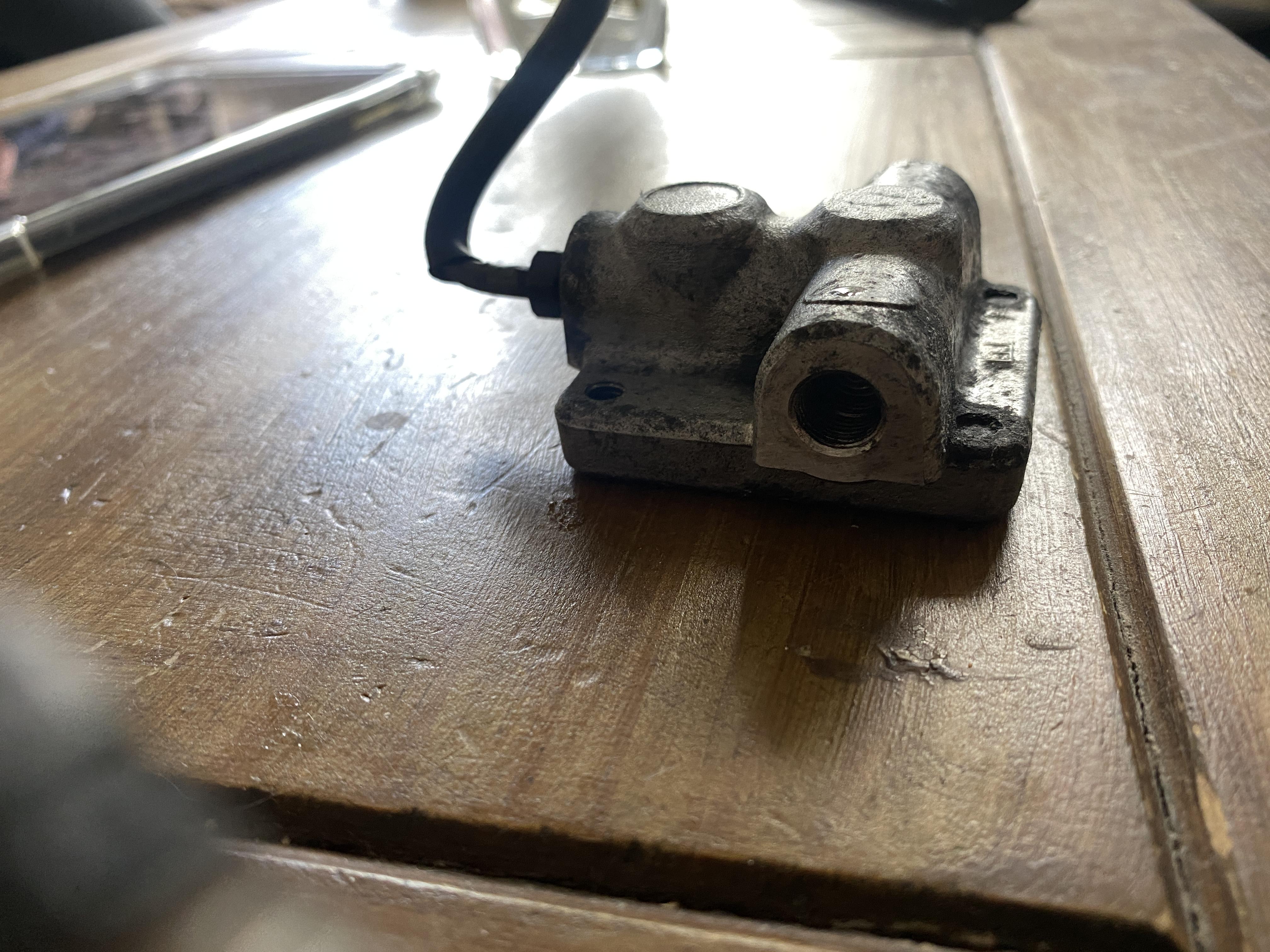

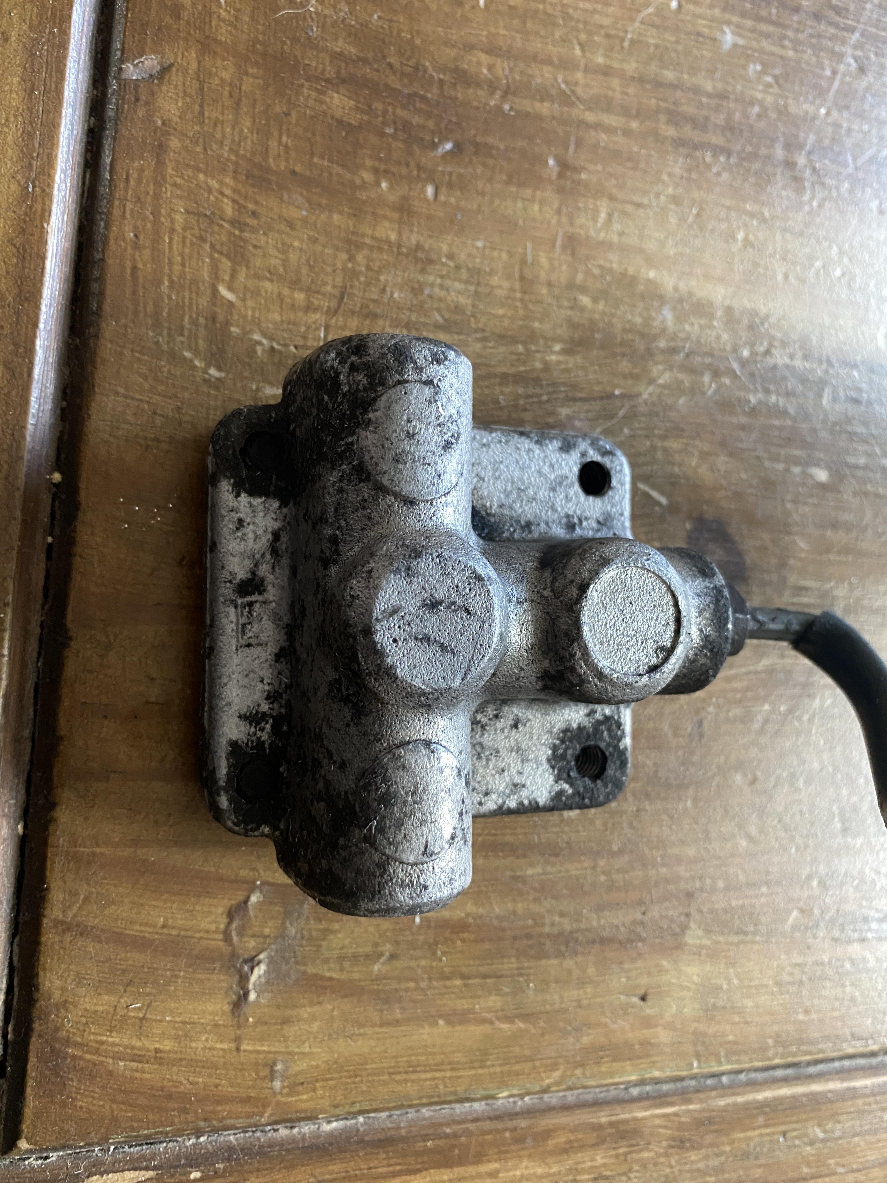

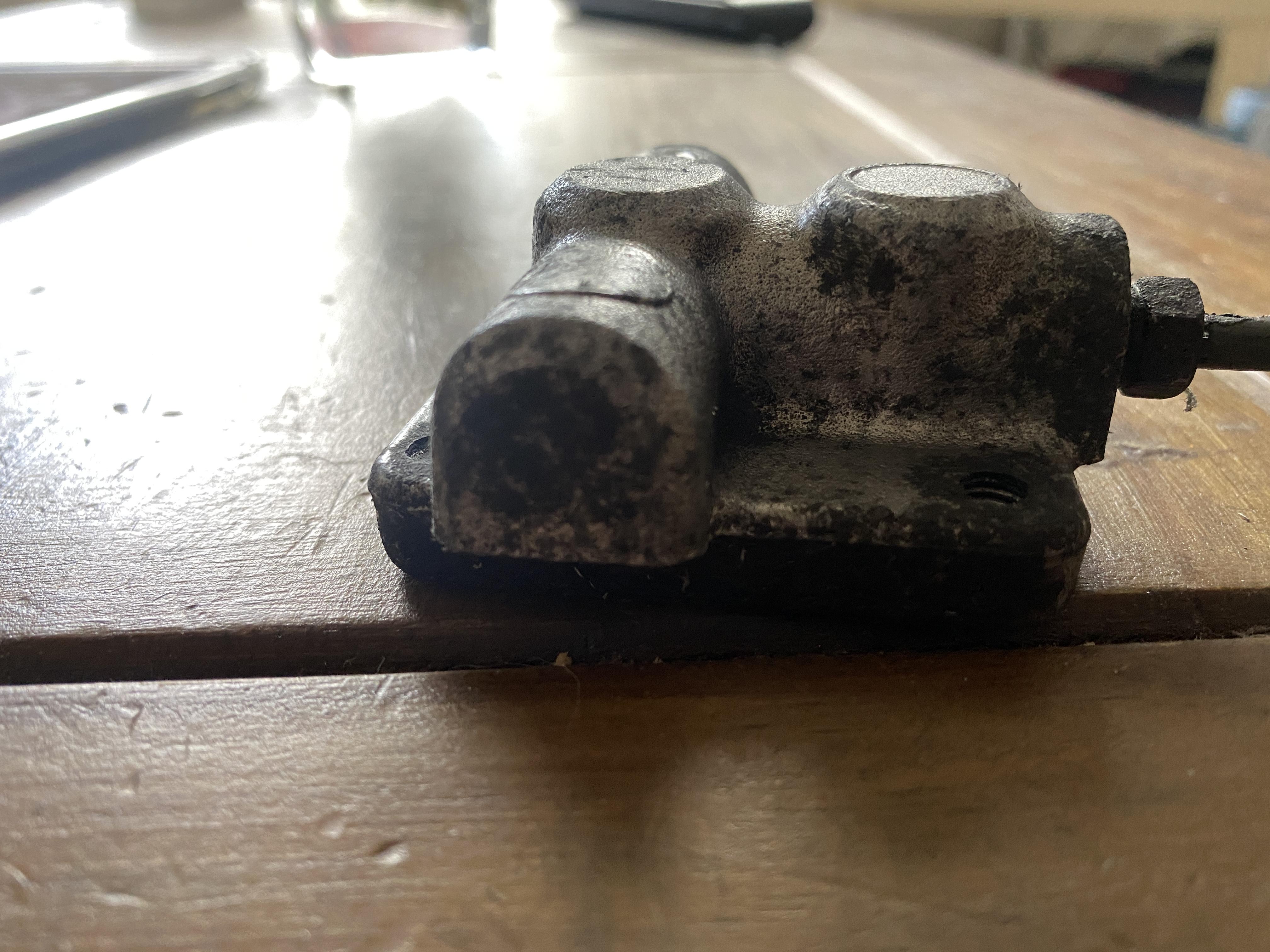

Good evening folks, I’m at a bit of a stump with this one.
Replaced the clutch slave cylinder on the old girl today (Rav4, gx d4d, 143000).
All very straight forward apart from this part which I can’t see what function it does. It turns out it wasn’t the CSC that was leaking but it was this piece at the rear.
Please see the photos, no part number is on the unit.
Any idea??
Moved to the RAV4 club.

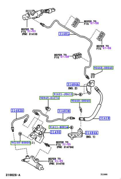

Its a Clutch accumulator, part number 31490-28110
