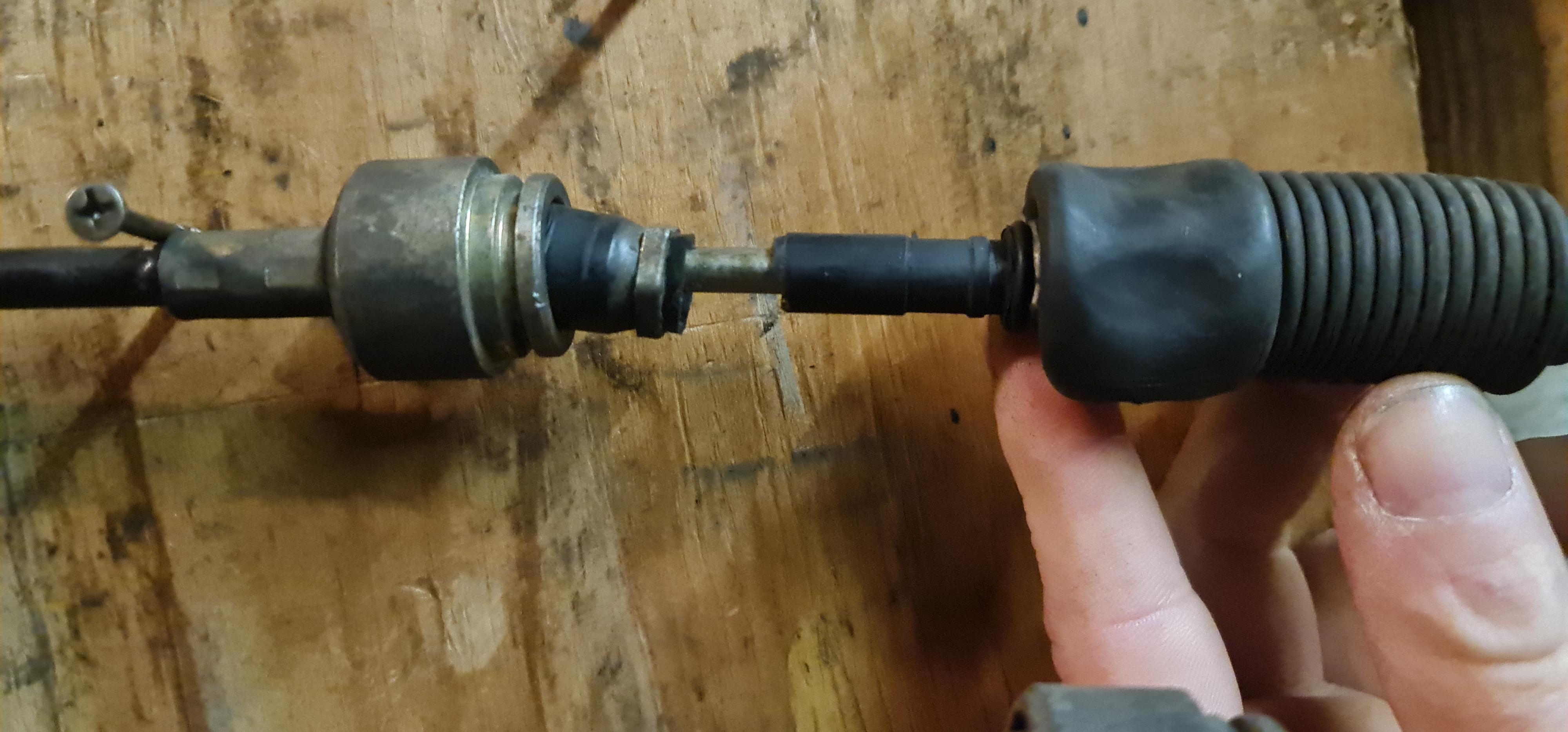

Had this problem on a yaris shifts fine from 1 to 2. But not from 3. To2. . On one gear cabel the "inner tube" was broken so i guess that from 1-2 gear the cabel was pulling wich was no prob. But 3-2 it was supposed to push the arm on gearbox back, wich it could not do whit the broken "inner tube". Or shomething like that......can't remember exactly. But new cables fixed it anyway. So worth a look at least.
Think i still got the old cable,can post a photo, in case my explanation make no sense..
Sorry for bad spelling 😃
