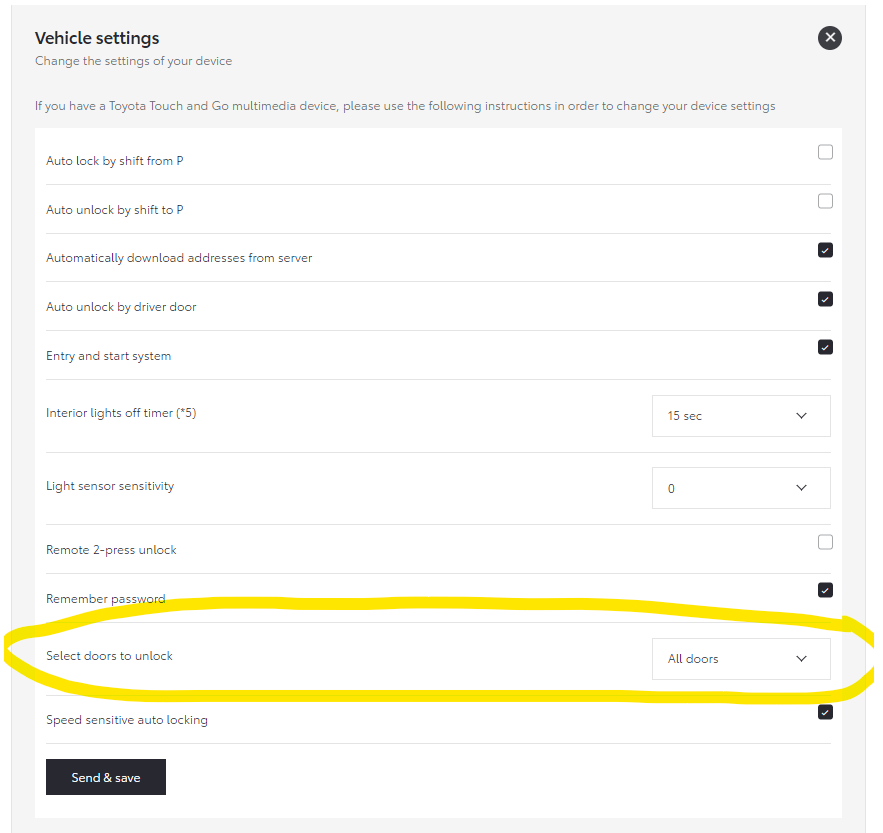

When opening the car only the drivers door unlocks such I have to open that door and unlock the car fully from the button on the door.

You can change door opening setting by logging into your My Toyota online account (via web browser) there is a section to customise various options.

For the door unlocking question specifically:
My Toyota > Vehicle Settings >
and select the "All doors" option

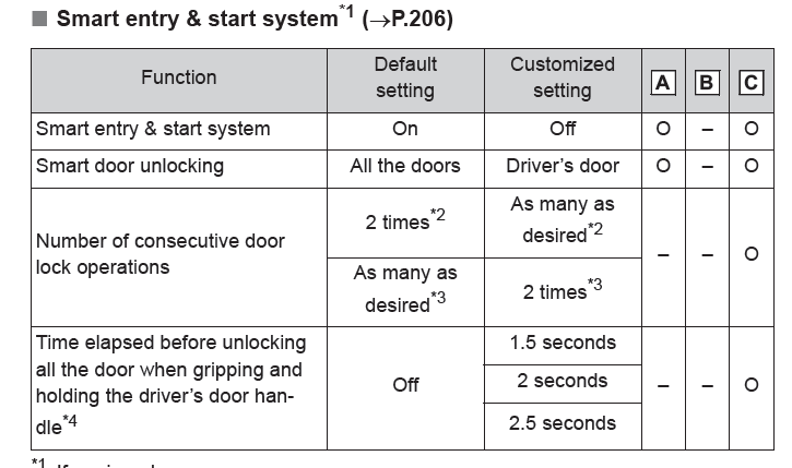

Also see page 629 of car manual, downloaded also via the My Toyota log in, Owned Vehicle. This allows you to customise a wide range of functions.

The door lock settings can also be changed using the navigation system or multimedia system (or by the dealer)
I just find the online option easiest ...

I tend to look at page 629 of the manual and take it from there, it took me a few head scratching hours to figure it out when I first got the car.

Sorted door locking, thanks.
