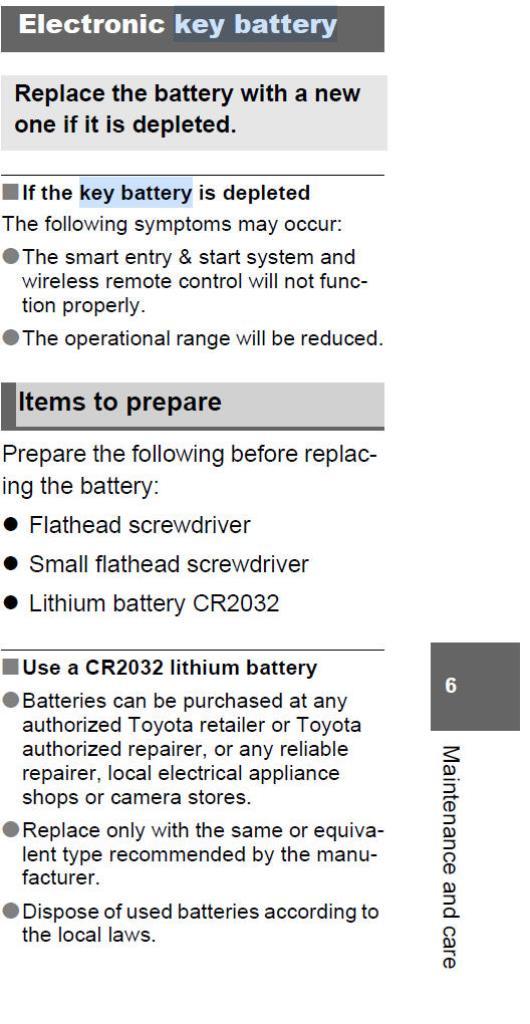

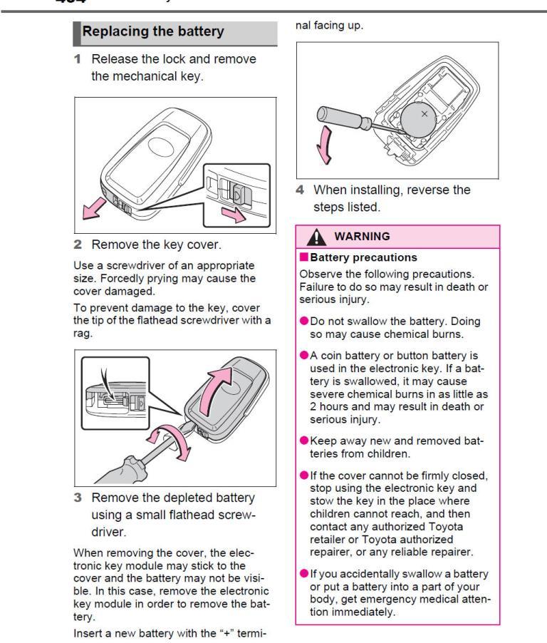

You could try changing one of the key fob batteries yourself and that would maybe save you a journey, these are from the 2022 Rav4 manual but it shows you that it's not difficult if you want to give it a go.
