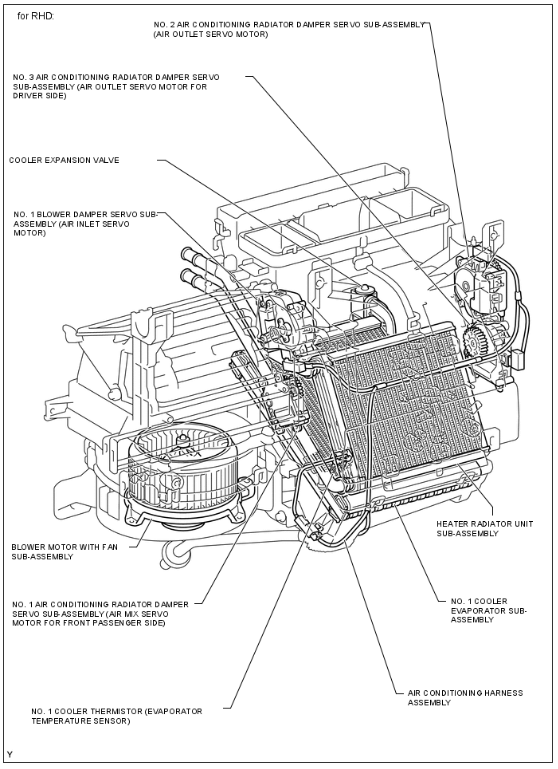

4 hours ago, Maureen peters said:
Yaris 11 plate has anyone had a problem with the heater, there are 3 motors and I need to know which one controls the direction, 3 are listed but they don't say which each 1 does, any help
really needed
#1 87050C is for recirc function
#2 87050D is for air direction
#3 87050E is for temp function
