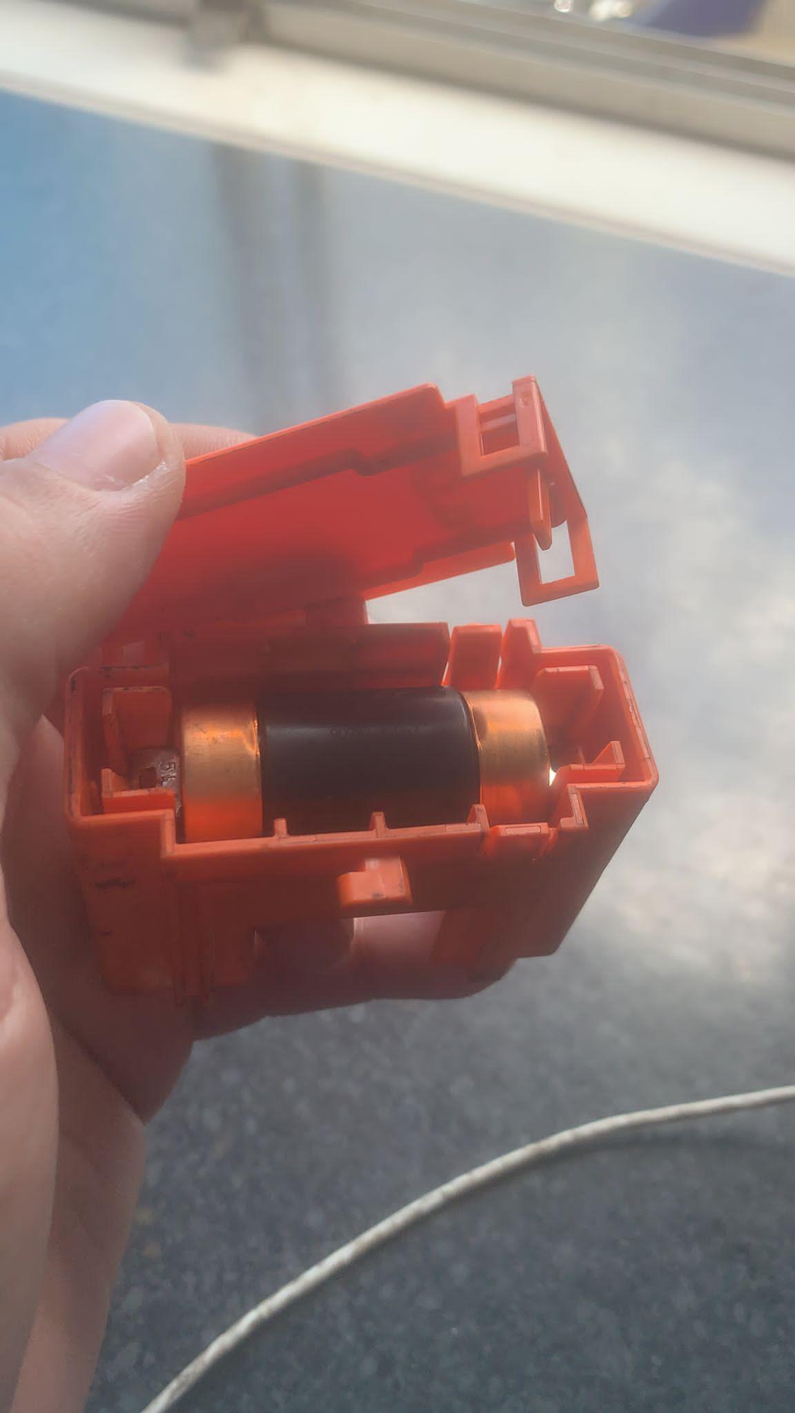

What is this?
6 hours ago, Sameeeee said:
What this battery called ?
That "Battery" is the HV pack main fuse  or service plug
Replacement is G3834-48010
Only replace once, if it blows again have it checked out or you run the risk of a more expensive repair.
