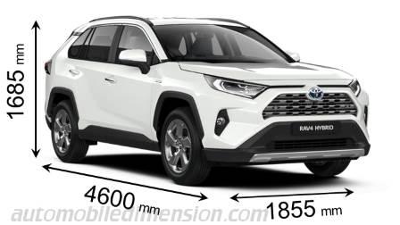

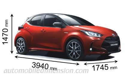

12 hours ago, Cyker said:
Yeah, I was thinking if I hit a deep flood I can quickly lift so the engine cuts out and doesn't suck in any water if it came to that, then just carefully crawl out on the electric motors alone :fear:
Thankfully I've been able to avoid the worst of it, and the Yaris is so narrow compared to these gigantic SUVs I've been able to skirt a lot of the deeper puddles on the roadside too (And then watch a massive roostertail fly up in my rear view mirror as the SUV behind me hits it at full speed :laugh: )
image.thumb.jpeg.12fc86bc773cb26842c85942bf04a826.jpegimage.thumb.jpeg.0b06939551113fa439fcedf027452ebb.jpeg
3" is not really that much narrower than these "gigantic SUVs".
