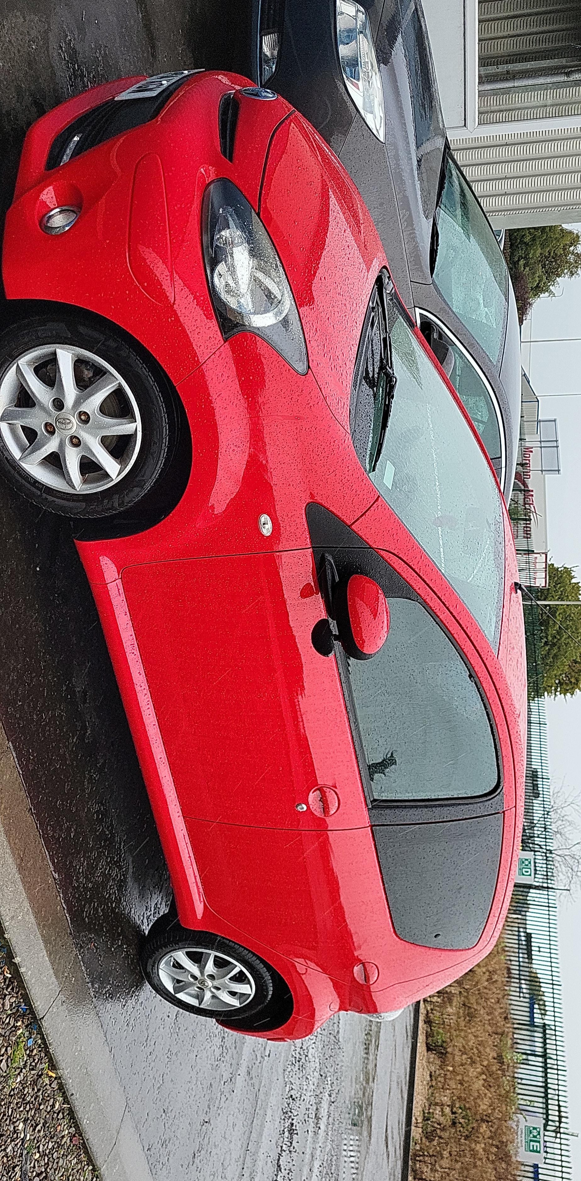

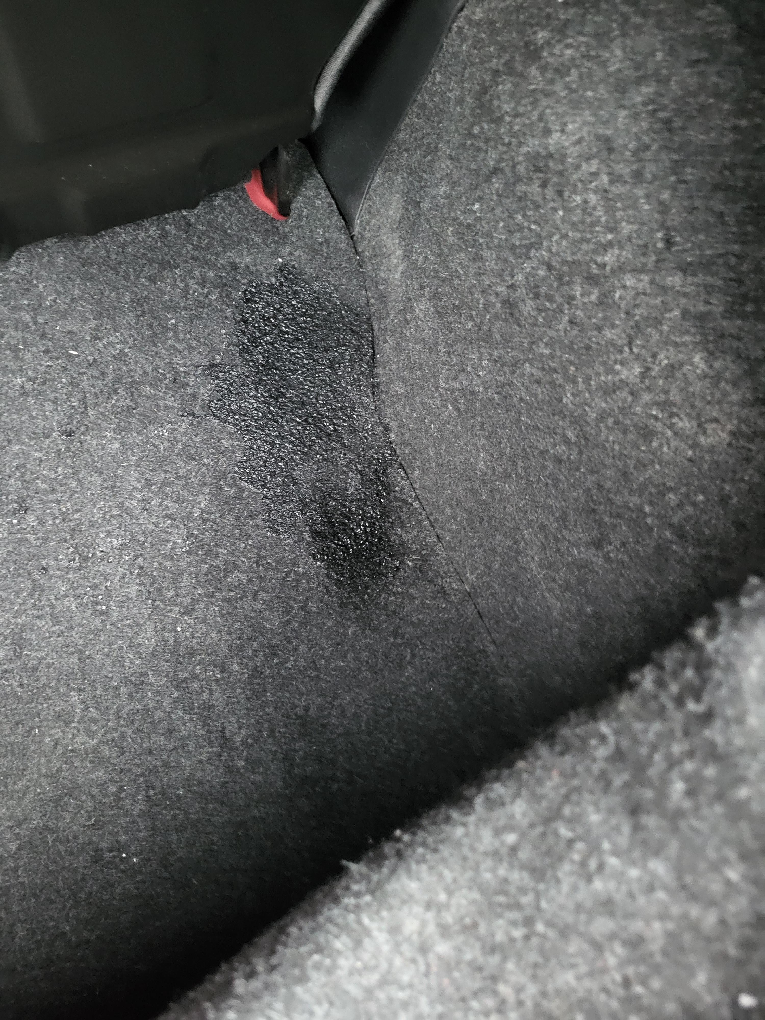

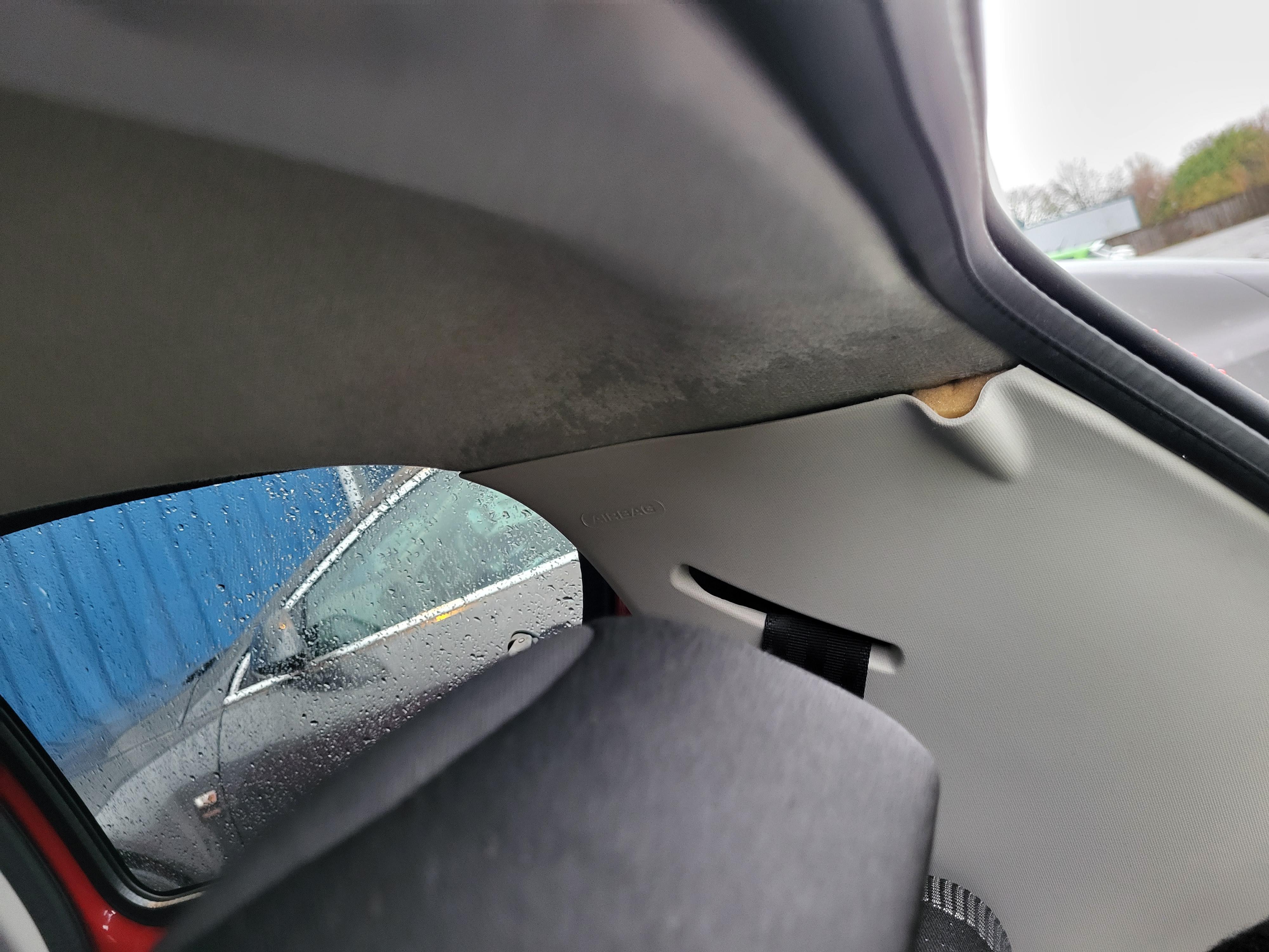

I have 2014 Toyota aygo noticed boot has puddle of water when it rains, roof of driver back door is wet too, so we have established it's coming in there somewhere and running down side into boot, iv changed seals on boot that's not the issue, thinking maybe the seal of back door, has anyone had any issues with theirs or know what it could possibly be?

Hi Colette, I don't have an Aygo but you could check the rubber seals around the wires that come out of the roof into the top of the hatchback door. Sometimes the seals allow water to pass into the roof space.
You would need to lift the headlining down at the back to have a look 👍

That water mark on the rear interior trim is extremely high and the high level brake light a likely cause if you have the first generation Aygo.
Thank you, I will check that, guy at work siliconed all the boot seal but today woke up with a puddle again so definitely not the boot seal, it's frustrating coz the garage has sold me the car like this in March but coz it was start of summer never noticed water getting in untill now we have more rain
Having cured this in the past and looking at the images my advise is start with the high level brake light. If there's still water getting in the boot after that move down to the rear light clusters and remove the old seals, clean them back and reseal with silicone. The three light fittings are the easiest to deal with!
