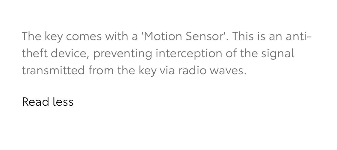

This is from the website
I think they have been motion sensitive for some time certainly my ‘21 PHEV has these keys. Even so I put them into a Faraday pouch when they are in the house.

Interesting. I wonder if my '21 Excel has them and I just don't know it.
The tricky bit, of course, is being able to check/test it. 🙂
ETA: The 2021 Sales brochure shows the spec of the Design grade as:
Main features (additional to Icon)
— 18" silver alloy wheels (5-spoke)
— Toyota Touch® 2 with Go navigation
— Front parking sensors
— Smart Entry with Motion Sensor Key
— Power back door
[my bold]
That suggests that 2021 Design and above all have Motion Sensor Keys.
Note to self: read the brochure more carefully.
