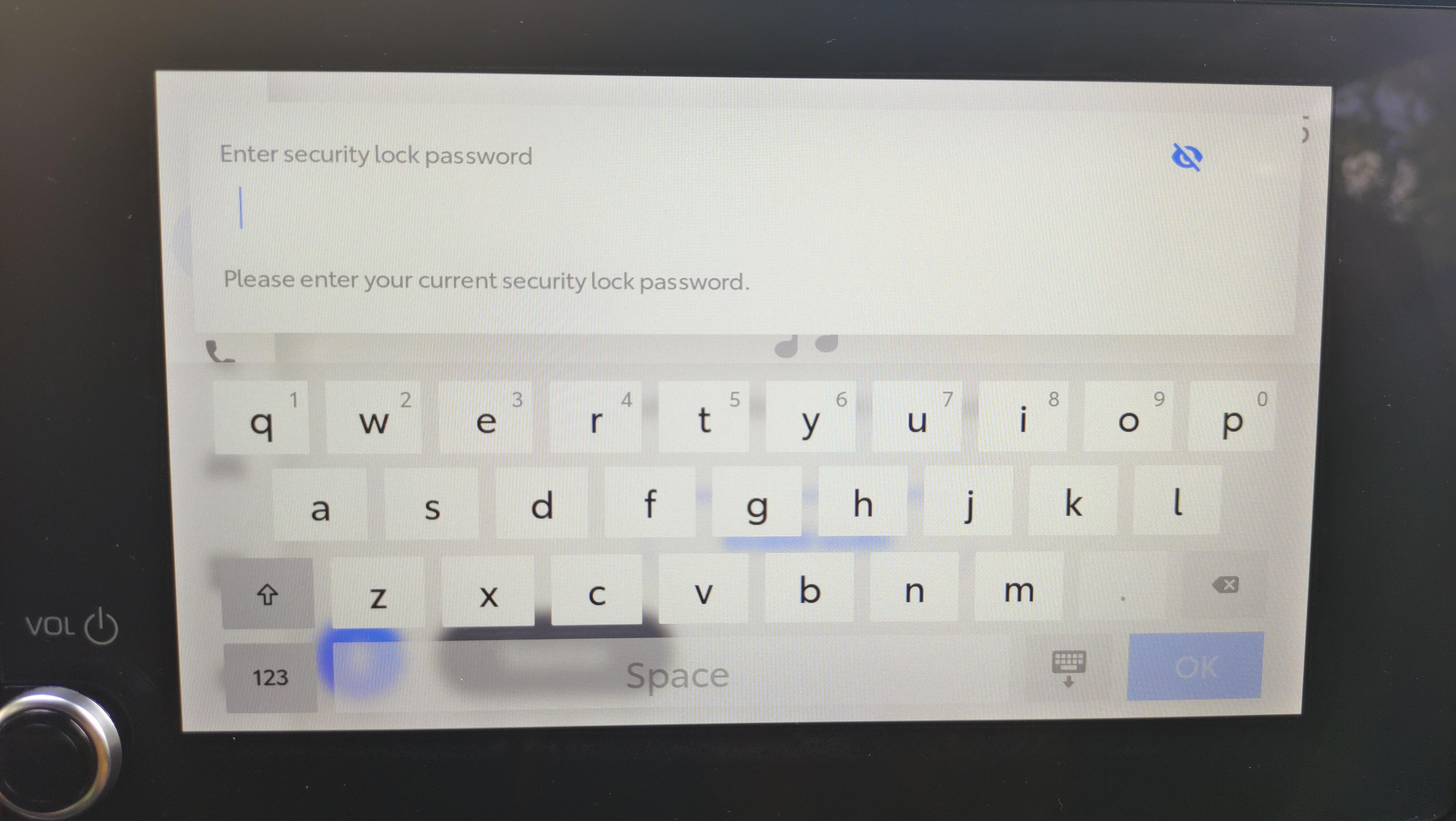

Hi everyone, yesterday I have swapped my previous car for 2021 Toyota C-HR GR Sport. All seems good to me except multimedia system. When checking the car the multimedia system had "Enter You Security Password" message. Without entering the password the multimedia device would not load. Only reverse cam works. The seller claimed that her wife set up the password and he will send me the password after checking with his wife (he tried calling her, but she didn't answer). He still hasn't sent me the password.
So my question is - is it possible to reset the password somehow if he will not send me the password in the end? Thanks!

That's the Smart Connect system screen & that was fitted for the 2022 model year on C-HR.
If the previous owner cannot provide the password then it will be a trip to Toyota main dealer.
The security system only activates if the owner has first set it up ( the default is OFF ) then the system will only prompt for the password if the 12 volt Battery goes flat / disconnected OR the multimedia unit is removed from the vehicle.

If the previous owner cant provide the security lock password your going to have to visit a Toyota Main dealer & ask the service desk for advise.
