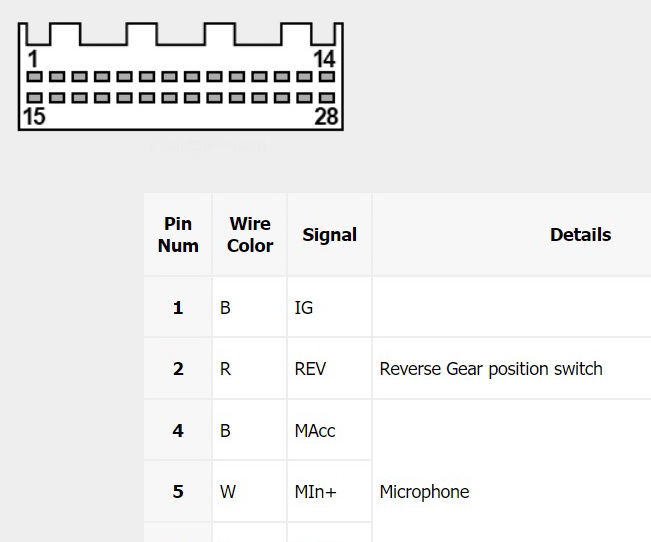

When I turn left or right, I use the indicators and the gear shift is on drive position D. In this case, the camera system is able to show me the curbs. But my Touch 2 with Go multimedia only enters camera mode when the gear shift is in R, not in D.
As you can see in the attached picture, on the 28-pin connector, pin no 2 should be for the Reverse Gear position. But my connector has no wire there. Is empty.
So, my question is:
How do I manually put my Touch 2 with Go in camera mode, without putting the gear shift in R? Does anyone know what signal or voltage and where I need to inject into my Touch 2 with Go to enter camera mode?

on a 2018 the reverse signal will be over can bus reverse signal 12v in, is disabled
What bird view/360 kit do you have ?
Only option i can think of, off the top of my head, is to wire the A/V input or purchase an a/v in cable, - 5–6 wires on the 28 pin
Pin 13 - Video +
Pin 14 - Video -
Pin 25 - Signal detect (ground to activate input)
Pin 26 - A/V audio right
Pin 27 - A/V audio ground
Pin 28 - A/V audio Left

flash22 thank you for your info.
The parking system I installed is this, but it was half-price a few months ago.
https://www.amazon.co.uk/Aramox-Panoramic-Surrounding-Monitoring-Recording/dp/B0BBVZTBCY/ref=sr_1_3?crid=2TLW1CZ1NKV7P&keywords=panoramic+parking+system&qid=1679132938&s=instant-video&sprefix=panoramic+parking+syste%2Cinstant-video%2C520&sr=1-3
From 28 pins socket, I will try to use pin 25. I hope I don't need to deactivate the speed signal from pin 17.
