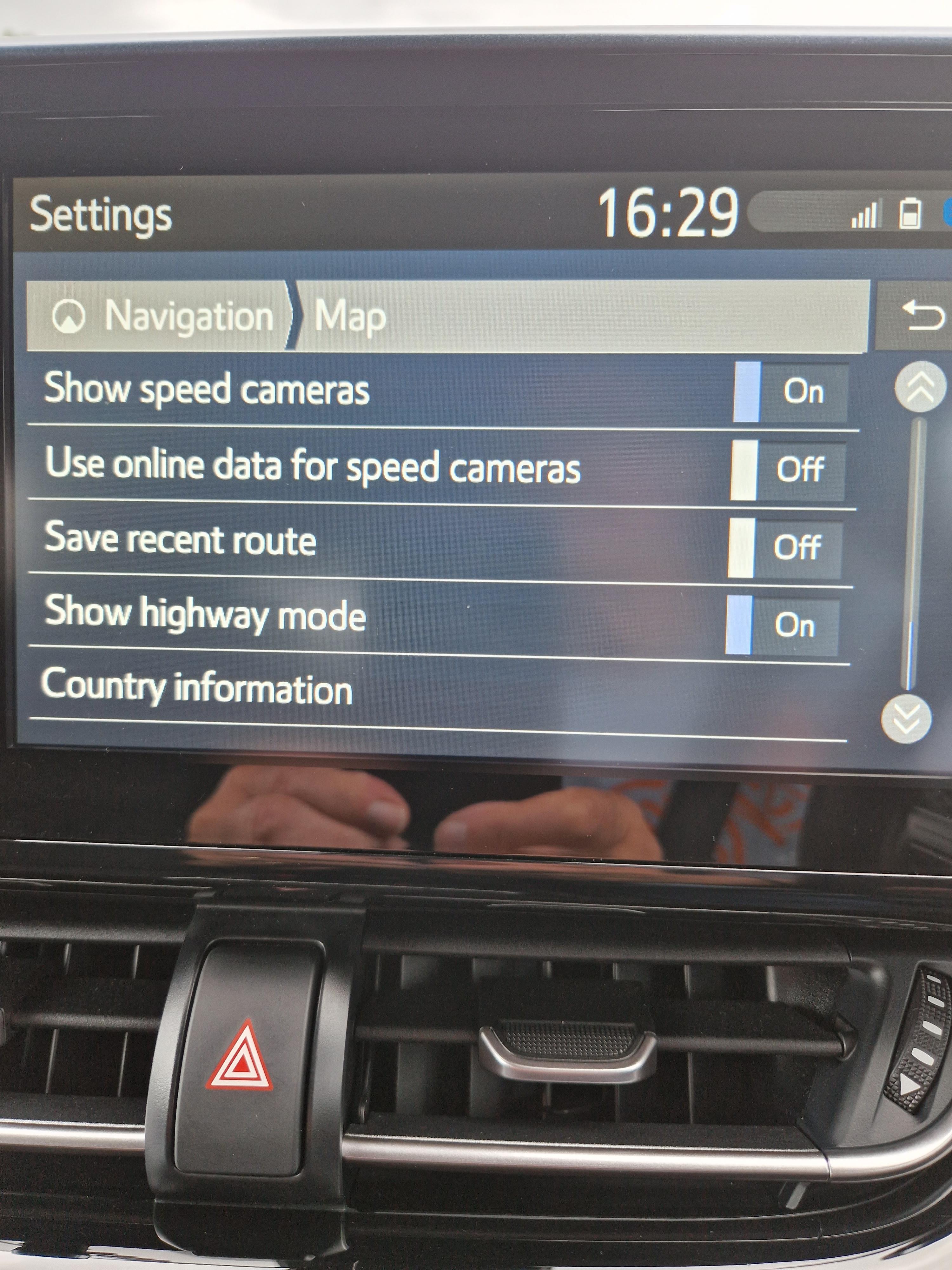

Just picked up my chr 2021  design which shows the speed cameras on the map but on approach does not give any warning noise. I have gone through the settings but can't find anything reference giving a warning.

IIRC there's an option in the settings somewhere for enabling speed camera detection which also turns the sound on. Also check the satnav hasn't been muted or something.
If I remember correctly it will be under the Menu button in the map settings. It's been a while
Thank you both for your quick reply. I have been through all the settings again, but there is no option for sound alert notification for speed cameras. I have attached 2 photos.

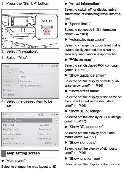

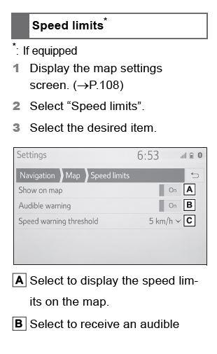

I think I may have found the answer on page 108 of my old C-HR manual. I have attached images of the pages and instructions. Hopefully this will help.

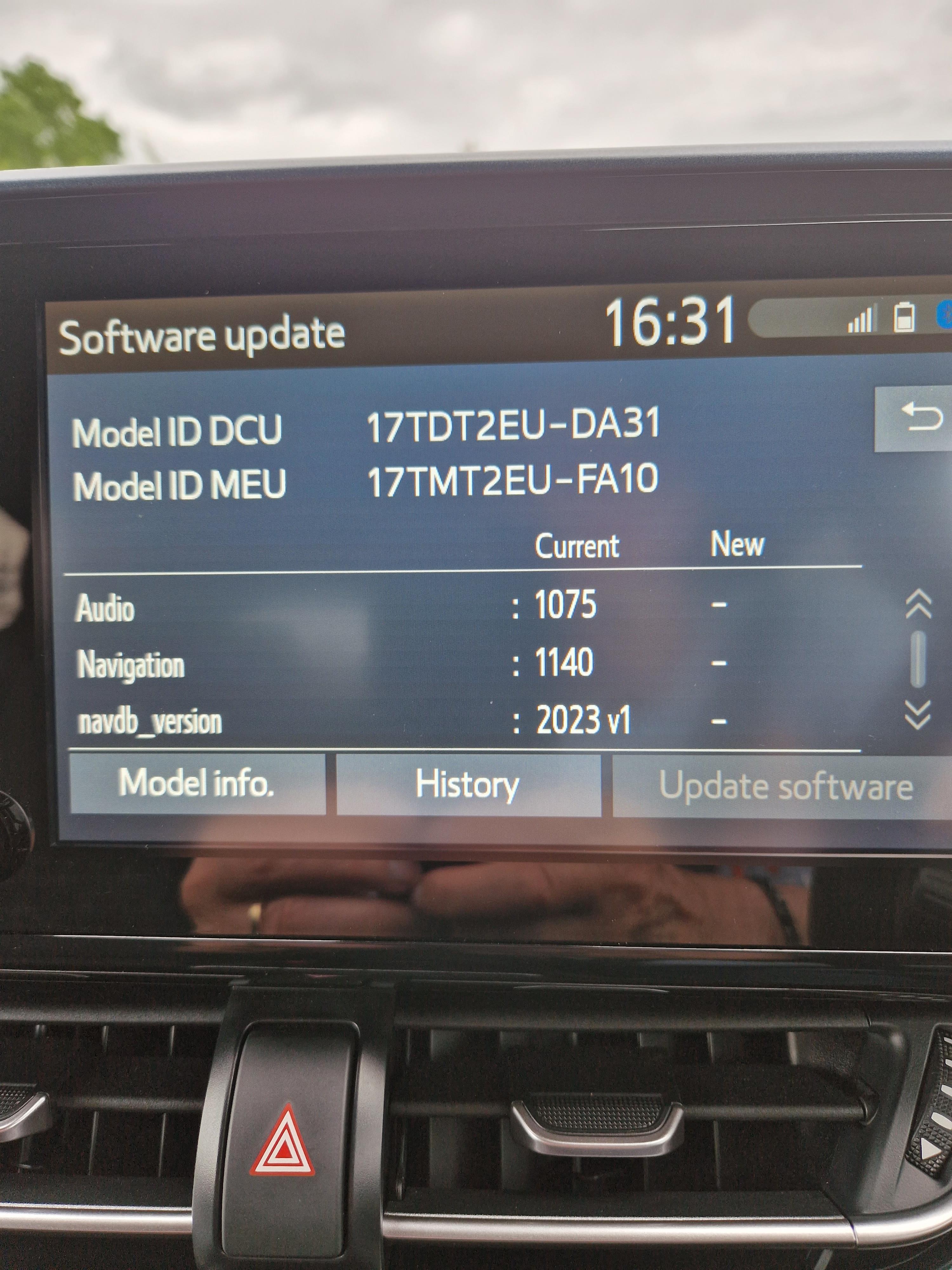

Thanks for all your help. Updated myT app and this afternoon the speed camera alerts was working. Tried them on a few known cameras. Bit of a mystery.
