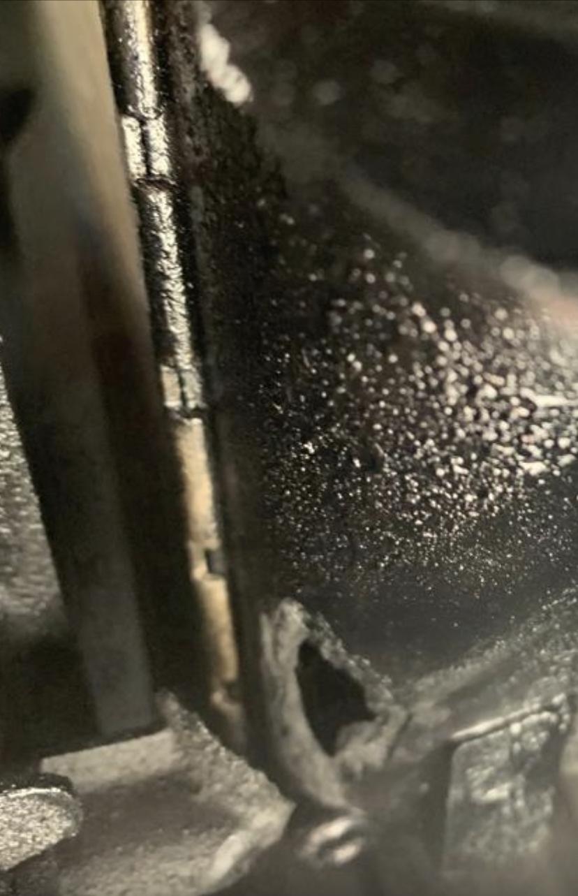

Thanks for the info Bper…….there was a hole in the bottom of the intercooler looked like it was damaged from underneath.
hopefully this will solve the problem🙏

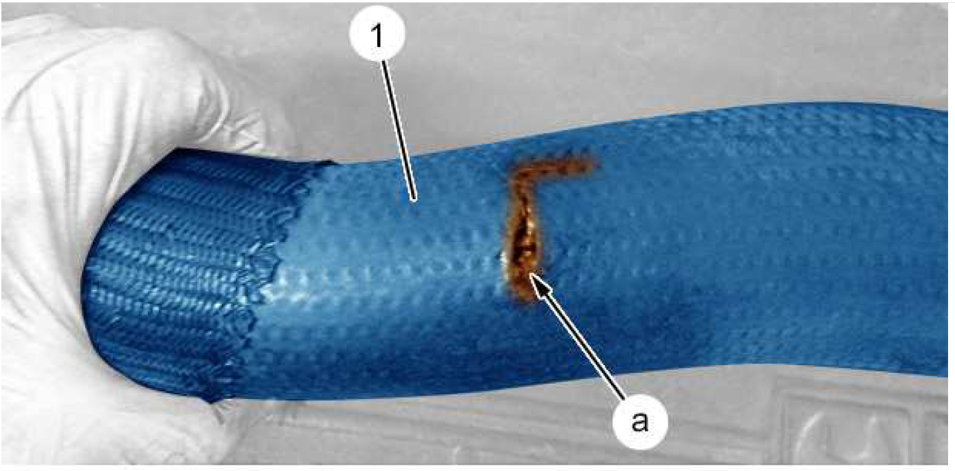

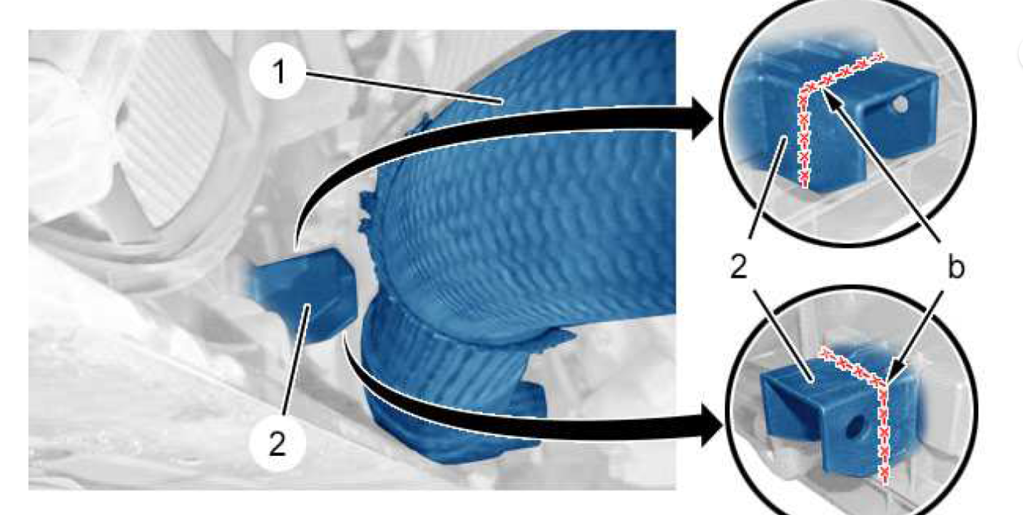

A Known issue, lower intercooler hose has a split where it has rubbed against an extrusion on the lower radiator, replace the split hose and trim the radiator extrusion
Just picked the van up…….it drives fine with no faults. Where the intercooler fits to the bumper it had broke and was leaking from the plastic bracket on the bottom of intercooler.
