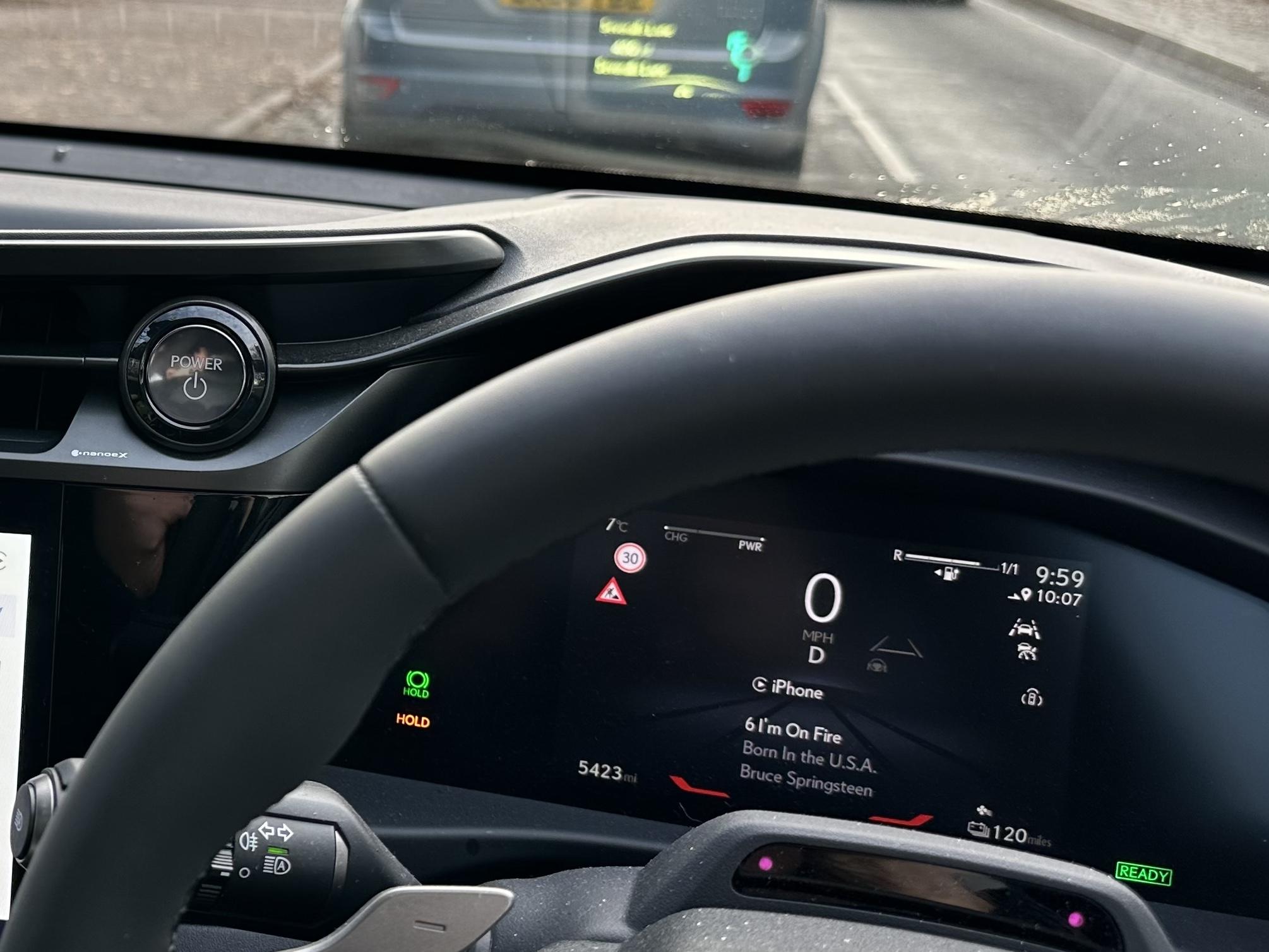

My Lexus RZ has the option to show in the central screen when the brake lights are on. This shows them being on when regenerative braking is happening.
Ooh that's neat, never seen a car you could do that with!

You can see the red lines on the bottom of the screen below the music track info - they appear when the brake lights are on in my RZ. They are not shown by default, you need to select them in the screen set up menu. Are you sure the bz isn’t configurable like The RZ ?
