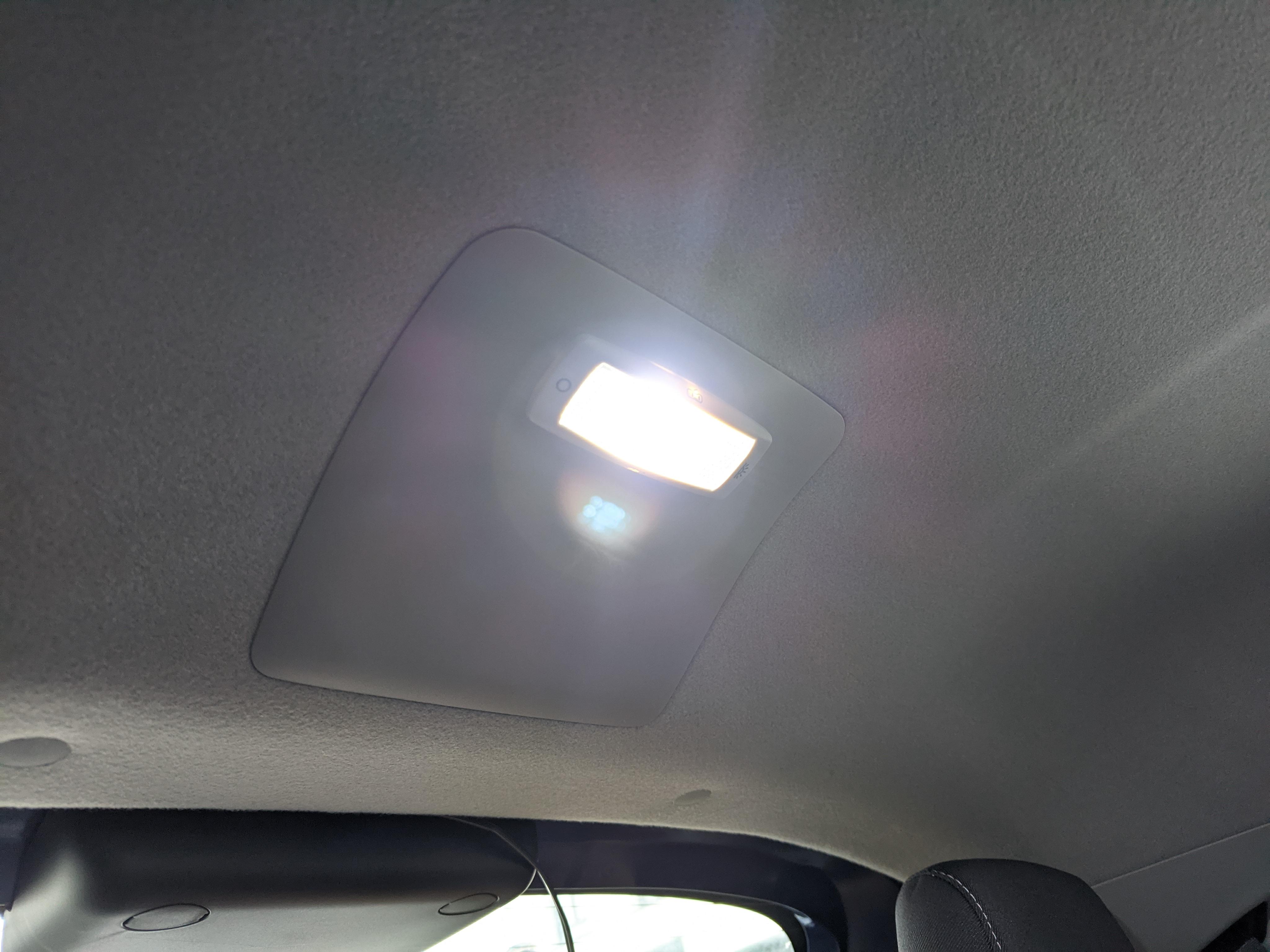

On 1/25/2024 at 11:36 PM, anchorman said:
Well, did another as promised today.  Some photos attached.
On the forth picture from the end you show the wire connectors taped to the car roof probably to avoid rattling noises.
Is sun in summer frozen there? Isn't there a chance the glue will soften and the bundle fall from the roof?
It’s not tape, it’s special stuff for air conditioning ducts in factory roofs and it’s actually more of a problem to get it off than it falling off.

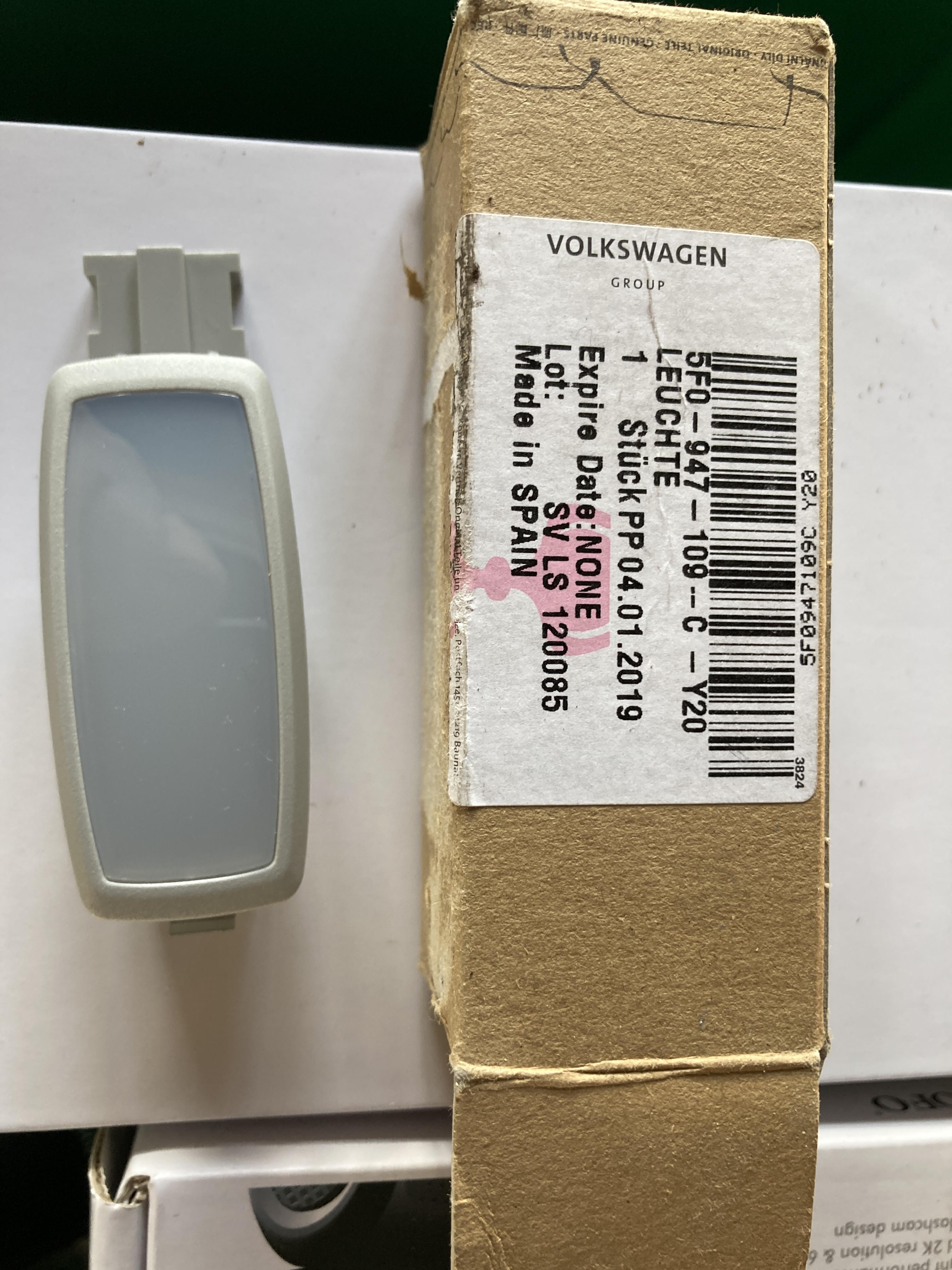

Also where did you get the LEDs they are much better than the ones I've got?

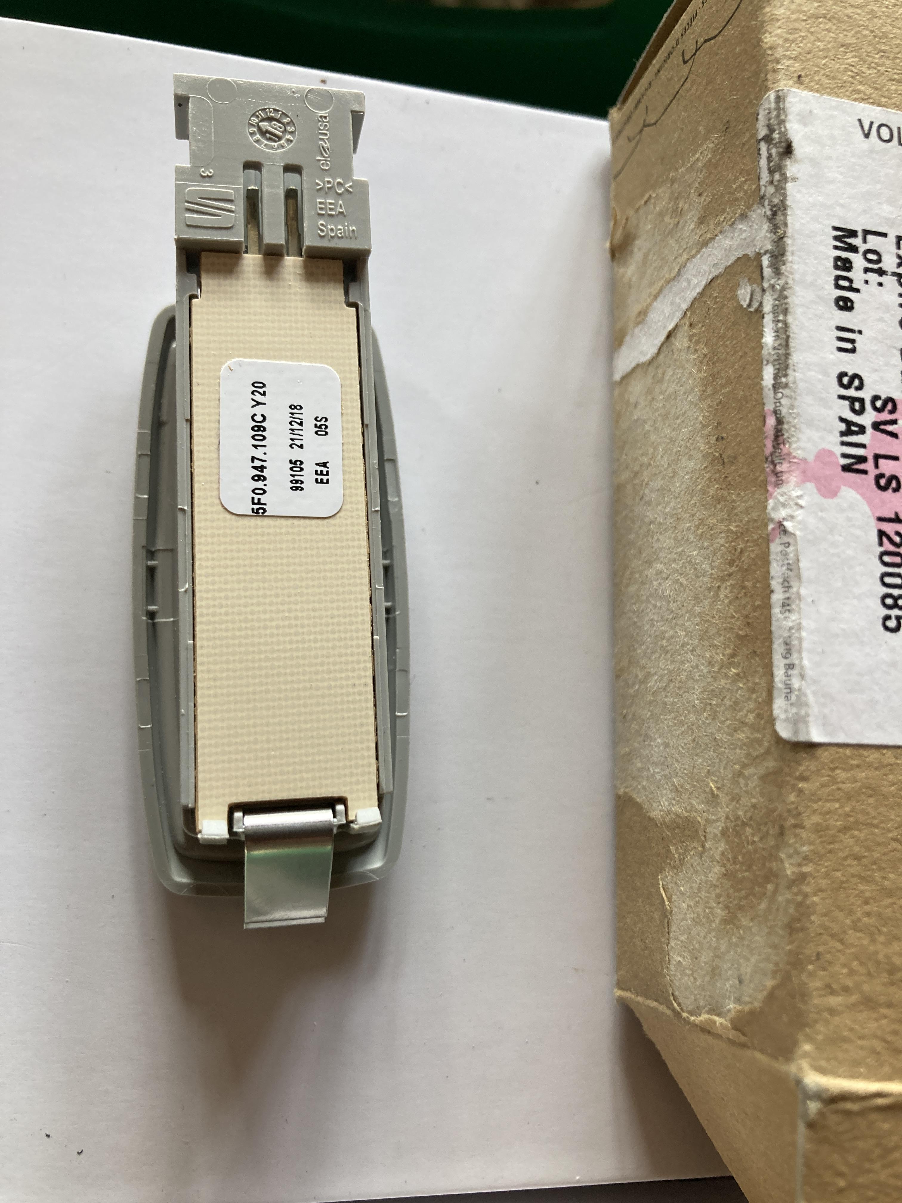

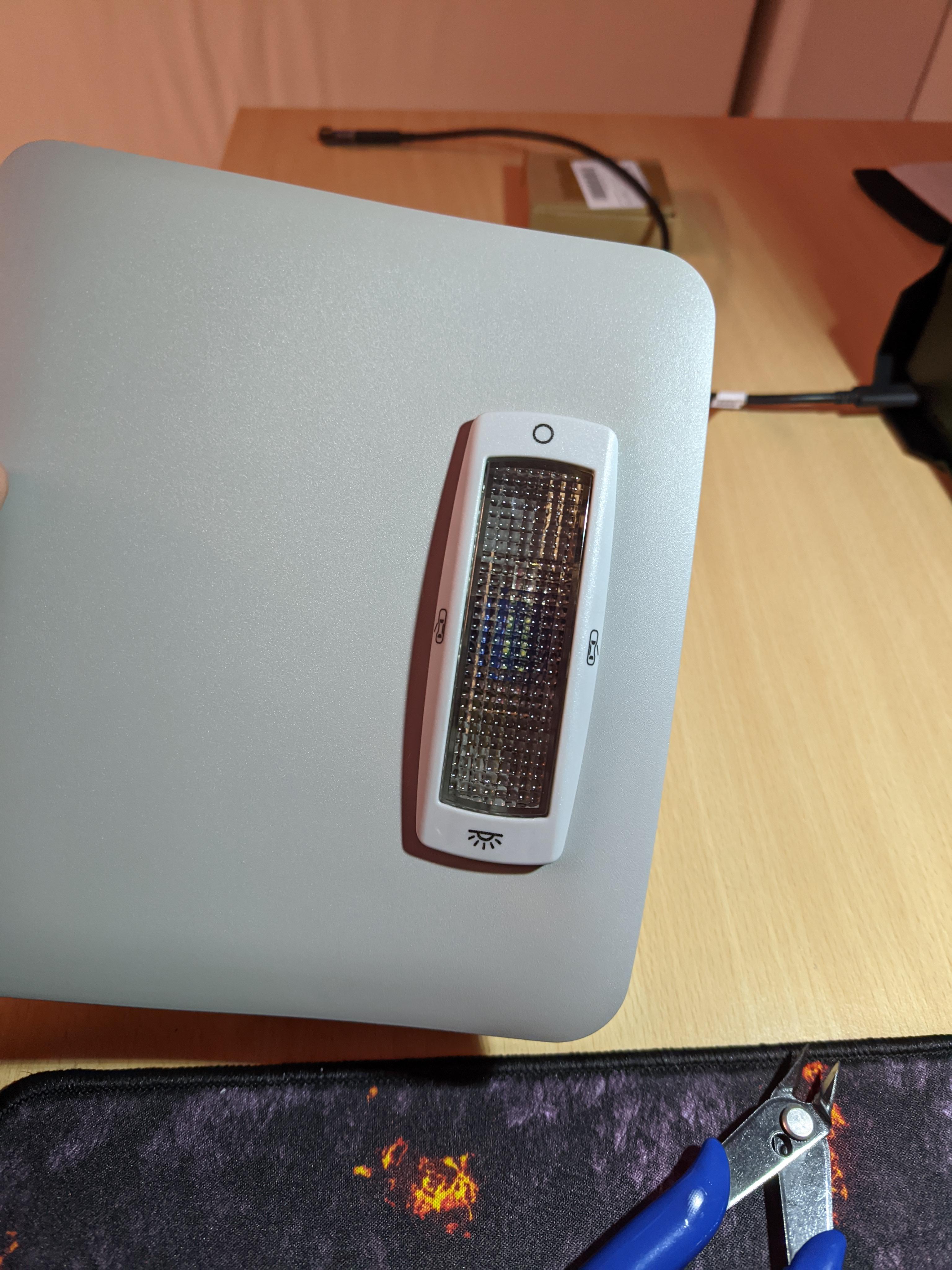

They are actually VW/Seat lamps.  I originally found one on eBay at £15 and it matched my white headliner perfectly.  I’ll find you a photo with part numbers.  The one above is another similar VW light but for my mate’s Cross with a black headliner.  They are both sunvisor vanity lights and have the right clip to hold it back into the headliner.

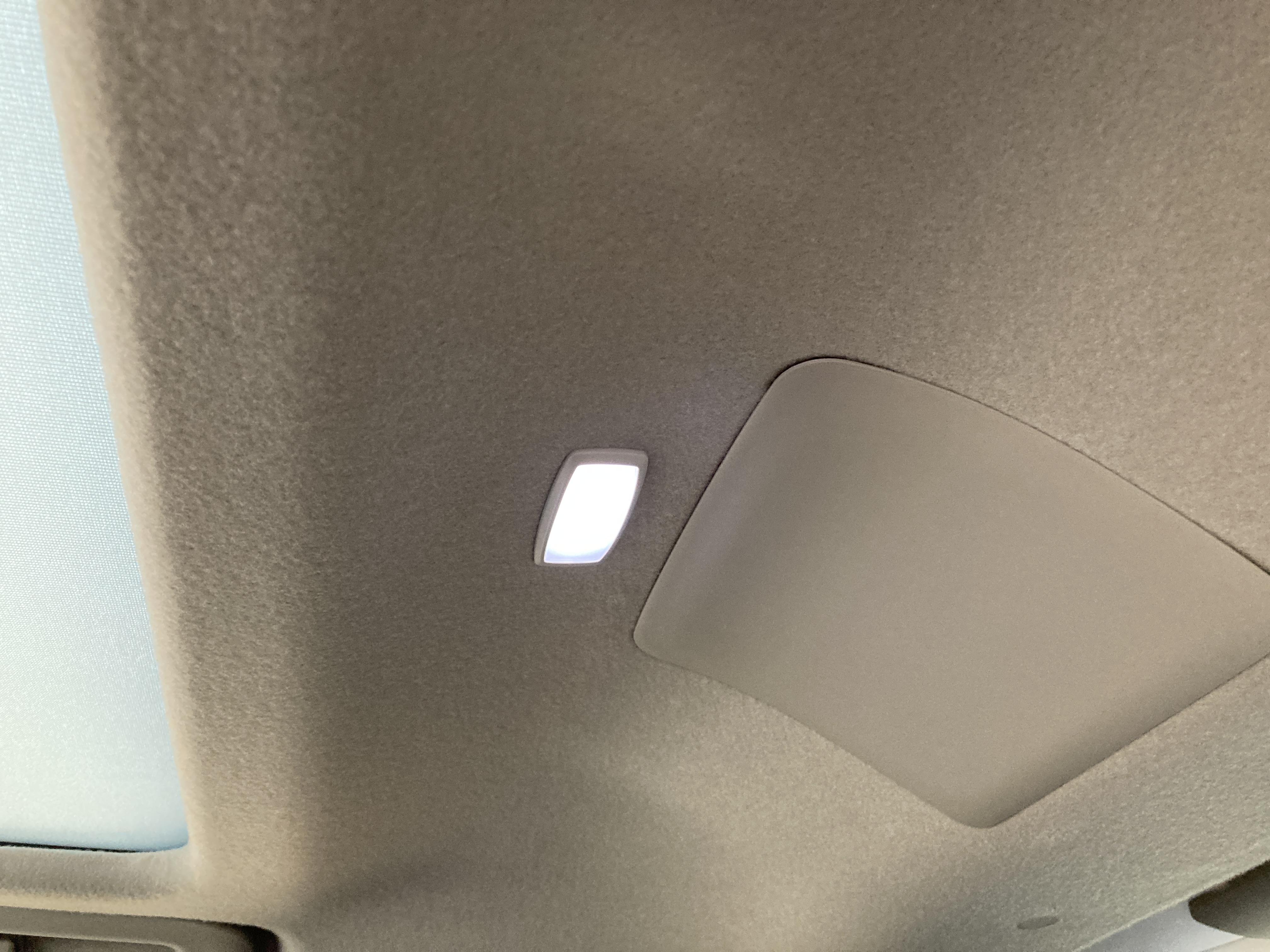

I have finished fitting my rear interior light,as per your instructions, perfect! Soldered a short tail to LH bulbholder using vaseline as flux. Then two connector blocks each end and job done. Cab is lit up now when I open the doors and fades off. Also LH switch operates rear light.

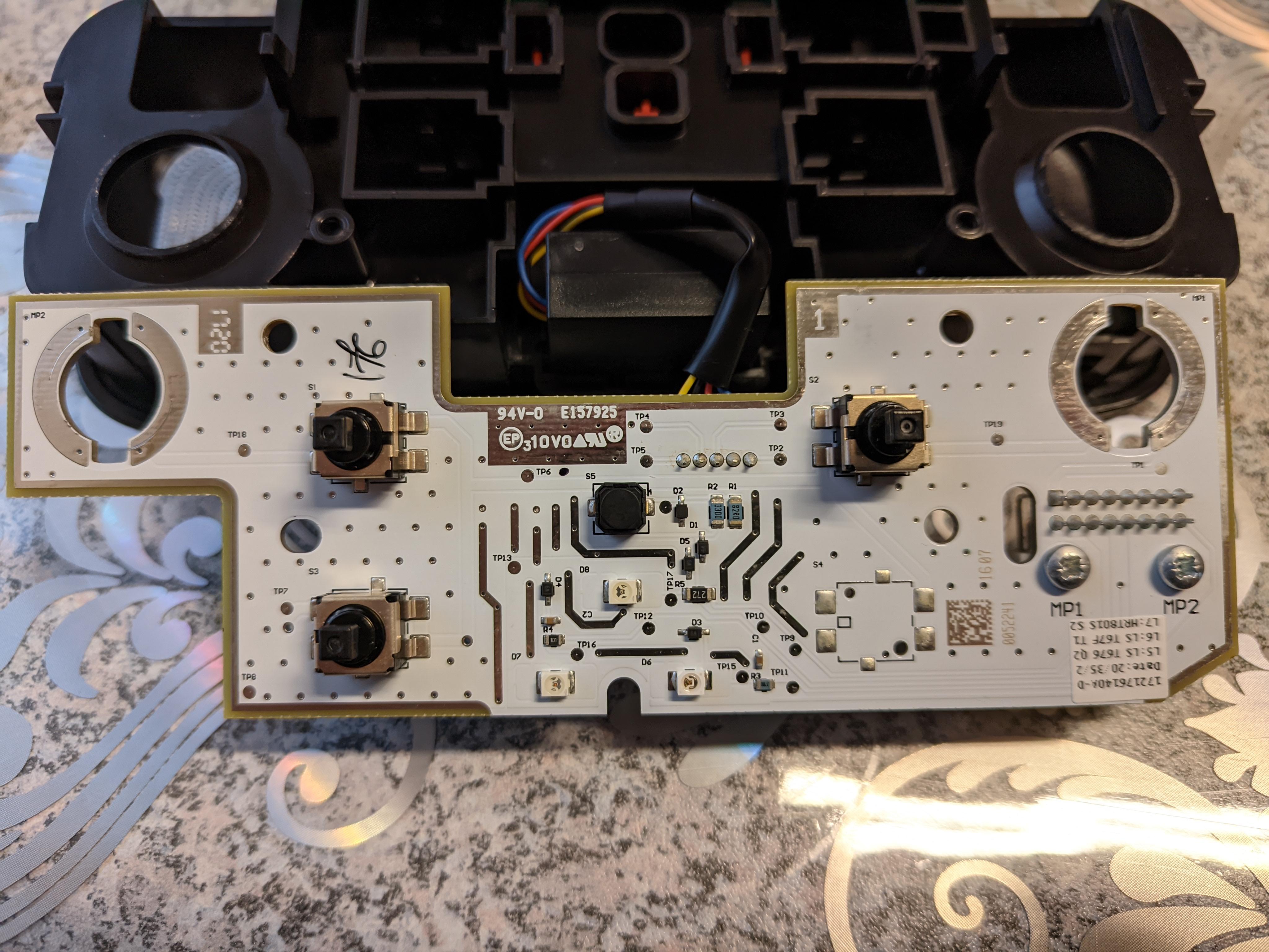

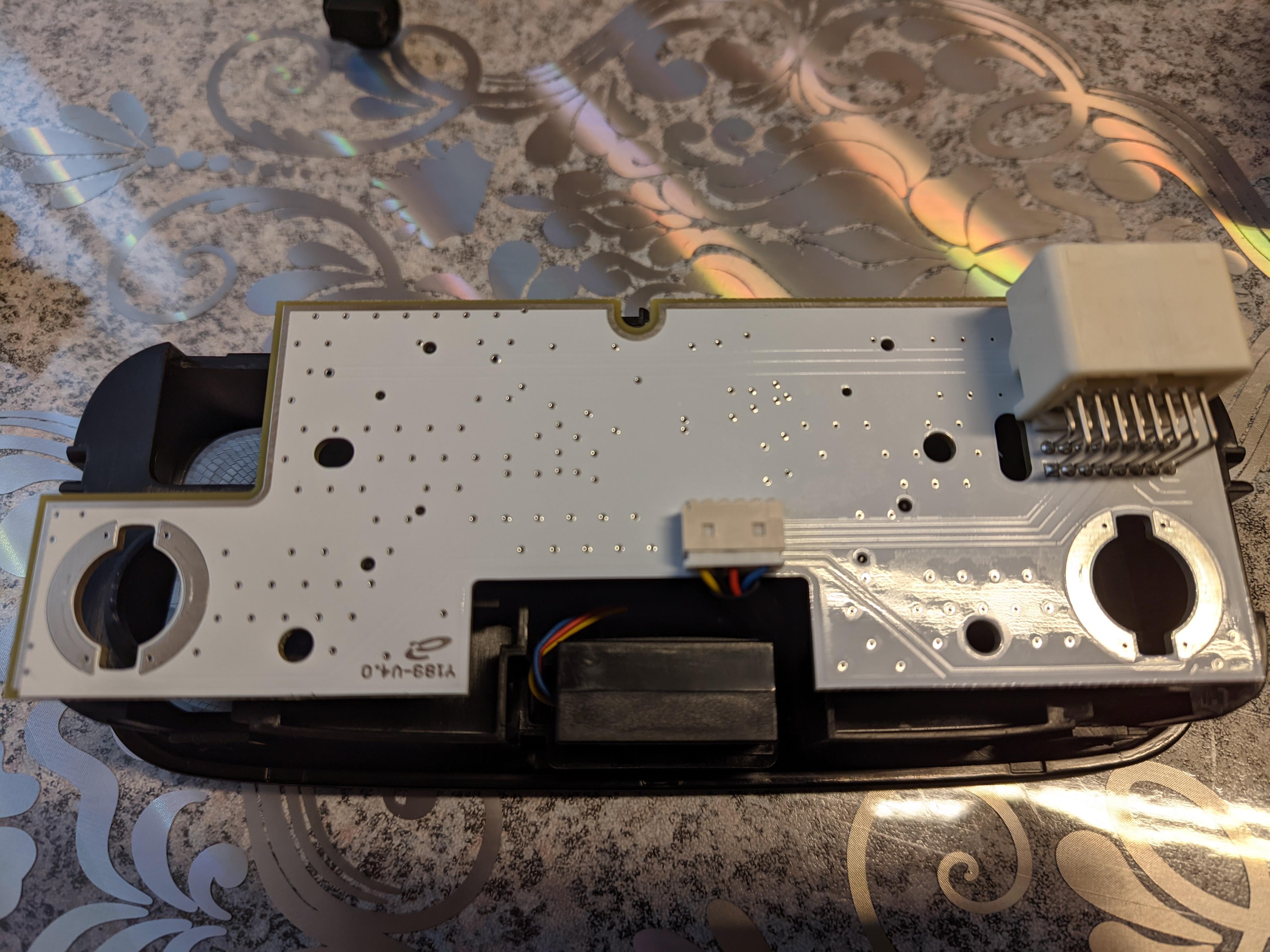

Did mine yesterday. I soldered 3 wires to the pcb where the plug connects. (Soldering not showed in pictures, forgot to take some...)
The light is independent from passenger and driver lights but still gets the door signal and can be switched off with the door button.

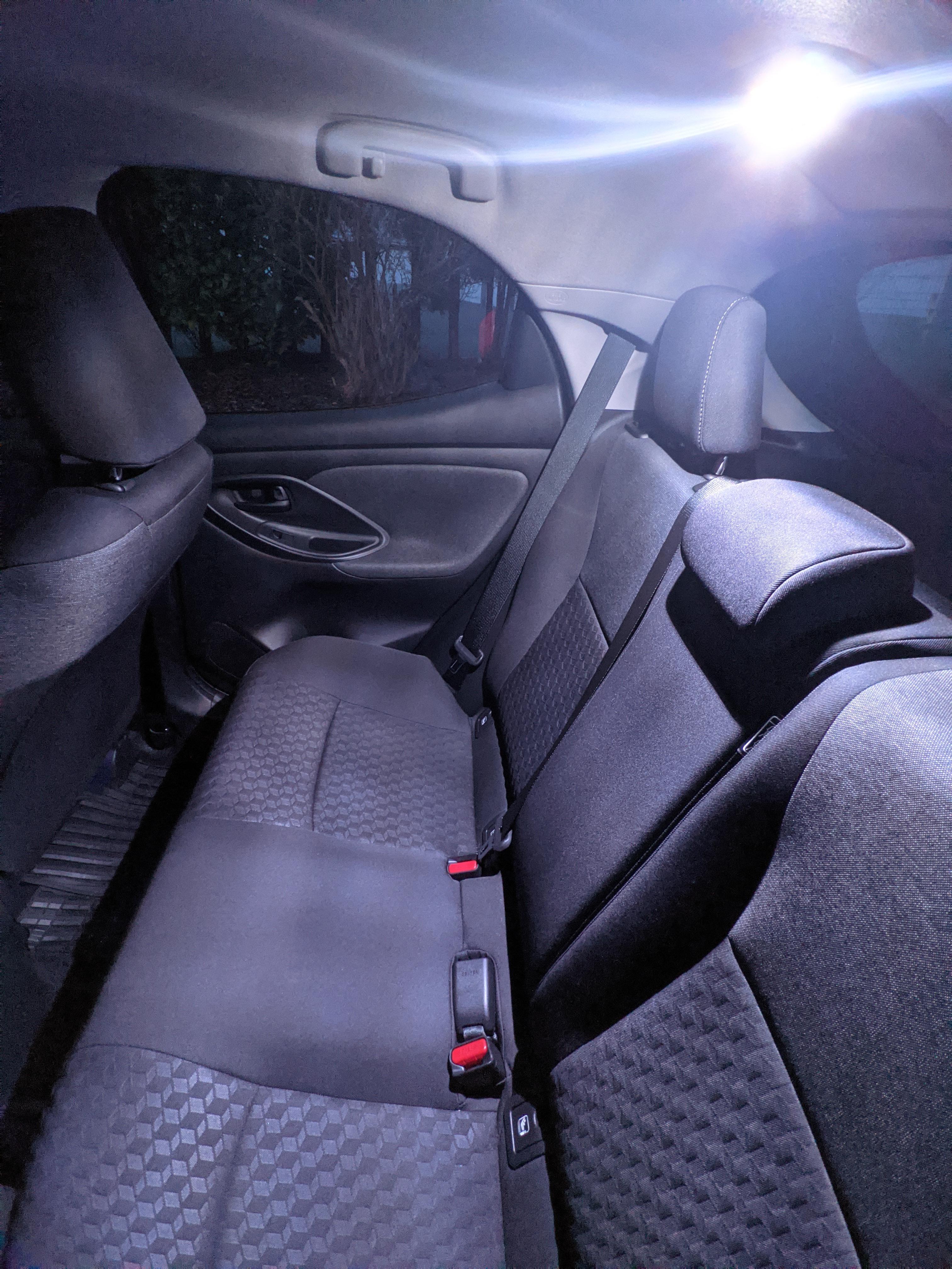

Does it light up the rear seats so the seatbelt buckles are visible? Or is this antenna panel too far to the rear?
I think it was well illuminated, but I'll check next time and let you know.
It will be fine there, you don’t need much light to see the seat belts.  I avoided soldering the PCB in case there was ever a warranty issue but there most likely won’t be.

Buckling up at night for example. With black upholstery, dark windows and without pano roof it's really dark back there.
Since I can't edit my previous post...
Yes it pretty much covers everything in that position!
