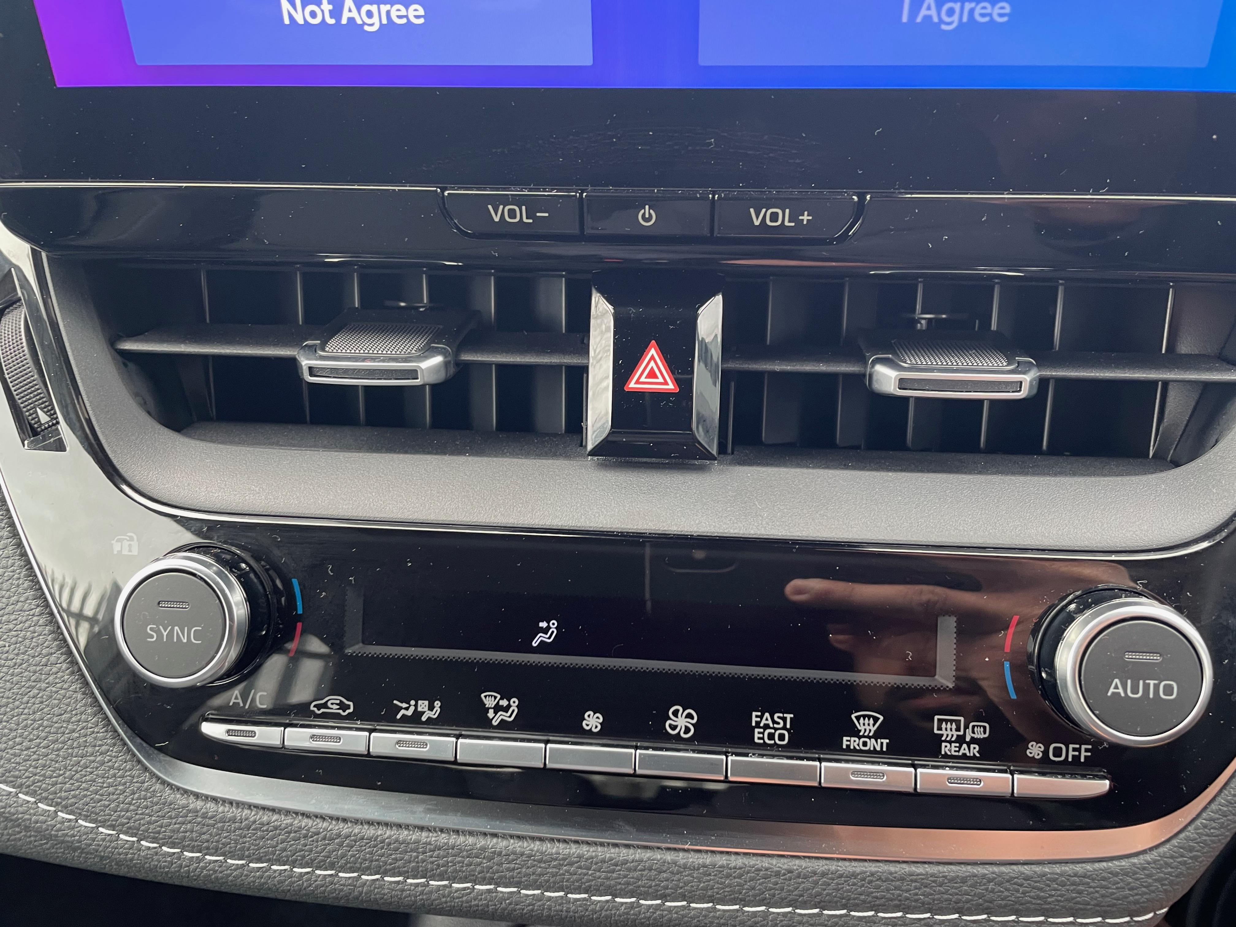

I'm a new Toyota owner here and have recently got a new 2023 Toyota Corolla 1.8 hybrid excel.

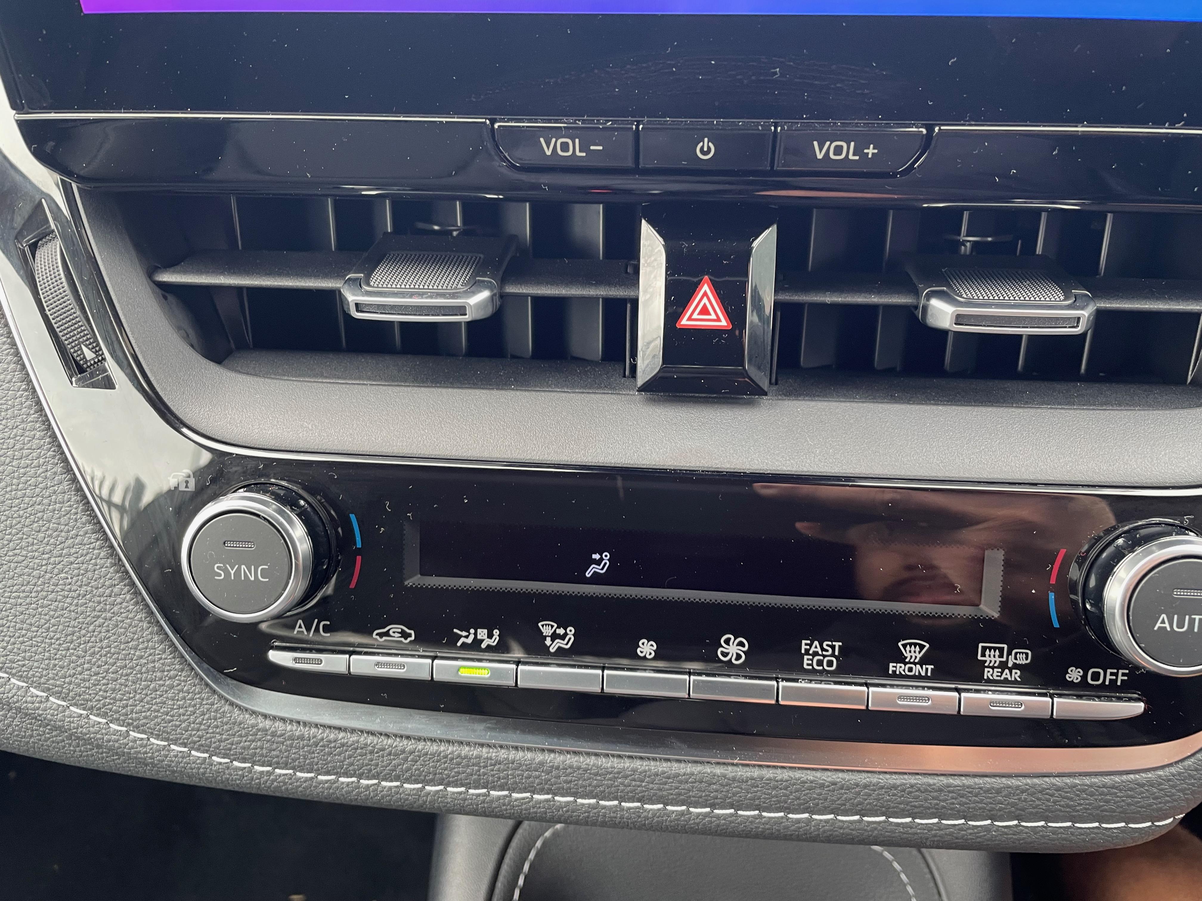

Ever since i bought the car, around 6 months ago, I've noticed that the air conditioning always seem to switch on automatically every time i switch the car on with the green light switched on (first photo).  Even when I switch it off with the green light off, the white symbol is still showing (second photo) and I can still feel gentle hot air blowing through the air conditioning vents. I can't seem to find anyway to switch this off completely so no symbol is showing and no air is coming out through the vents.
In the winter months it isn't too much of an issue but just thinking ahead to the summer as the weather starts warming up it will unnecessarily warm up the cabin of the car and also may be hampering my fuel economy.
I wanted to ask is this normal?
Or is this some sort of software glitch or problem with my car?
Thanks in advance!

John,
what you have described in your opening post is normal.  when you press Off the AC is not on and the fan is not on.  The symbol you see just shows the vent that was being used when you switched off, and it remains open even though the heating / ventilation is not working.  When you drive you then get a natural flow of air through the car, in through the grill at the base of the windscreen, into the car through the vent that is open and then out of the back of the car.  The air may feel warm because it still passes through the heater matrix.
