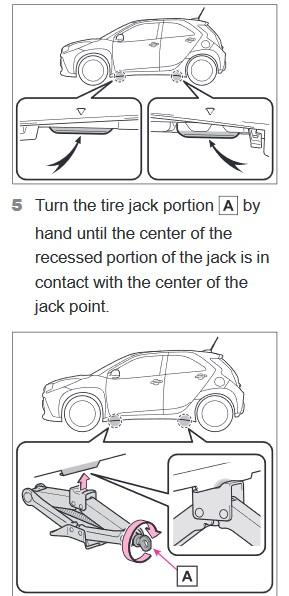

Nah its the jacking points as per the manual page 329-330
