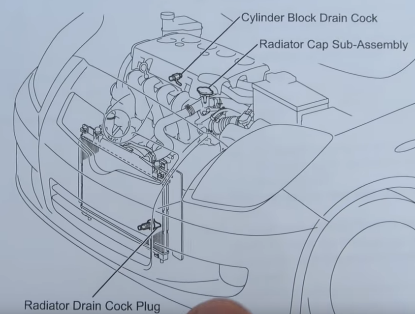

Hi Peter, Not sure if this will help,the video shows the position of the coolant drain, however its not Uk but it may help to indicate a similar location on yours, its worth a look. :smile:
I've always drained the coolant from the radiator plug. I didn't think there was a cylinder block coolant drain on this engine and I've never noticed one. Other models have one in the location shown below.

The reason for asking is that I have searched around the engine block for a drain, more than once, and as Ray suspects there might not be one - I wonder why?
The video is a 1NZ FE engine (marked on the intake) and it's backwards compared to the 1NR FE, i.e. the air intake is at the front.
