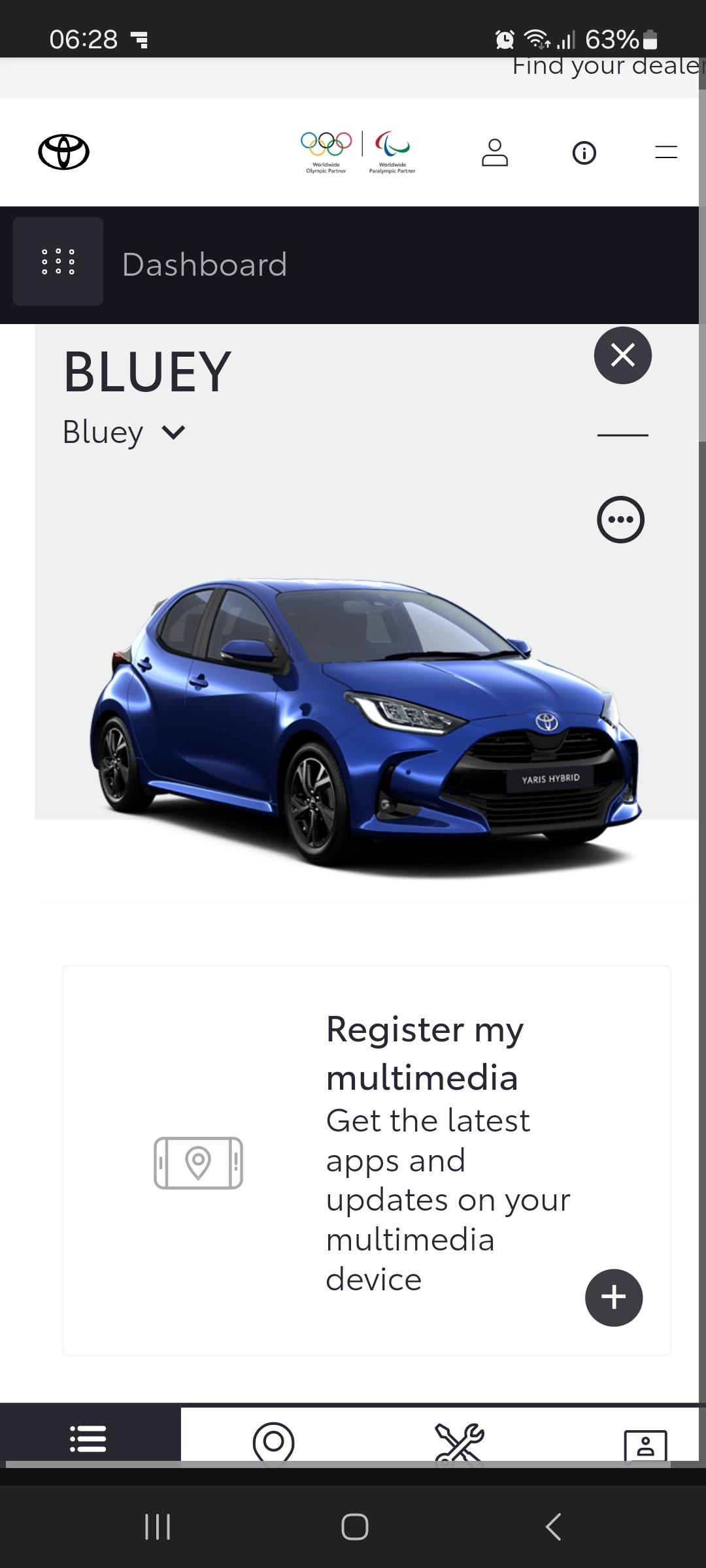

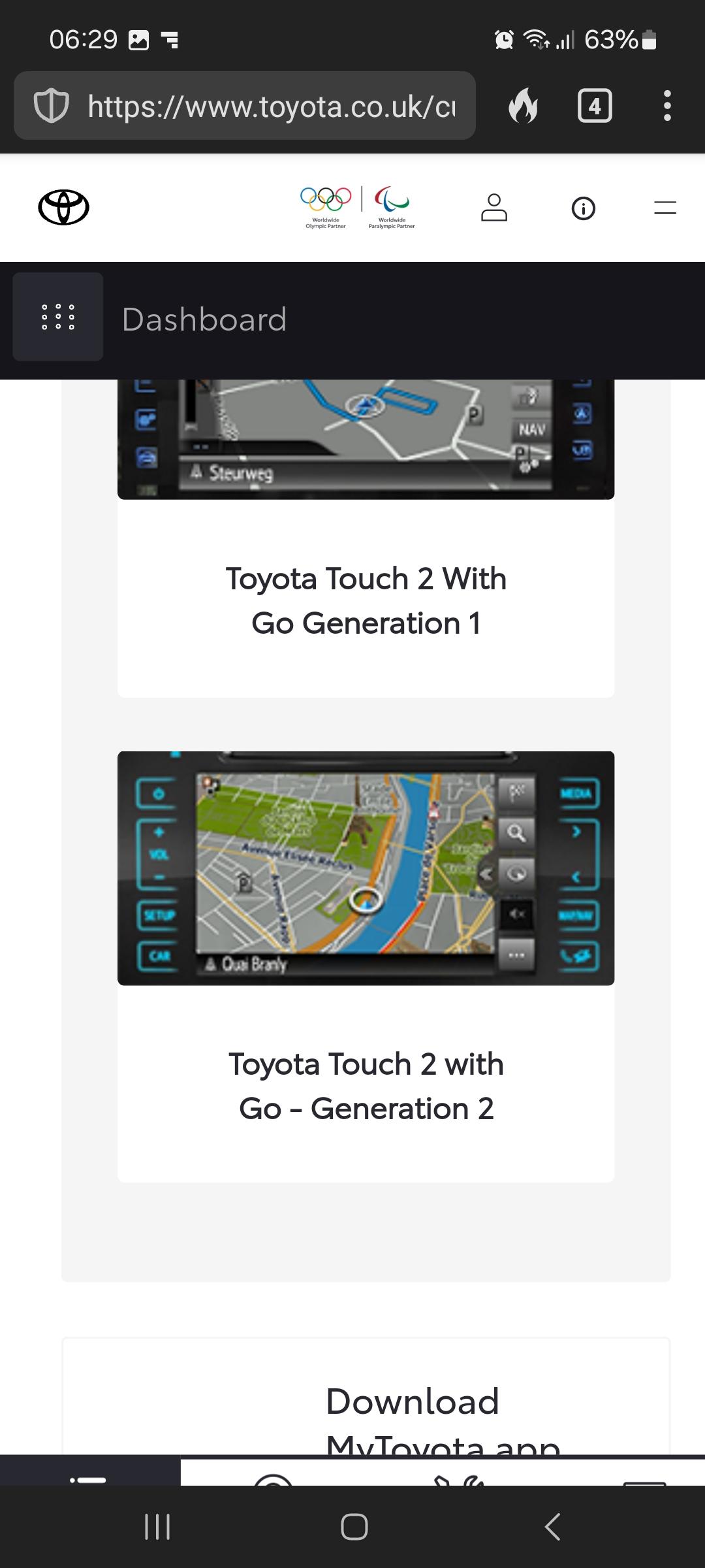

I have a similar query on a new Yaris Design I just picked up. I have registered the app and it has bonded to the car (shows status etc). However, the "Link Multimedia" option doesn't do anything when tapped?
Also, on the MyToyota website portal where it gives an option to "Register my multimedia", it doesn't show the option for Touch3, which the latest Yaris has. Are these issues related? I can connect to Android Auto via bluetooth OK, but am I missing out on any functionality by not "Registering"/"Linking" multimedia? Otherwise I am not sure why these link/register options are there if it connects via bluetooth anyway?
