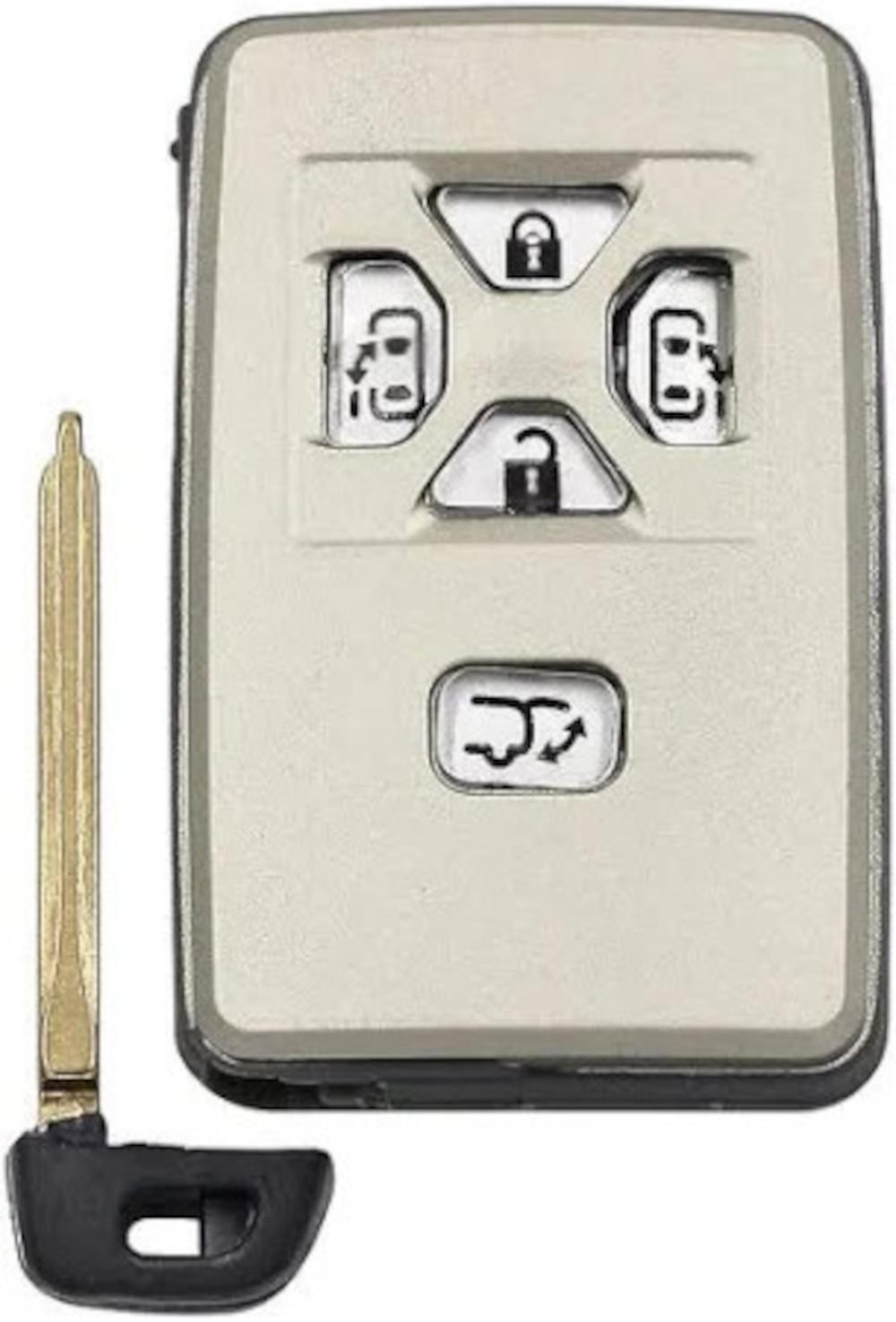

I have a 66 Plate Estima Petrol with only one key fob. I have a second un-programmes fob. Anyone know how I can get it proggrammed without de-activating the first fob?

Hi Mike, You can try this method as I have read that it works on a number of Toyota models. If not then you will have to get ot programmed by a Toyota dealer or a good locksmith.

Not sure if the Petrol model has an ignition barrel? Hybrid only has a Start button, and need to use TechStream or similar to program it (programs the Estima to accept that unique additional key in addition to any existing registered key  ie doesnt actually program the key itself).
Their are some people who can do it, for a reasonable (but still significant) fee.

Thanks, Stephen. Makes sense. My Estima does'nt have a key barrell. I've been warned about the risk of de-programmng the existing fob. Cost has to be less than not having any.

Hi Mike,well it does help if you have a key:smile: it seems a dealer or techstream to do this. You could try phoning around a few locksmiths on the off chance they have the software to program the fob:smile:.
I had a second fob programmed and the key cut by a mobile locksmith. He also supplied and cut a second key for my wife's Aygo recently. I think programming only was about £90
