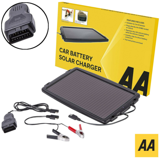

Just a bit late to the thread, but I have one of the pictured AA solar panels, and at the moment it's taking the Battery up to 12.6v or thereabouts at the end of the day, and certainly not discharging it overnight. It's a tad feeble in the winter with shorter days and less bright daylight generally, but it got into it's stride at the end of March and it's improving every day. The car is facing North West and doesn't get direct sunlight on the panel until late afternoon. It's reassuring knowing that the car will probably start without problems.
