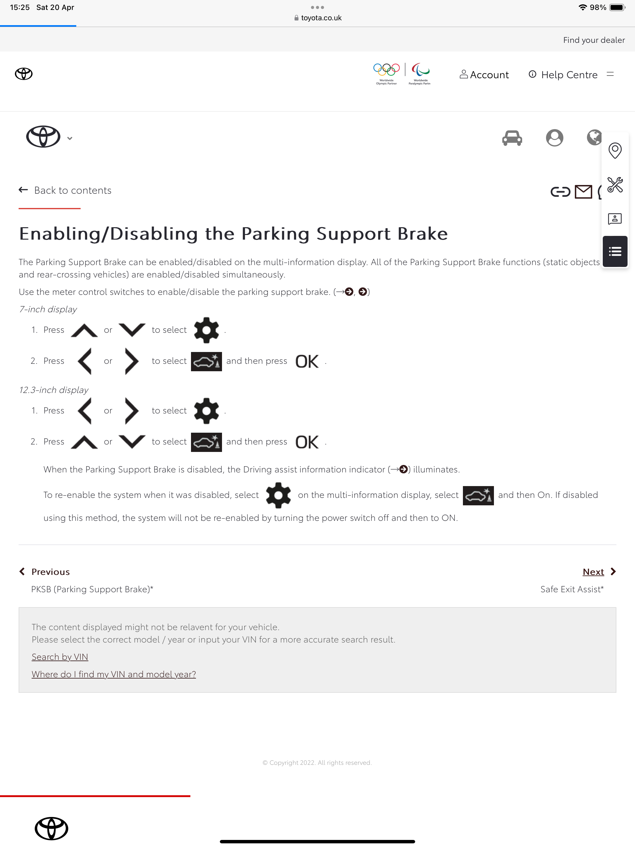

For what it's worth I have a Lexus RX450h which has a towbar. In settings, I have to disabled ICS, intelligent collision sonar. The car is unable to detect the towbar / trailer is fitted and an anti-collision system kicks in. That was factory fitted towbar.
Hope the above helps.
I had this problem too, alas there is a setting to disable some safety feature, which allows you to reverse, if I recall it’s about 3 presses on the steering wheel buttons.
Unfortunately can’t remember exactly what as to be disabled been a while since I’ve towed.

Many thanks for all your replies. It certainly looks as though the problems can be solved fairly easily. I have written to the  UK dealer but will probably contact the local Toyota agent here in France.

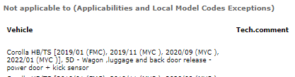

There are certainly some models where the kick sensor function does not work, it would be determined by VIN  number. I had this very issue where an engine plant worker needed this function, but on their specific model, they could not have it
When I ordered mine last year it was not possible to add the tow bar to the factory order for an Excel TS, which I eventually worked out was because the Excel comes with the kick sensor which is basically an antenna mounted to a frame behind the bumper that gets in the way of the hitch. The dealer said they could order the tow bar separately and do a dealer fit, but I would lose the kick function. However, I located a copy of the Toyota installation manual for the tow bar which explained how to hack out part of the kick sensor frame to allow it to be kept.
My guess is it’s always been this way, but perhaps not widely known. The installation instructions do say you might lose some sensitivity, presumably, because there is a massive lump of metal absorbing the signal from the antenna, but it works well for me once I got the knack.
