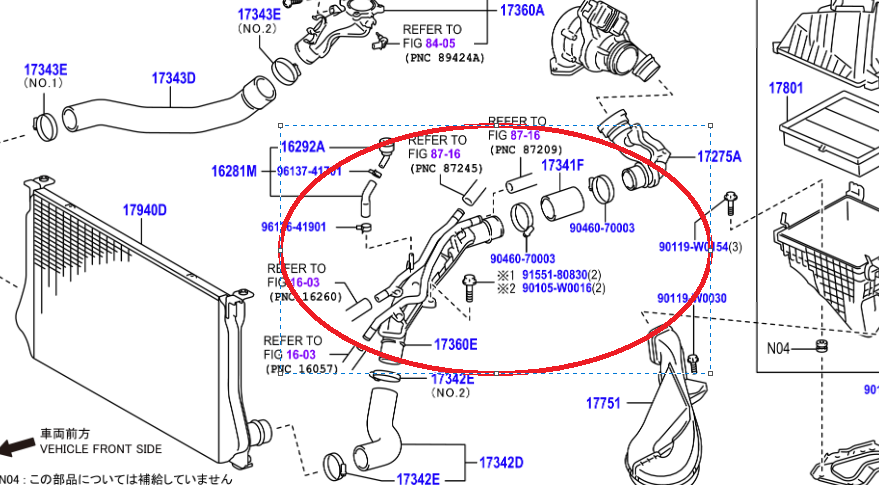

Not sure if entirely relevant to your case, but the intercooler hoses on the 1WW engine are very susceptible to cracking/breaking anywhere in the red boxed area, worth looking at
