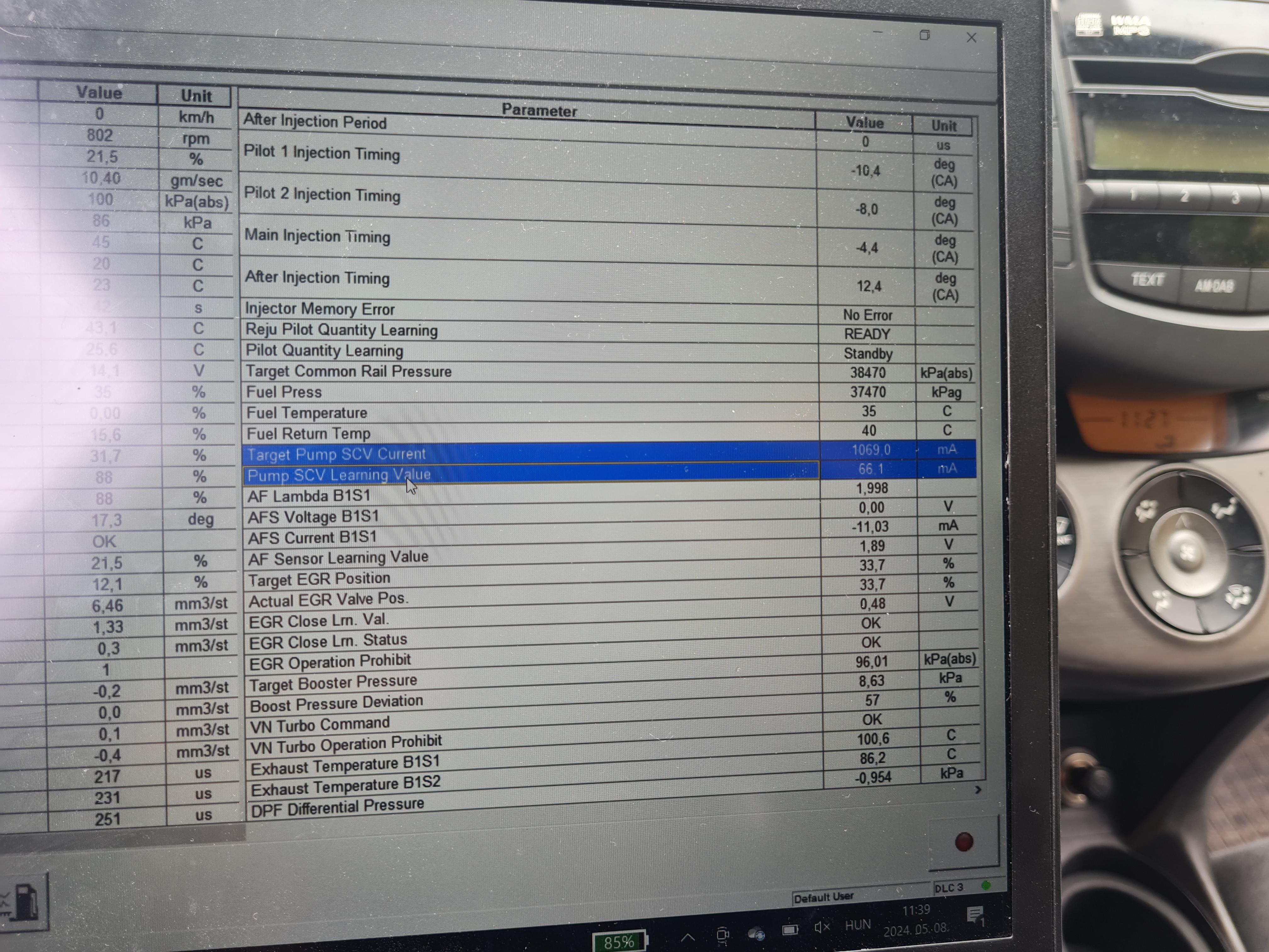

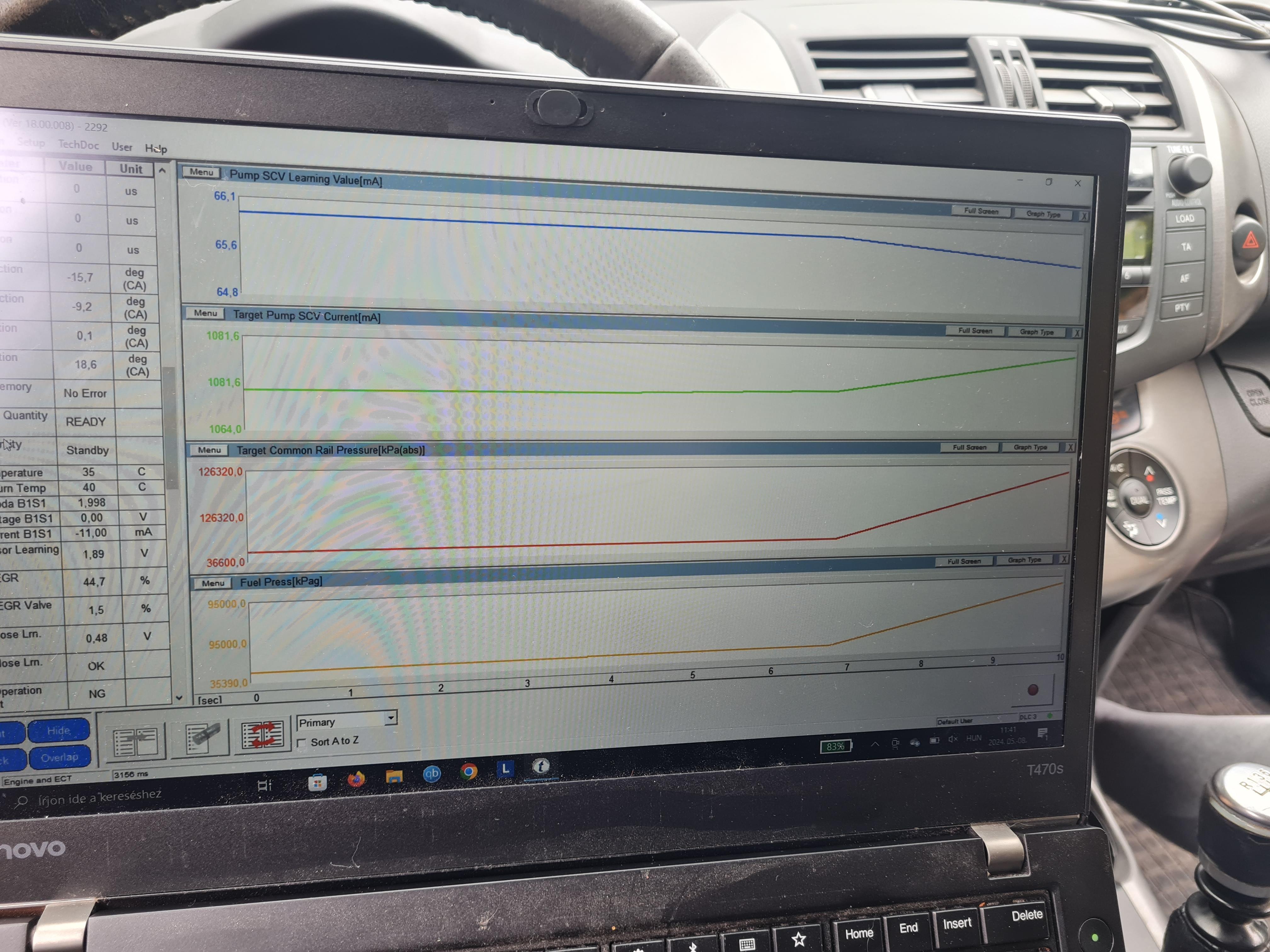

Hi Everyone,
I am a new member.
I'd like to ask your help.
