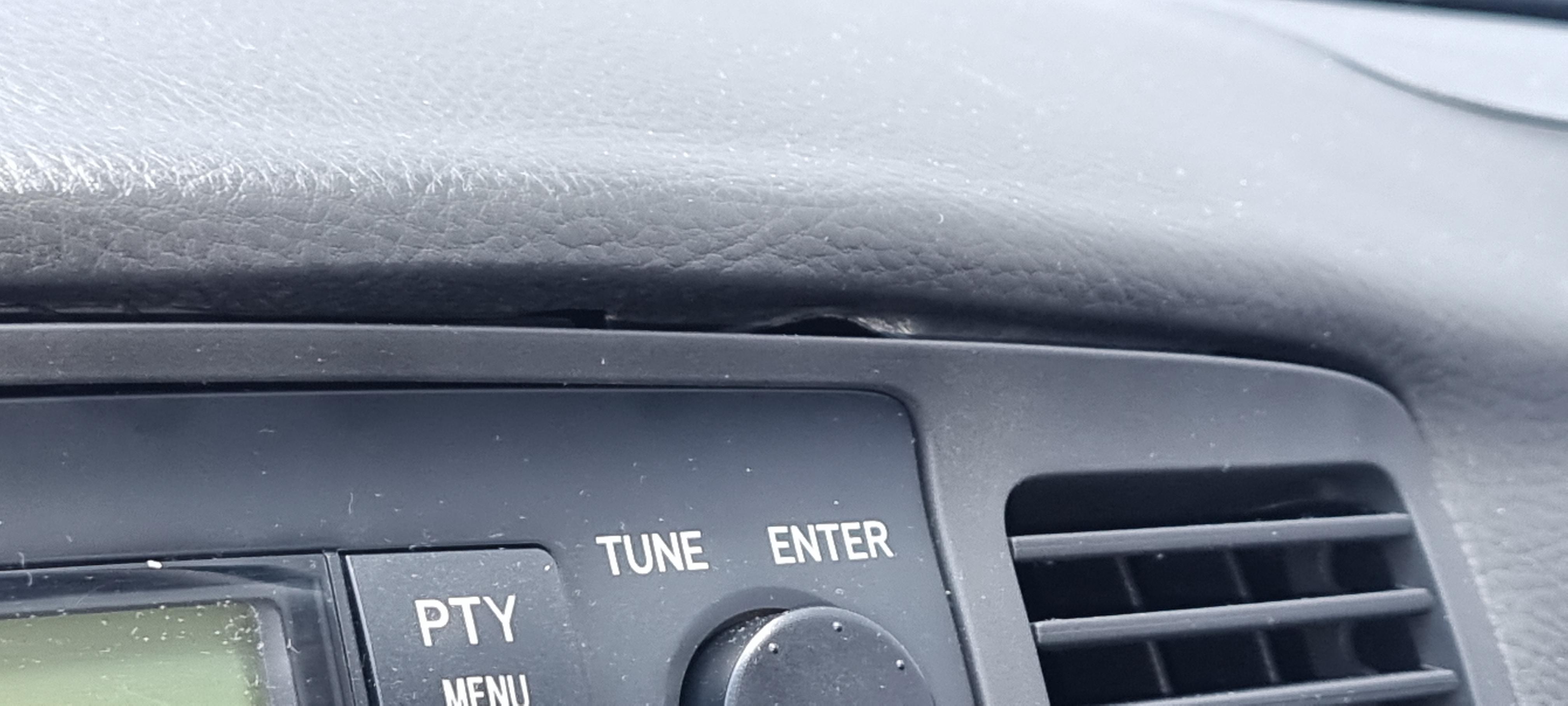

Just want to ask if this is a problem that all new (E12) Corolla's suffer?
I had my dash replaced two weeks ago and again it has appeared - this time even worse :( !

this is a common fault, basically you cant take out the radio without the gap appearing when you put it back in, fortunately there are two fixes that your local toyota can do for you under warranty, one involves bending the bottom mounts and cutting a little bit of the dash away, which worked wonders on the girl at works car, and the other involves a modified dash, presumably thats what you had done, best talk to toyota

Sorry should have made myself clear - I took it to Mr T to get the work done under warranty two weeks ago. They shaved the back but it still wasn't right so they ordered in a new dash and fitted it, but this one has gone exaclty the same.

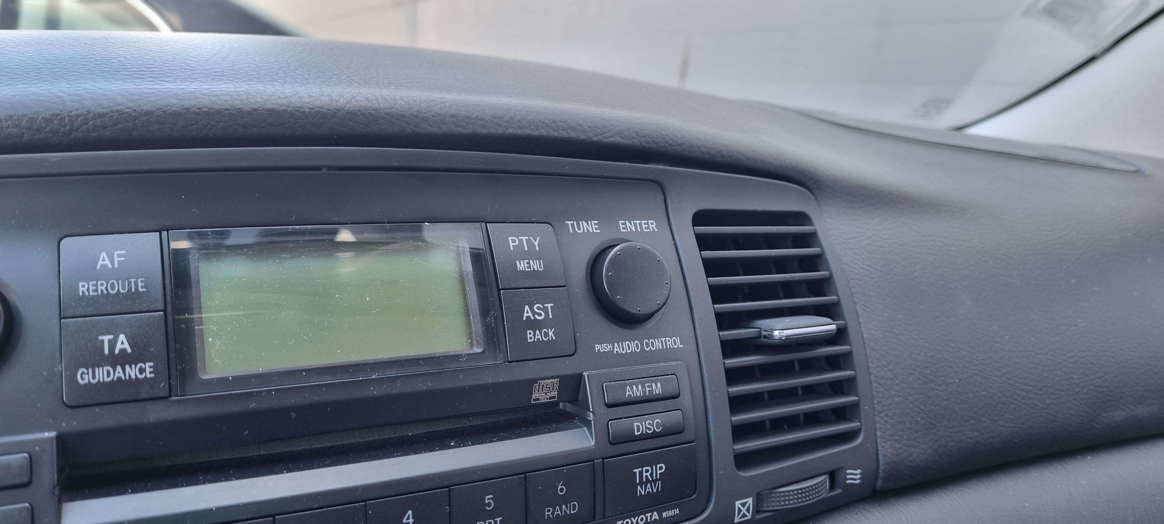

in that case maybe try, removing the radio
remove the ashtray, pull of the gear surround then there may be a couple of screws at the bottom of the centre console (but i'm not sure), remove these if they are there and then pull of the centre console, you should now see 4 bolts under the radio unit, take these out (carefully they have a habit of falling), and remove the radio, (i apoligise if you already know how to remove the radio, but i thought i'd add it incase you didnt)
at this point try pushing it back in, it'll probably just have a huge gap still, but sometimes it can sit right, if not, bend back the metal tabs where the bolts go, but only very slightly, this is to raise the top when you fit it back in, then get a mate to apply a little pressure to the dash above the radio, as you push the radio in, it may take a few shots, or it may not even work, but it worked for me a couple of times

what spanner monkey said is partly true but i would suggest you loosen the four screws (they actually have hex heads) then nudge the radio up and then retighten.
*You will need a 1/4" socket set with an extension to do this as the bolts at the back are a ballache to do*.

It took 3 attempts for my local Mr.T to fix this problem on my 03 T3 recently.
They tried trimming the inside of the dash - failed.
They then replaced the top of the dash - failed.
They have now replaced the facia surrounding the radio (with the vents in it) and this appears to have worked (though there is still about a 1mm gap at the top right hand corner - I can live with that :thumbsup:
The dealership I used was not the one I bought the car from and as my warranty is due to expire in October, I cannot fault them for trying to fix it.
Insist they replace the facia as well and hopefully you will be sorted.
