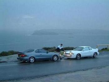

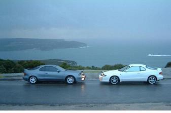

car looks sweet mate
Thanks dawsey ill get some more pictures of my car when it comes back from the shop. Ill take ones in good weather.
