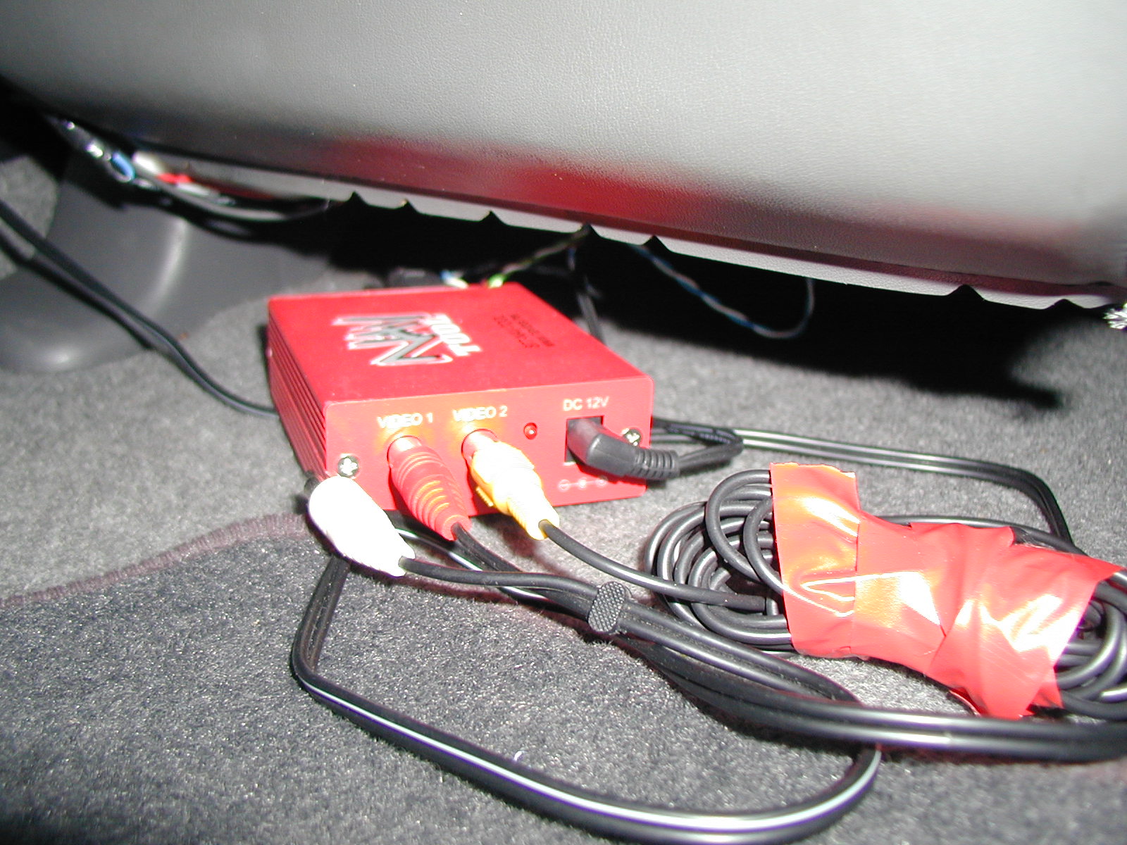

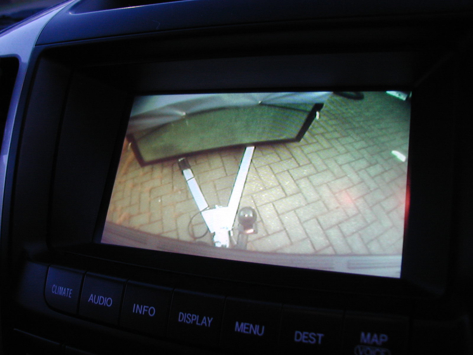

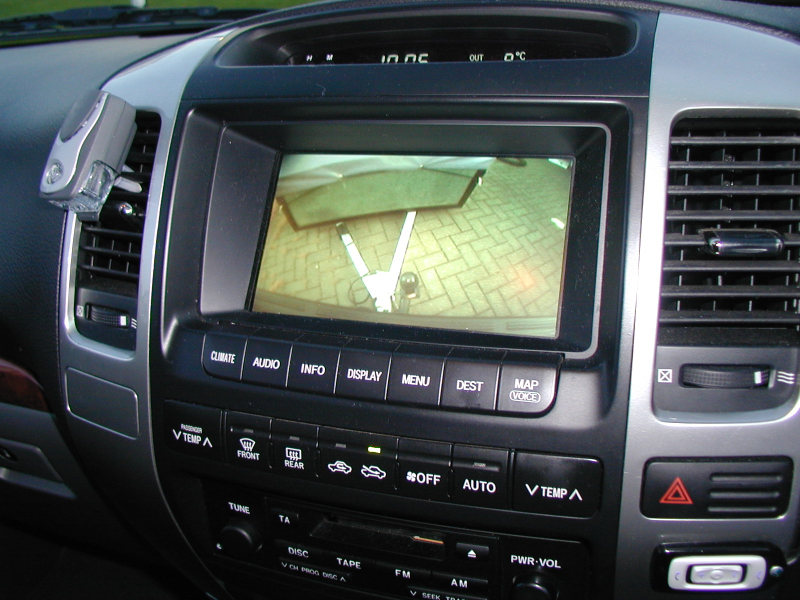

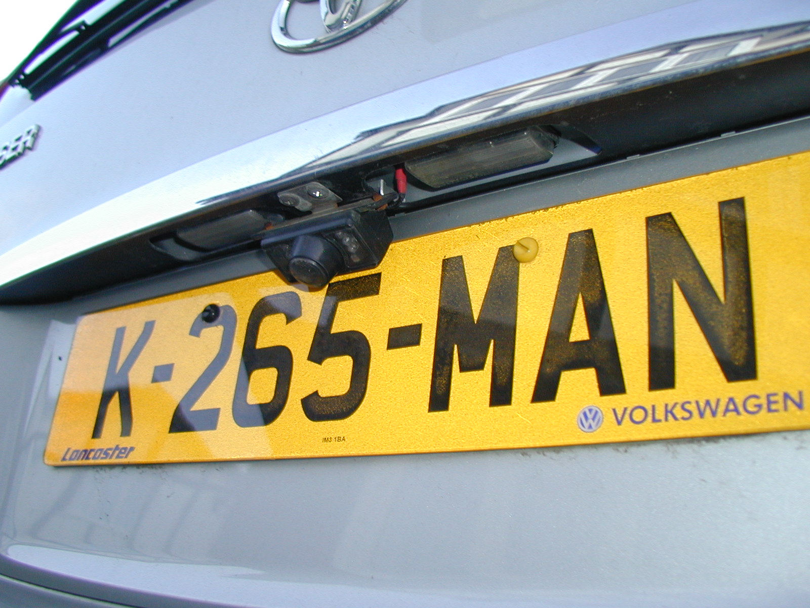

Hi,
I've fitted one to my LC5 and it works brilliantly.
Box of tricks from here:
Box of tricks
and the camera from here:
camera
You can have the camera pointing directly back or down (I've got mine going down for backing up to trailers)
I'll take some pics of mine later today and post them.
see http://www.kevminay.com/LC5.htm
Cheers, Kev. (Isle of Man)
