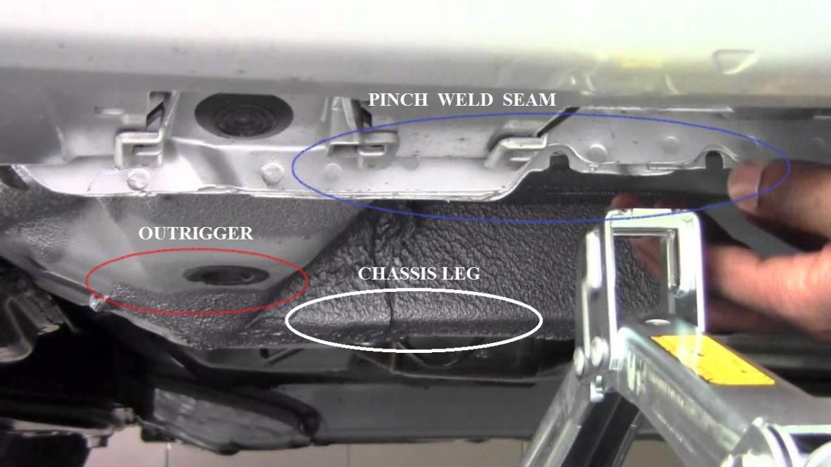

Yup, it's more complicated than it first appears. If you look at the fitting on the car scissor jack, it's designed to go around the pinch weld seam and lift the car by the reinforced floor sections. One trouble is the jack lifts straight up in a vertical line (although the fitting is riveted to the scissor arms, not welded) while the car body moves in an arc so there's an inherent instability in the geometry of the lifting apparatus. If you use a trolley jack from the side at least it can move outwards or inwards to better correspond with the car body position. Trouble with mine is the jack head doesn't come off otherwise I'd use one of those steel adapters you see advertised.
I made an adapter out of a block of white wood i had, faced off with two hardwood pads. I measured it carefully against the front jacking point, got it to fit OK and lifted the car a few times OK. Then when i used it in the rear jacking point same side, either the floor sections were higher up or the seam was deeper because the wooden adapter split in two.

Yes, but do you use a jacking point adaptor? Your trolley jack looks like mine ie the head of the jack is not removable. If you put it up against the pinch weld seam you will distort it, if you place it elsewhere around that area you risk causing the type of damage that tyre fitters cause. Or do you jack it up in the middle, putting the jack in from the front or the rear as Andrew says?
Nope, no adapter. I jack it on the beam or whatever it is called...
It isn't mine - found it with Google and downloaded it myself. :)
