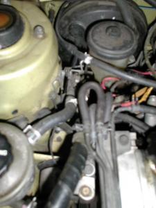

A few months after I fitted my 4E-FTE engine, I noticed that the car wasn't going past the LO cut off in either High or Low boost modes all the time
I isolated the boost solenoid as this seemed the most likely problem. I haven't reverted back yet!
Its simple to do, you just need a piece of high pressure hose of the right size (a local rubber supplier may give you a free bit if you ask nicely) and bypass the solenoid. It should be clear from the attached photo... Apologies for it being out of focus slightly.
It shouldn't overboost as that is controlled by the wastegate actuator not the electronic boost solenoid.
