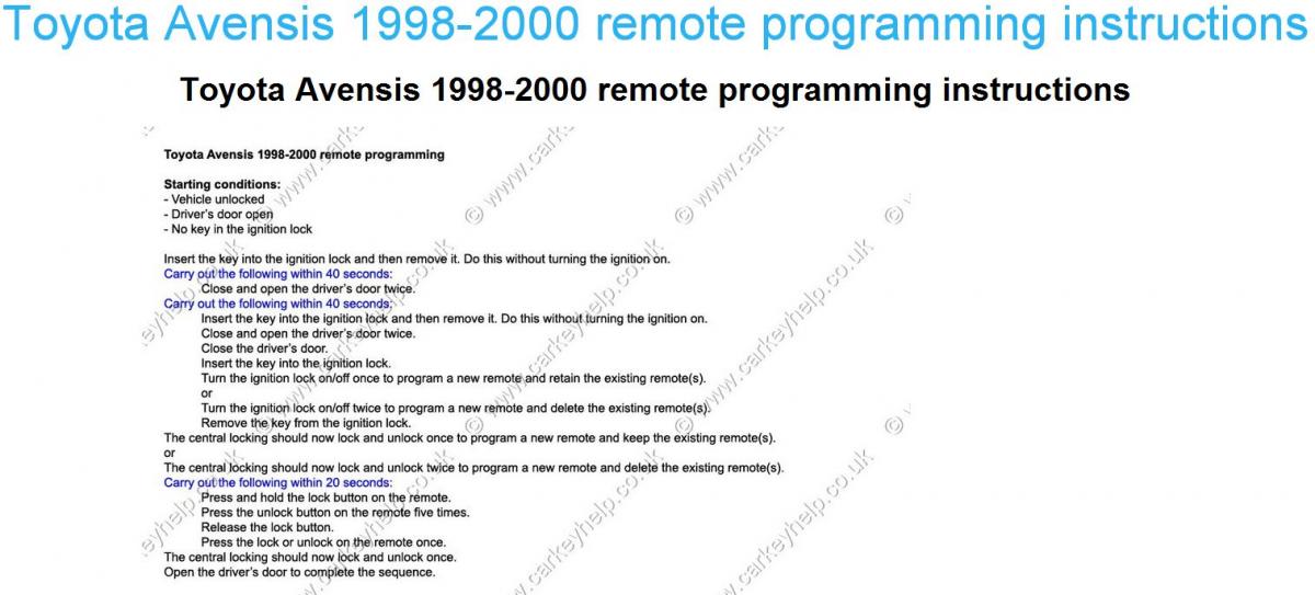

Interior light and door switch must be workin .start wit drivers door open insert/remove the key into ign twice dont turn .close /open door twice insert /remove key once close/open door twice finishin closed insert key turn ign to position three and back to off remove key press lock open buttons together for 1,5 secs then press lock .door locks shud then cycle once
UNBELIEVABLE!!! Reprogramming the key worked perfectly and without changing anything, nor the key nor the receiver! I simply added a new remote to the car with the following procedure:
post-120336-0-37484300-1335208751_thumb.
I would like to thank you man for your effort, time and for pointing me to that direction!
