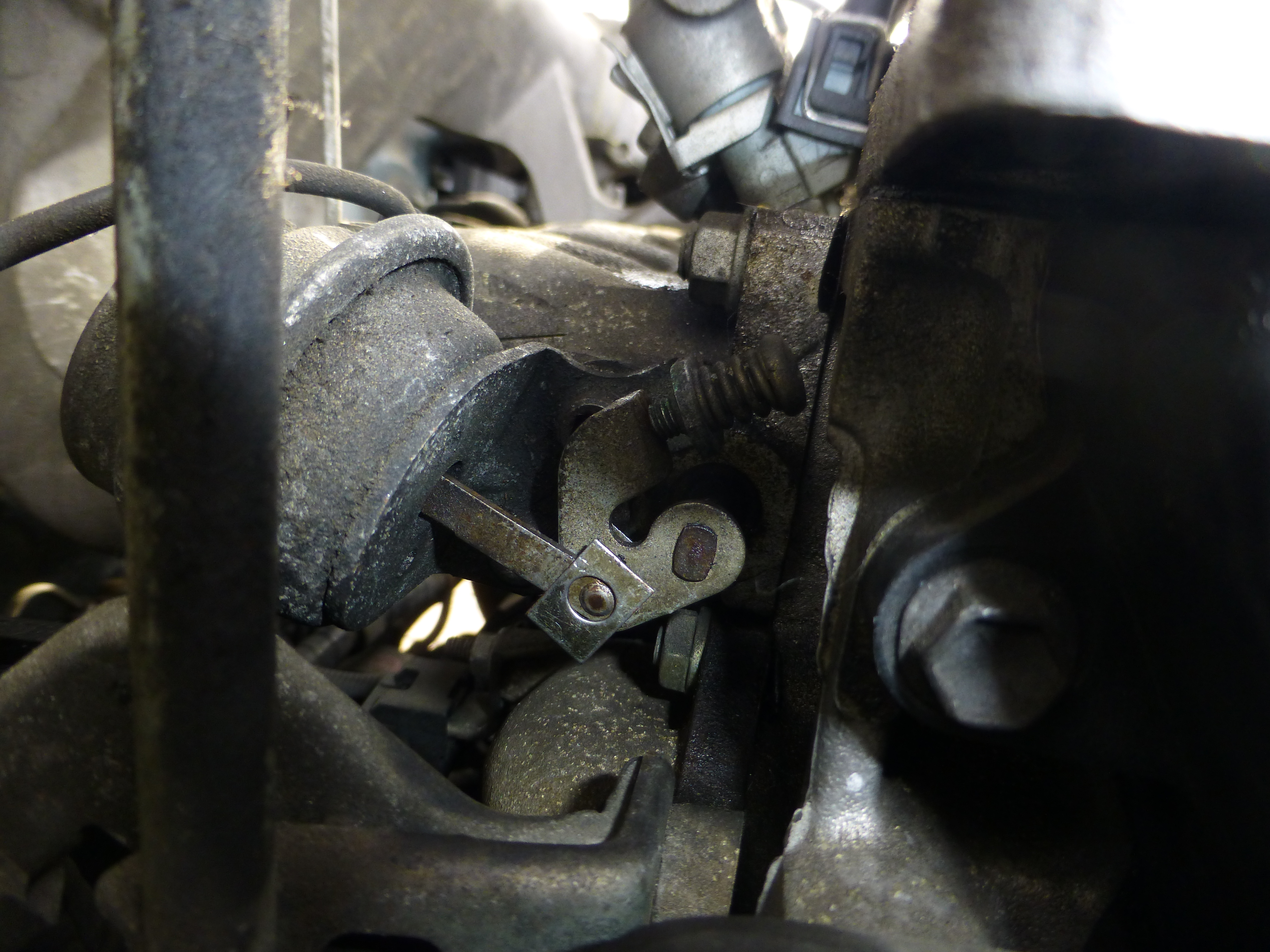

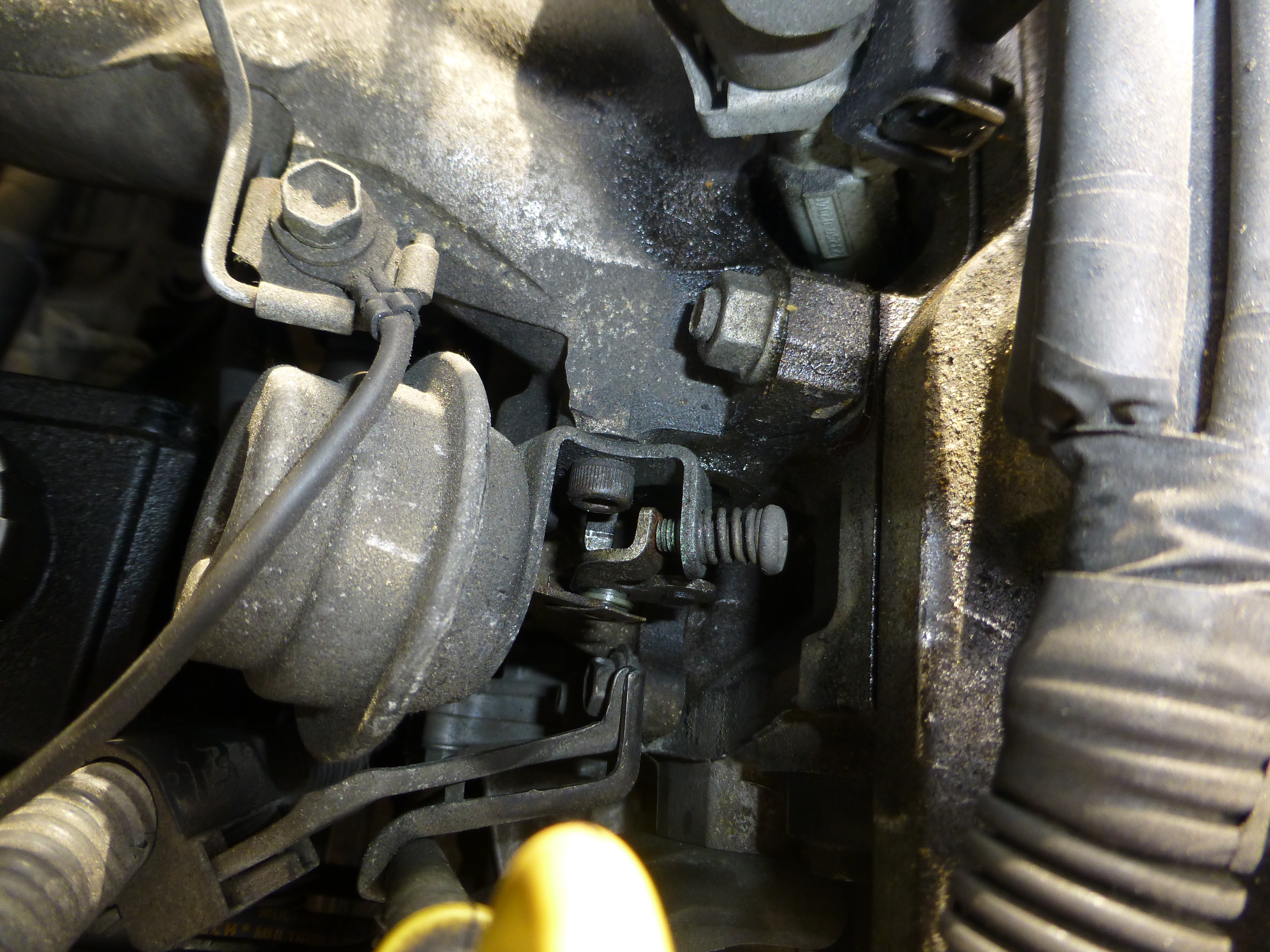

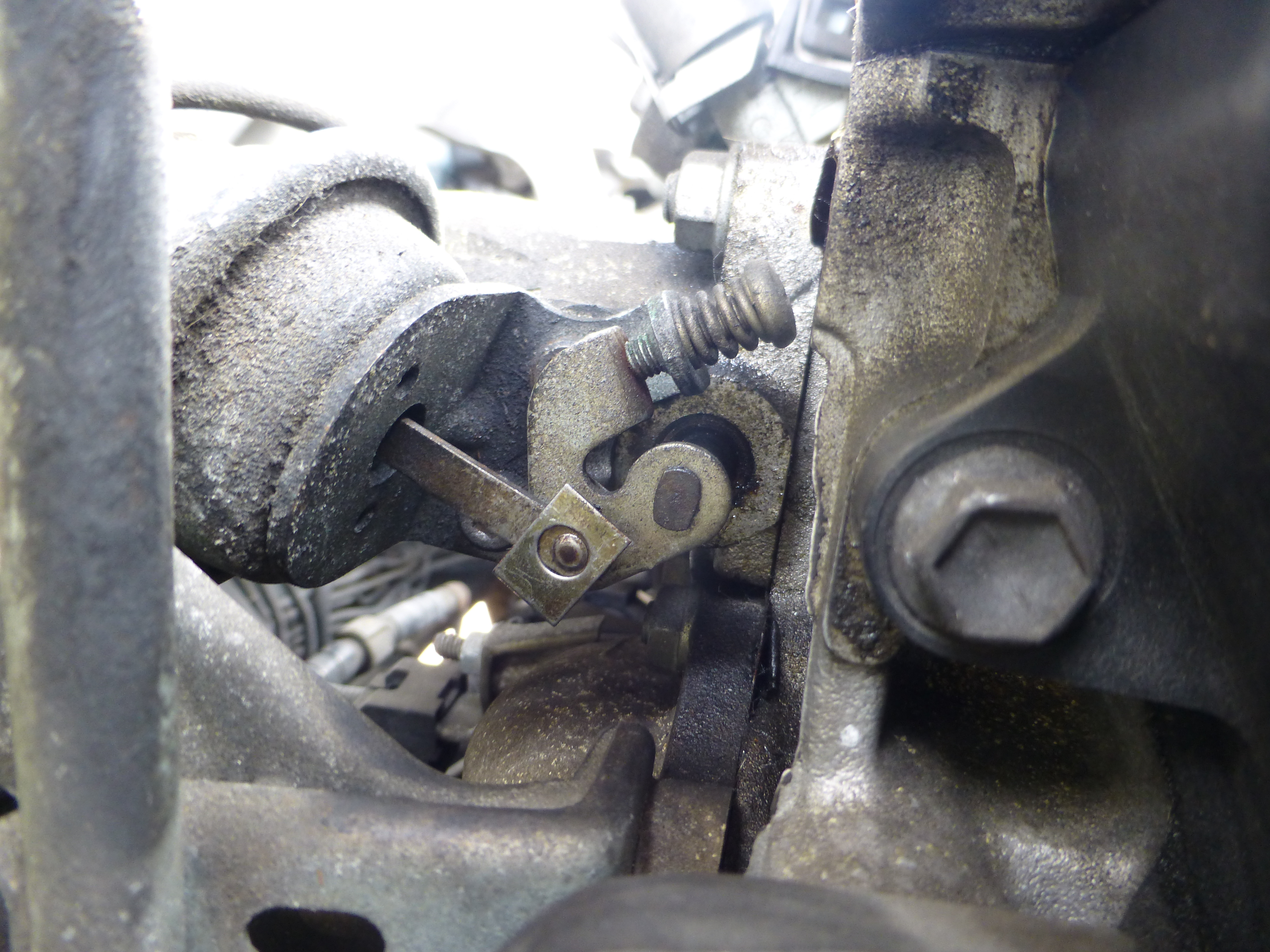

Is the vacuum switch pulling the lever to the inlet valves. To fix the problem, I pulled the hose off the vacuum switch, then moved the lever to the stop, held it there while reconnecting the hose. This was done with the engine off. When the engine is started, the vacuum will pull the lever to the right position. The pictures are after I set the lever position and when idling. It opens gradually when the throttle is pressed.

I hope this helps.

I forgot to add, that i changed the exhaust and catalyst , but it did not make any difference to the emissions. The vacuum fix above did.

If I was well ( got a cold), and still had my old 7AFE, I would take photos or make a video to demonstrate the procedure I used to set the vacuum. It is simple to do. Other checks i would do, is to make sure the leanburn sensor cable is routed safely between the cooling and air-con fans - mine got caught and damaged in the air-con fan when I switched it on. I repaired it, then later obtained a spare sensor. Even with spare catalytic converter (year old and new), and sensors the car struggled to pass. That is why I go back to the vacuum switch operating the inlet valves. See this post -

Hi Konrad, last night I found your earlier post (2014) ref the Vacuum switch. This morning when the engine was cold the lever was hard against the stop. I removed the hose and there was a very audible release of gas followed by me going Ooops. I held the lever against the stop, reconnected the hose, let go of the lever, the lever then moved away from the stop, started the engine, the lever now back against the stop, turned the engine off, lever still against stop, engine appears to be running normally. Unless anyone says different I have to assume the Vacuum switch is OK??

That's a good sign. The vacuum is holding. When the engine is running, when you rev the engine, the vacuum should move the lever from the stop. I previously made the mistake of detaching the hose when reattaching the level at the pivot. I did not notice the correct position until my emission problem occurred.

Message for Konrad, Revved the engine and the Vacuum arm was popping in and out, wasn't gradual just either in or out, seems ok to me.
