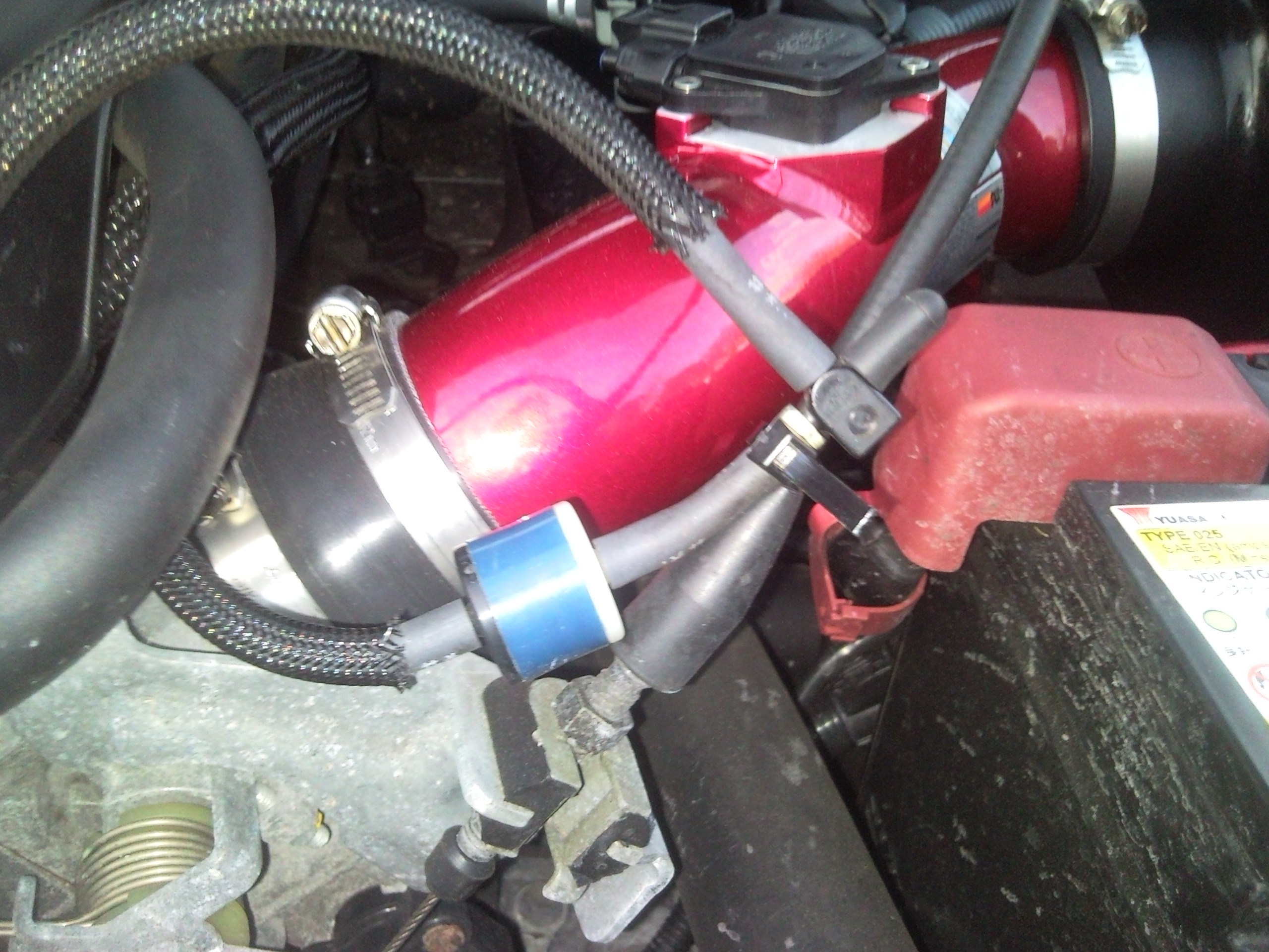

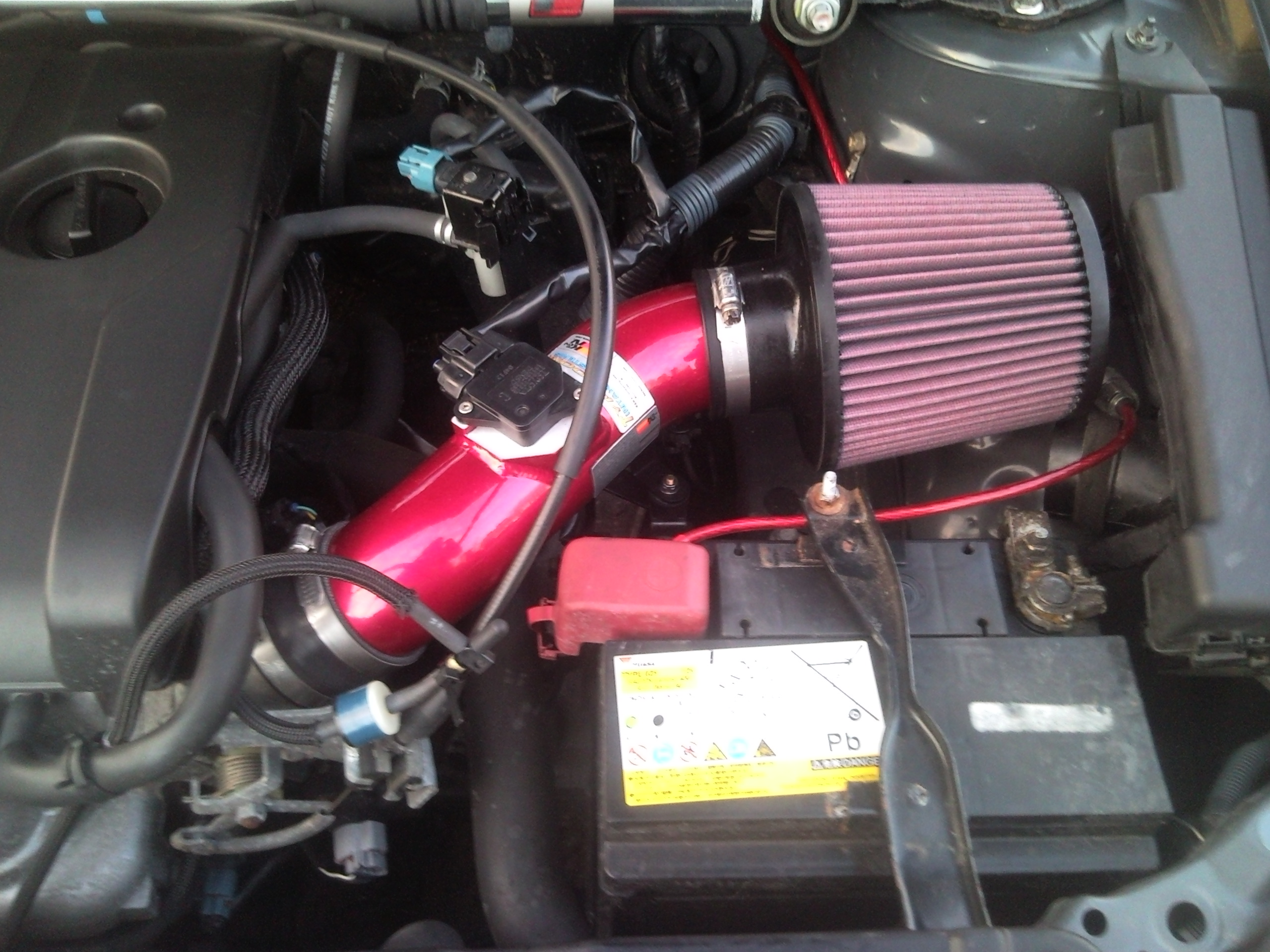

So here is the finished product :thumbsup: and i also included a pic of the vacum hose set up on me 04 facelift for future reference.
Hope u like.

The Vacum hose arrangement is different on the PFL to FL, Ive had Kearons parked next to mine and played spot the difference.
Hope u like.
Keep your eye on the little black wire going into the MAF, looks like its under strain to me ;)
cool, so u completely deleted the VSV and just nipped off the first t junction?
Yeah i need to do that so i dont start having any problems with it pulling out. Is it a hard job coz i'm not great with wiring?
hmmmm your in cov. if you want me to do it one weekend im happy to do so. im only down the road in northampton.
if you want to do it yourself, just make sure your good with soldering, and then its a doddle.
