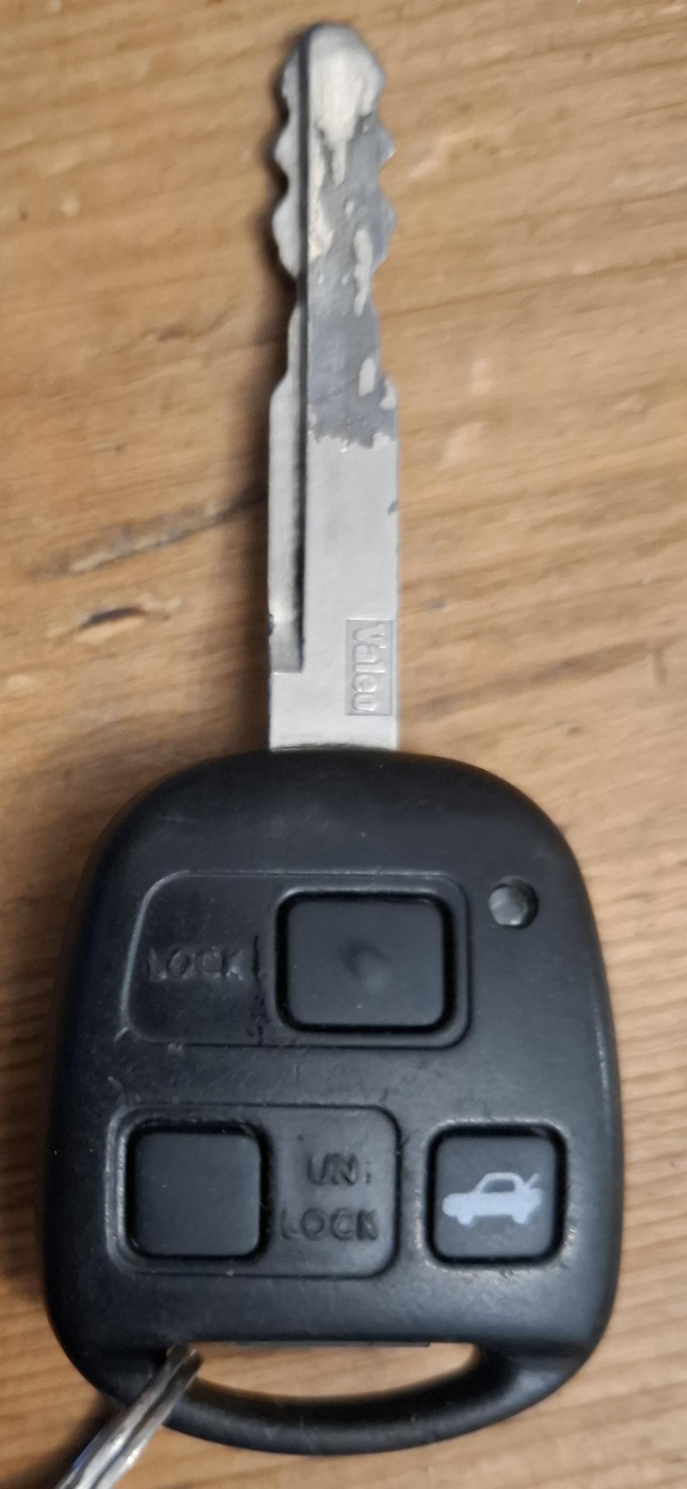

Just replaced Battery - really easy.
Remove small Phillips screw, prize the two parts of the key apart and the complete button unit will drop out. Prize the cover off and the Battery will be under it. Have the new Battery ready out of its packaging - handle it with a dry tissue so that you do not get finger marks on it (probably not really necessary but advice I was given when I got the new battery). Pop the old one out and IMMEDIATELY pop the new one in. I suspect that too much of a delay would upset the programming. RE-assemble the fob and test it - done. :clown:
