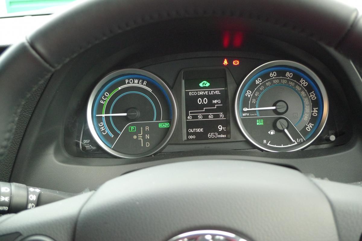

I am still very frustrated with the speed display on my Auris TS HSD. The analogue speedo is too far off the eyline, unclear, and too small. The digital display Trip Monitor, which is nice and clear, can be configured to read all the same information that is available on the main Touch display. This is Average Speed, MPG Average, ECO drive level, which is meaningless, elapsed time, range, but not speed.

I hope the Hud-e is the answer if it can be re-programmed but it should be a lot easier for Toyota to change the firmware so the trip display, showing Eco drive level in the pic, can show MPH. Nobody knows what information Eco drive level imparts to the driver anyway. The fact is they do not care enough about customer feedback to make it happen.
