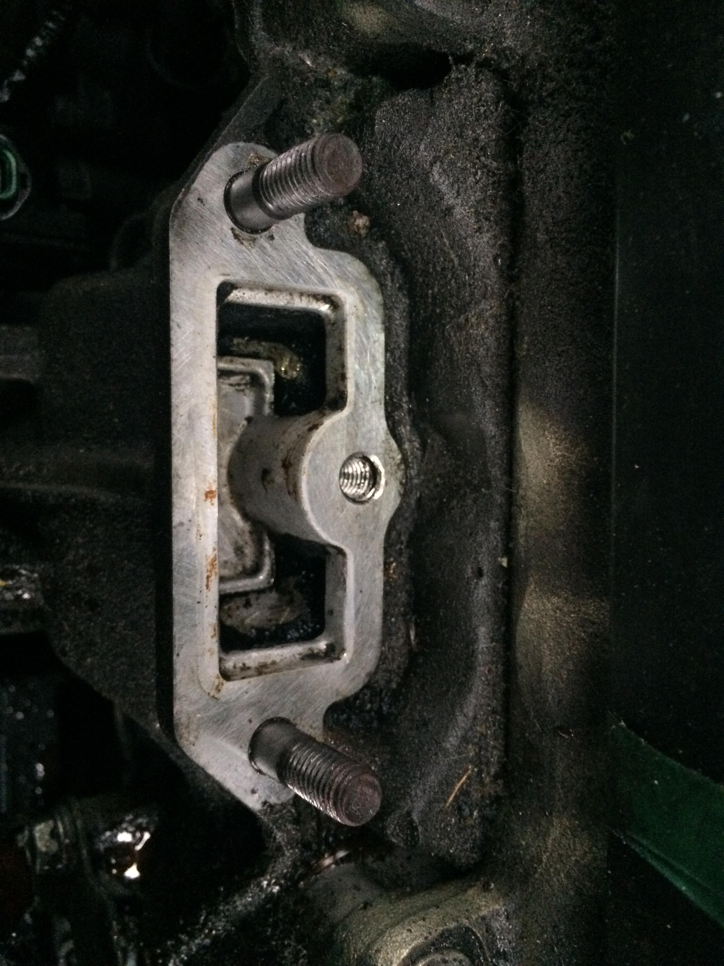

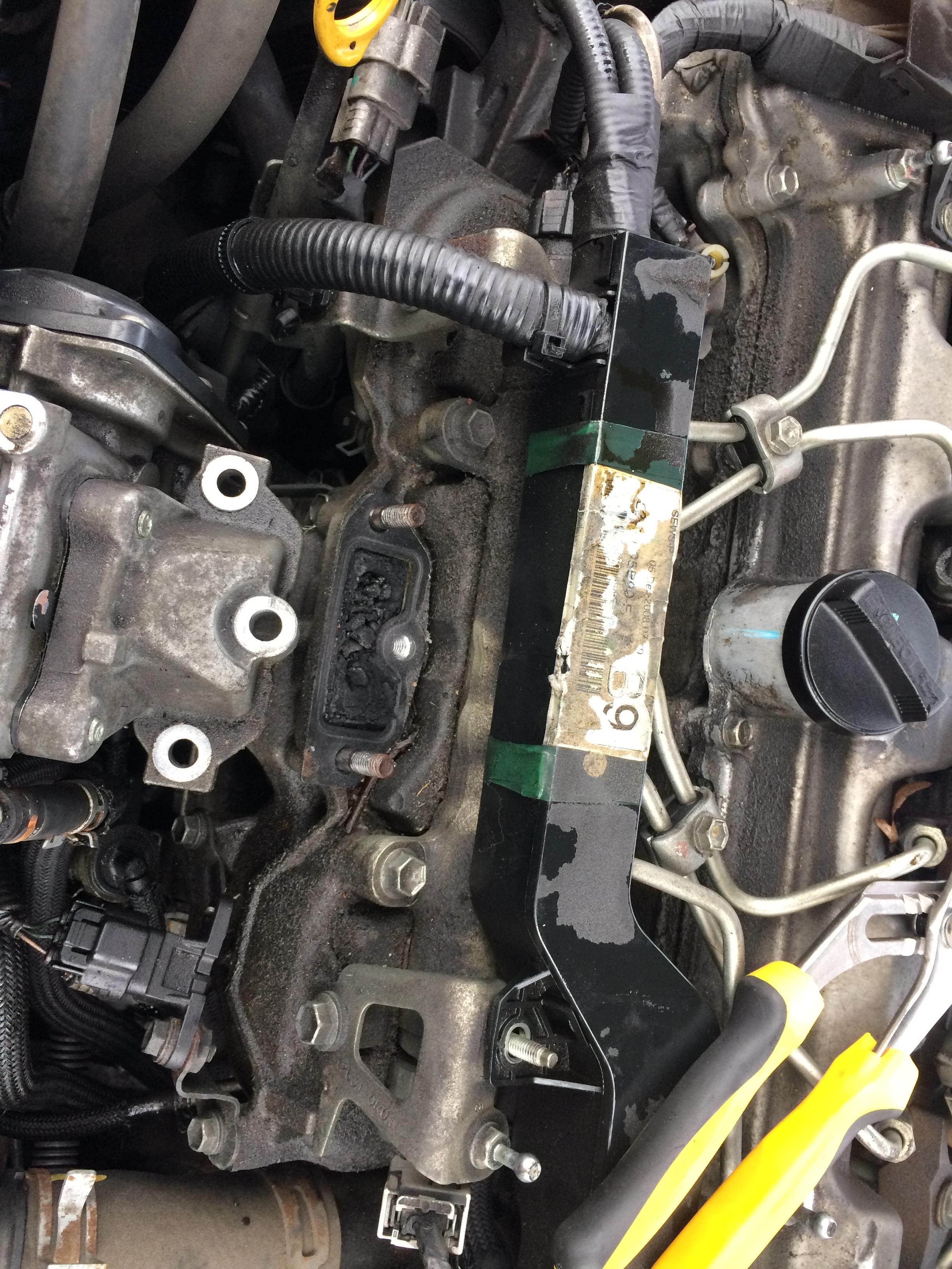

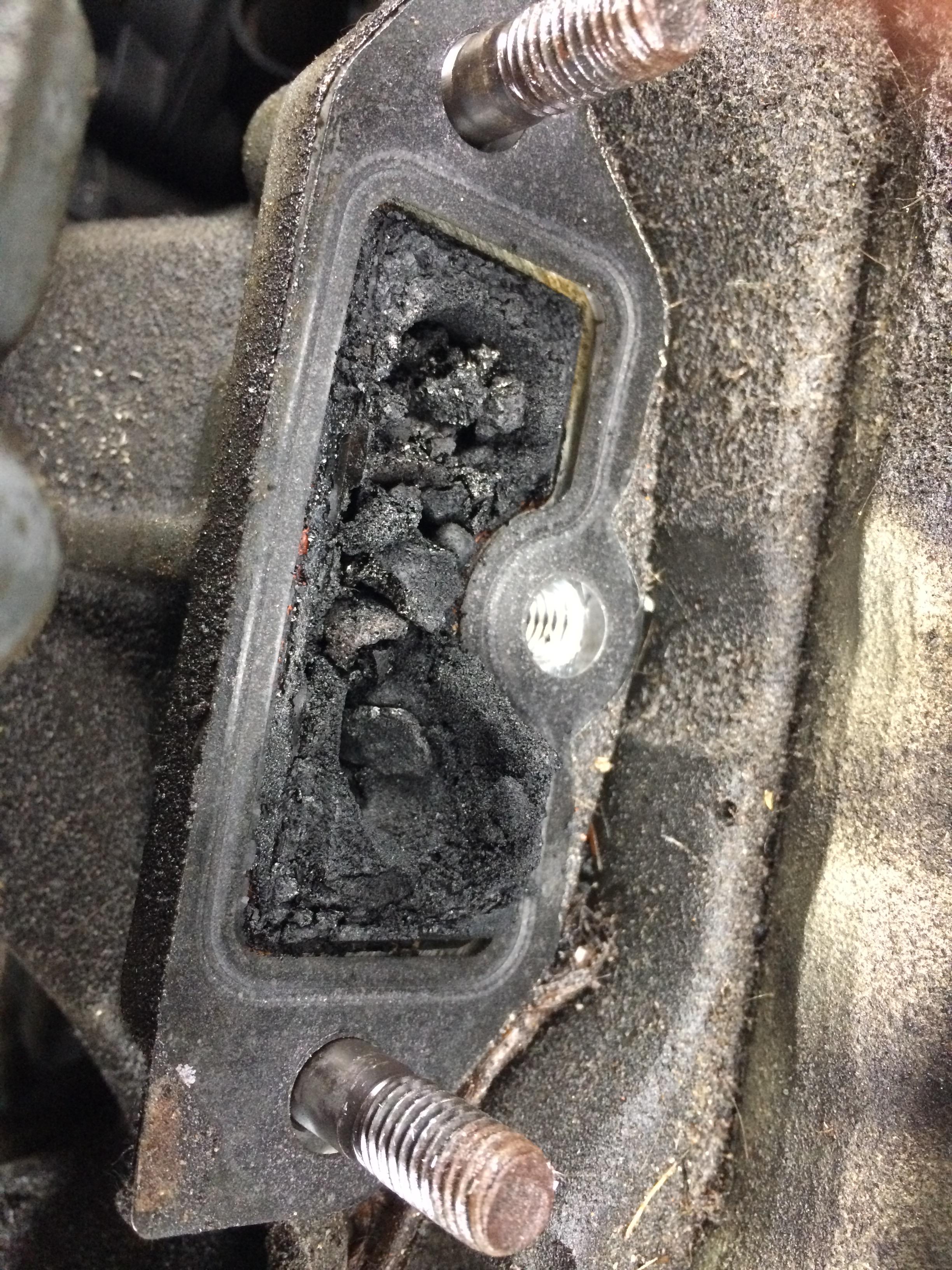

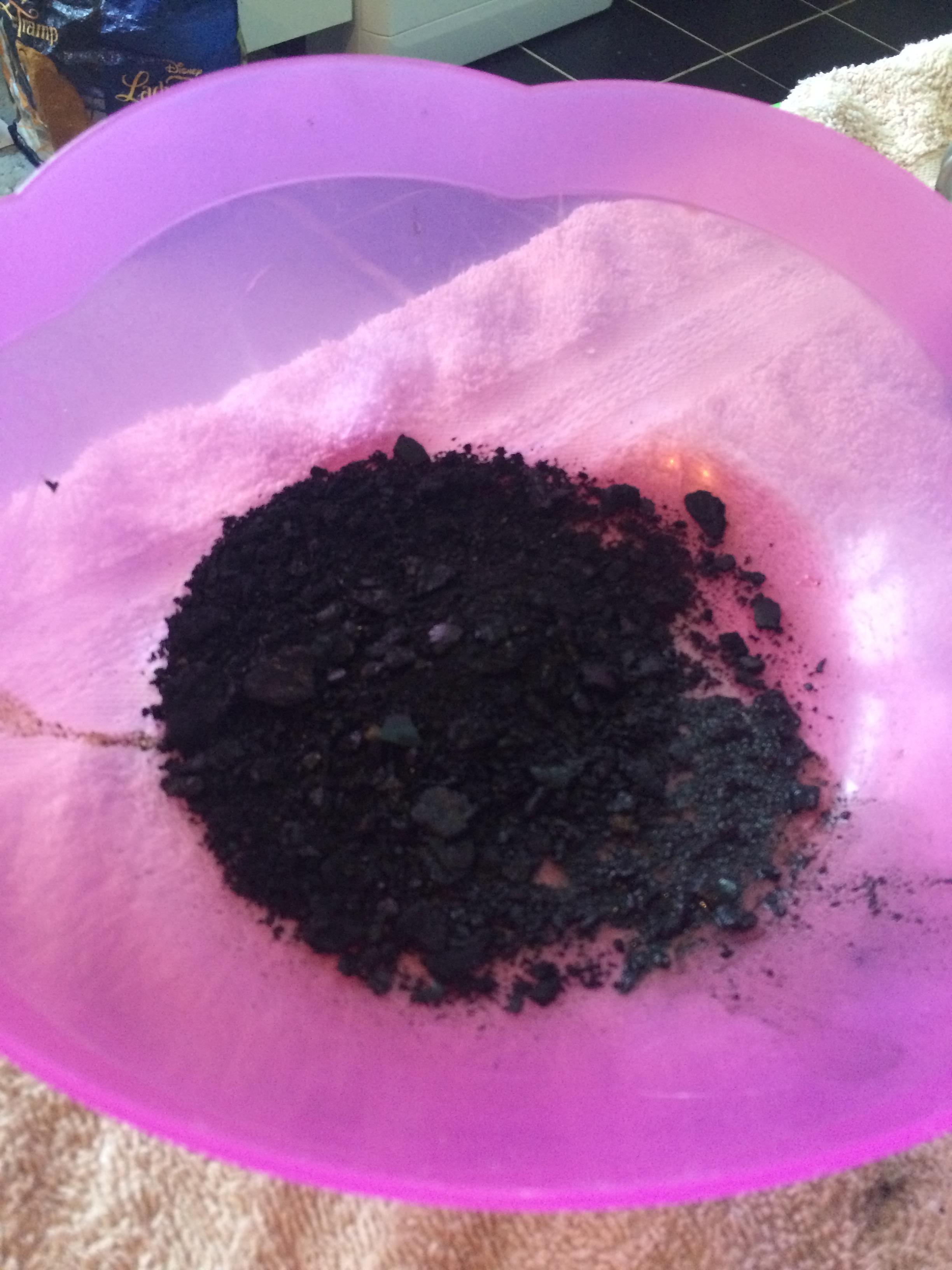

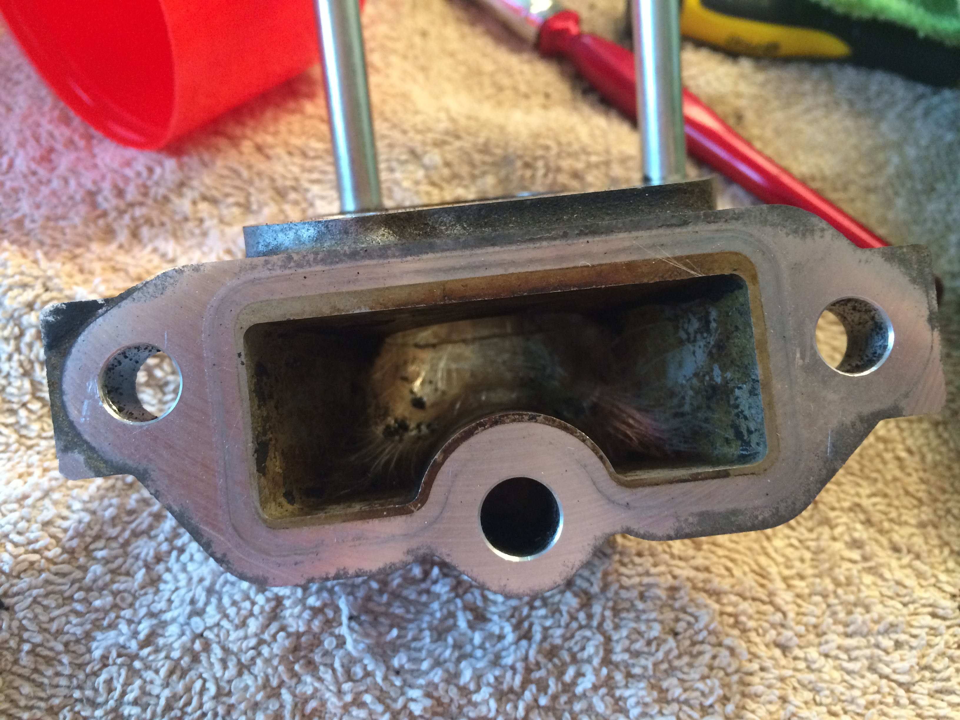

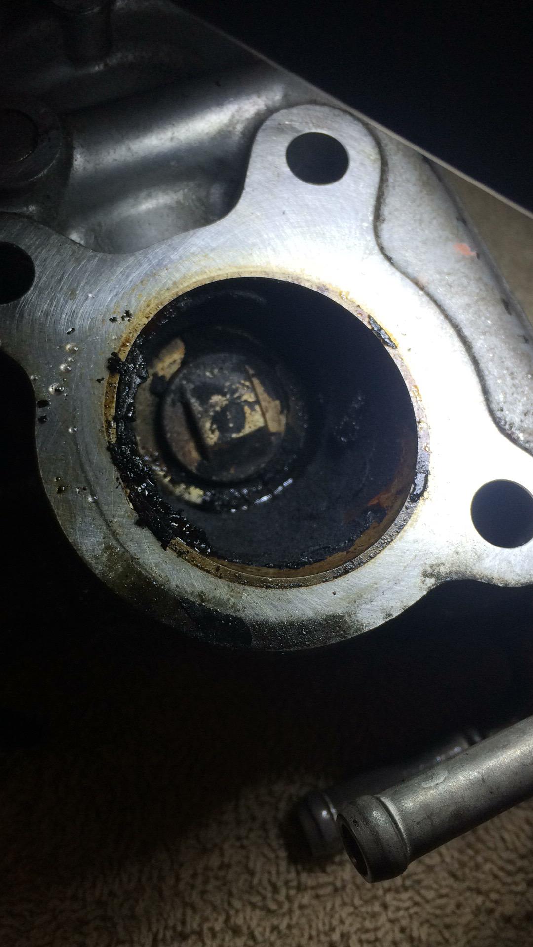

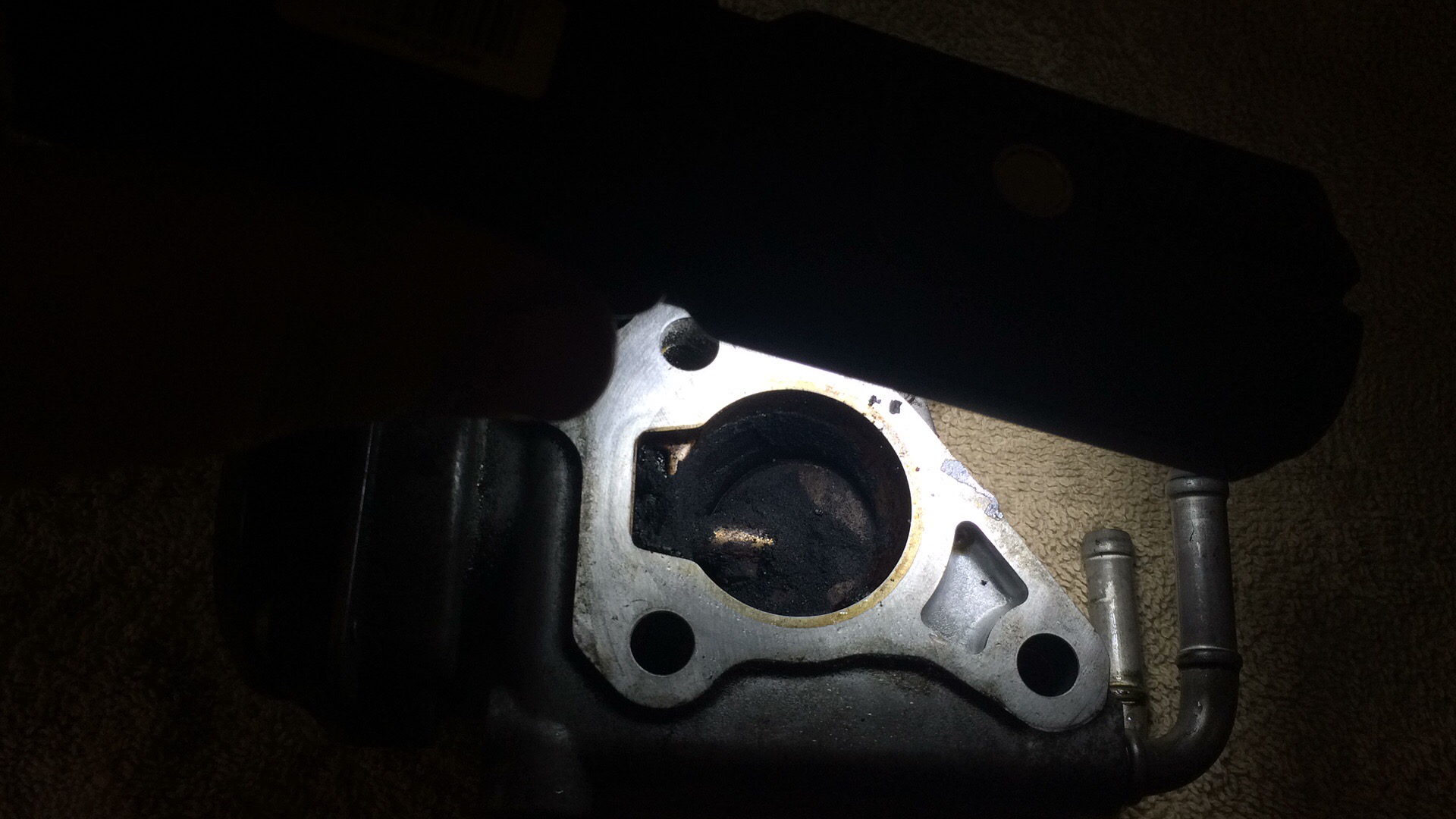

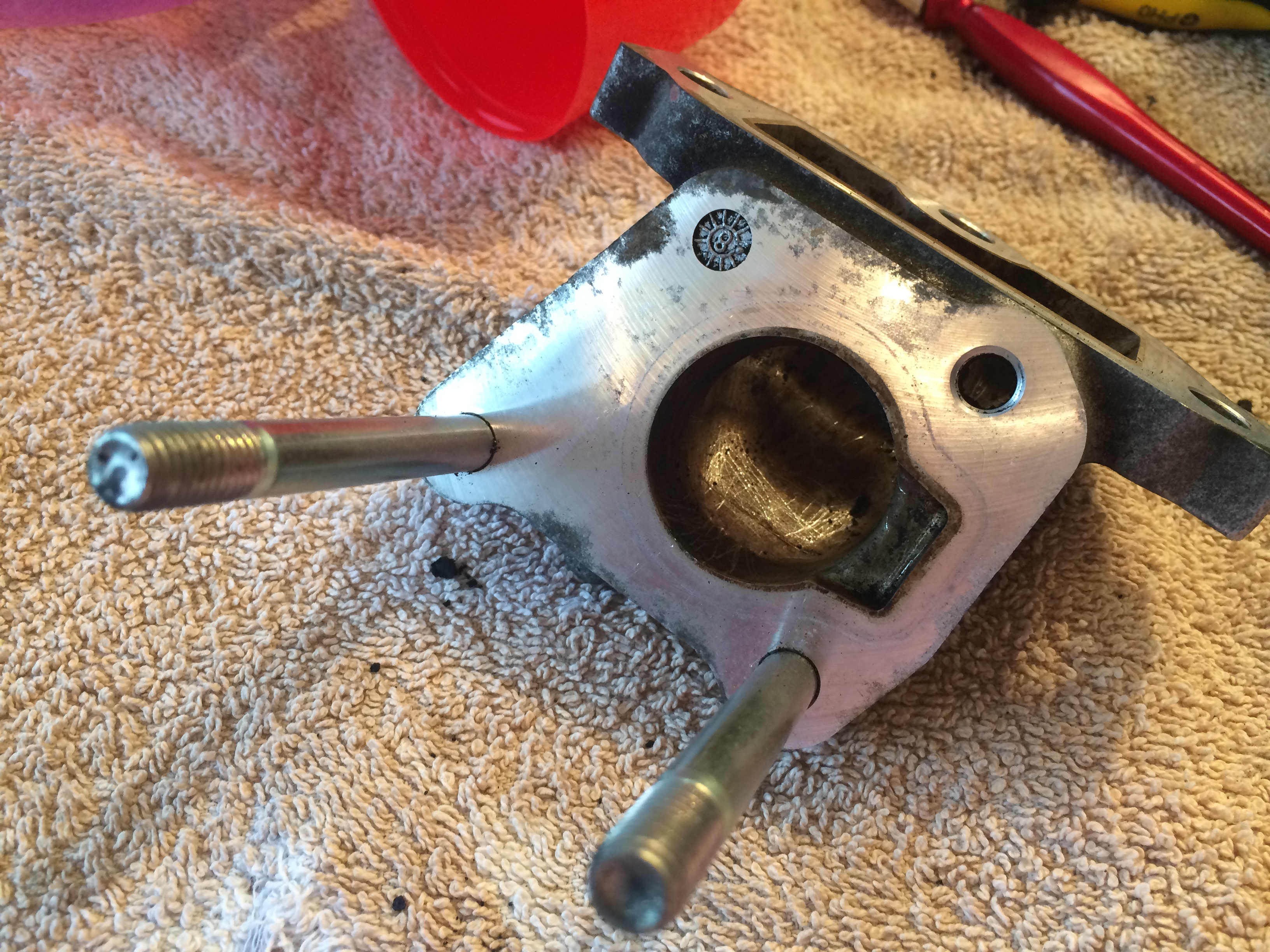

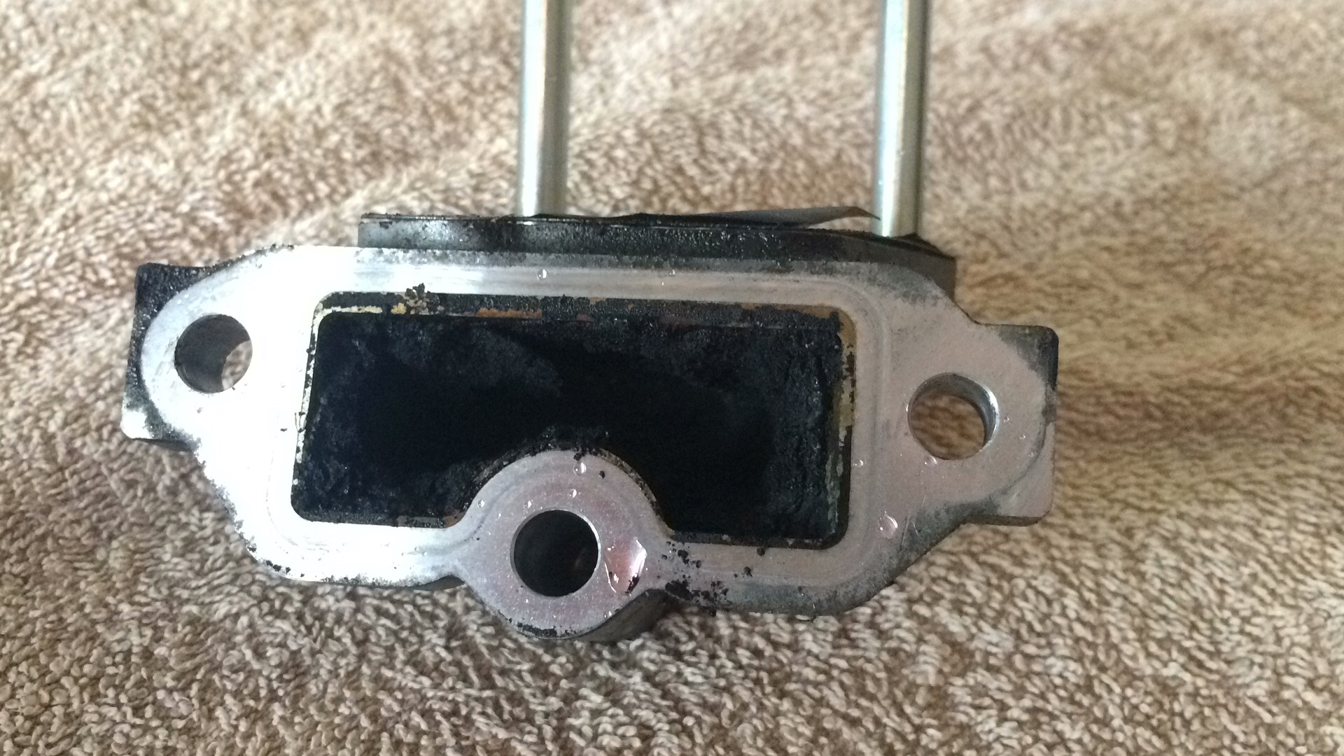

Just updating this topic as I thought just on the off chance I’d take the EGR valve off and see what state that was in.....struth just look at the pictures....
Got it all back together and up to temperature and took it down one junction of the m4 and back to get it up to temp quicker otherwise would have taken ages. Anyway, all I can report back is the uptake is better she seems a bit more responsive and the blue smoke has certainly died down when driving but still gives it out when pulling off or boosting away.
The bit of oven cleaner I used to clean the egr valve up etc should all have burnt off by now with that drive shouldn’t it? Probably did 10-11 miles in total, 10 of which were at operating temp and 80/90 down the m4...
Would appreciate thoughts...

On another note relating to this thread, wow...that egr is pretty much coked up, my partner did his recent, and i’d say it was half that amount upon removal, saying that he has the 2.0 diesel.

I just love your EGR piccies. The best yet.
