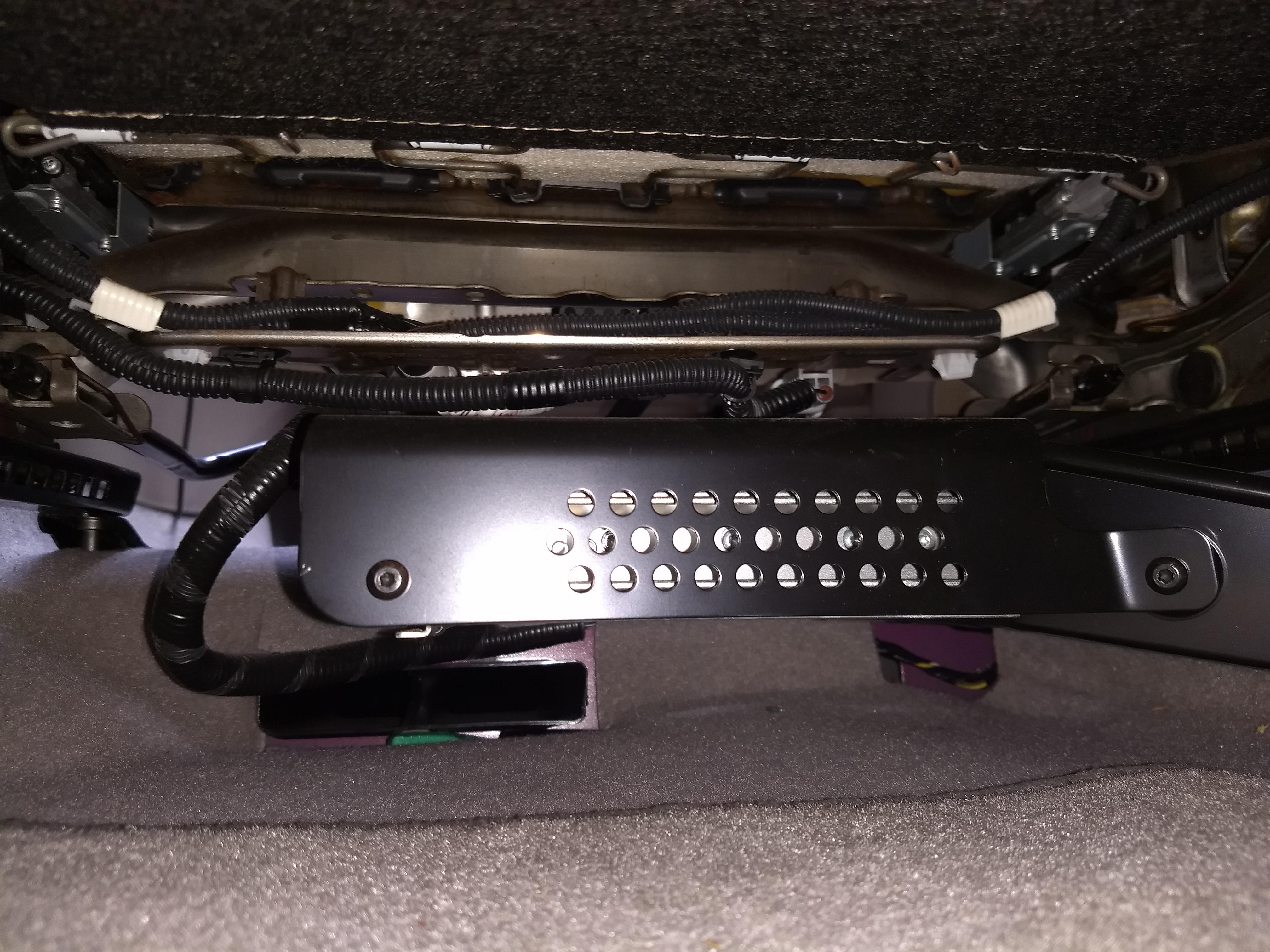

Is it a JBL head unit?
if it is your problem may lay with a loose connection at the amp.
it’s located under the passenger seat.
Hi Paul I don’t know what a JBL unit is? I know the amp is under the passenger seat. I just bought a replacement radio. So all good in music land. Thank you for your reply.

Nope. The higher spec models had a JBL head unit and amp. Had one in my 2005 Prius and beyond.  Not a head unit issue if amp has a lose wire. Standard head unit not JBL has no external amp
