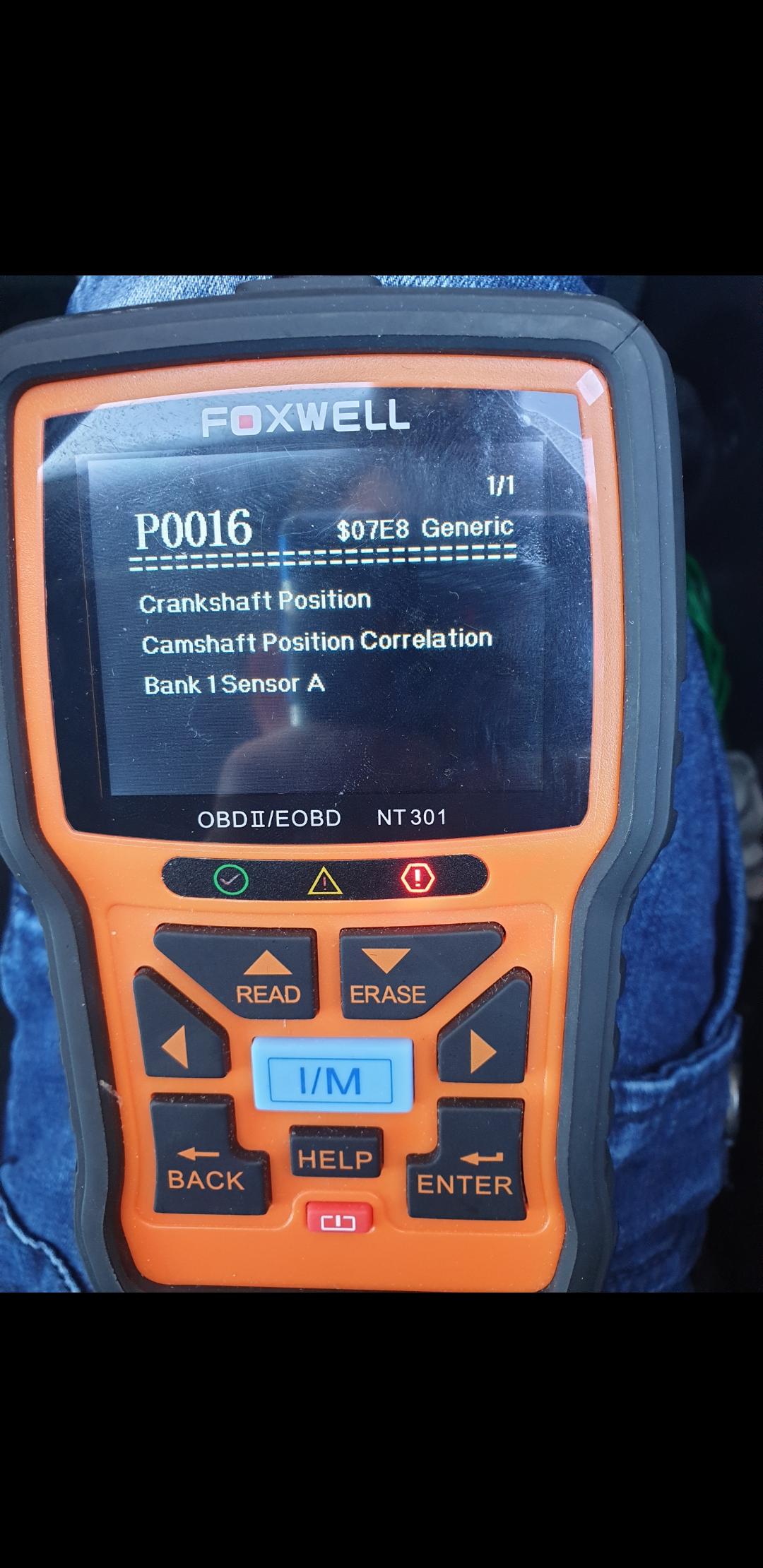

I have this problem with me yaris 1.3 vvti 2007 model...it says crankshaft position and camshaft position correlation bank 1 sensor A?
What can I do?

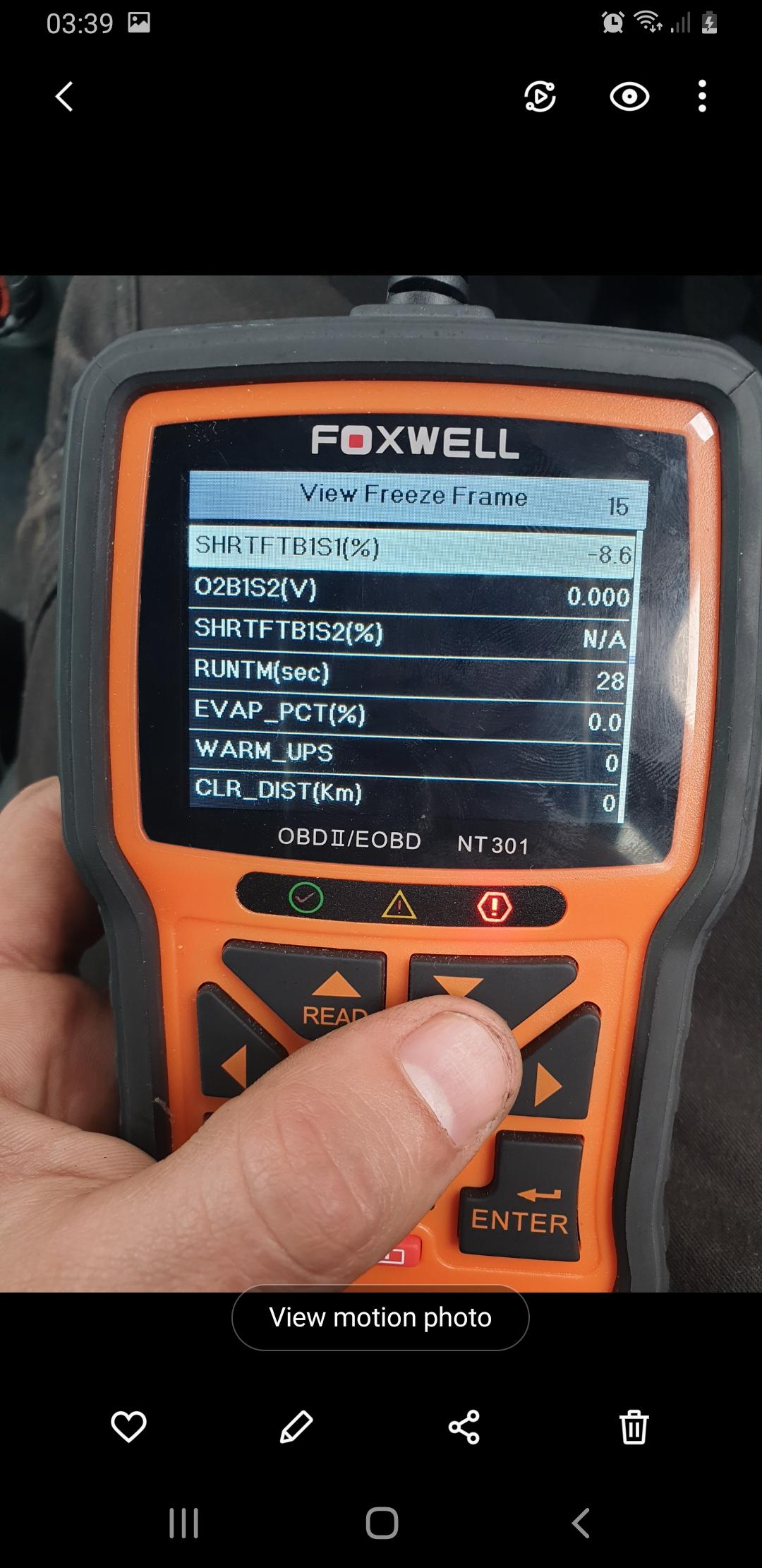

Also do you have the freeze frame from the code reader? When did the engine light first come on?

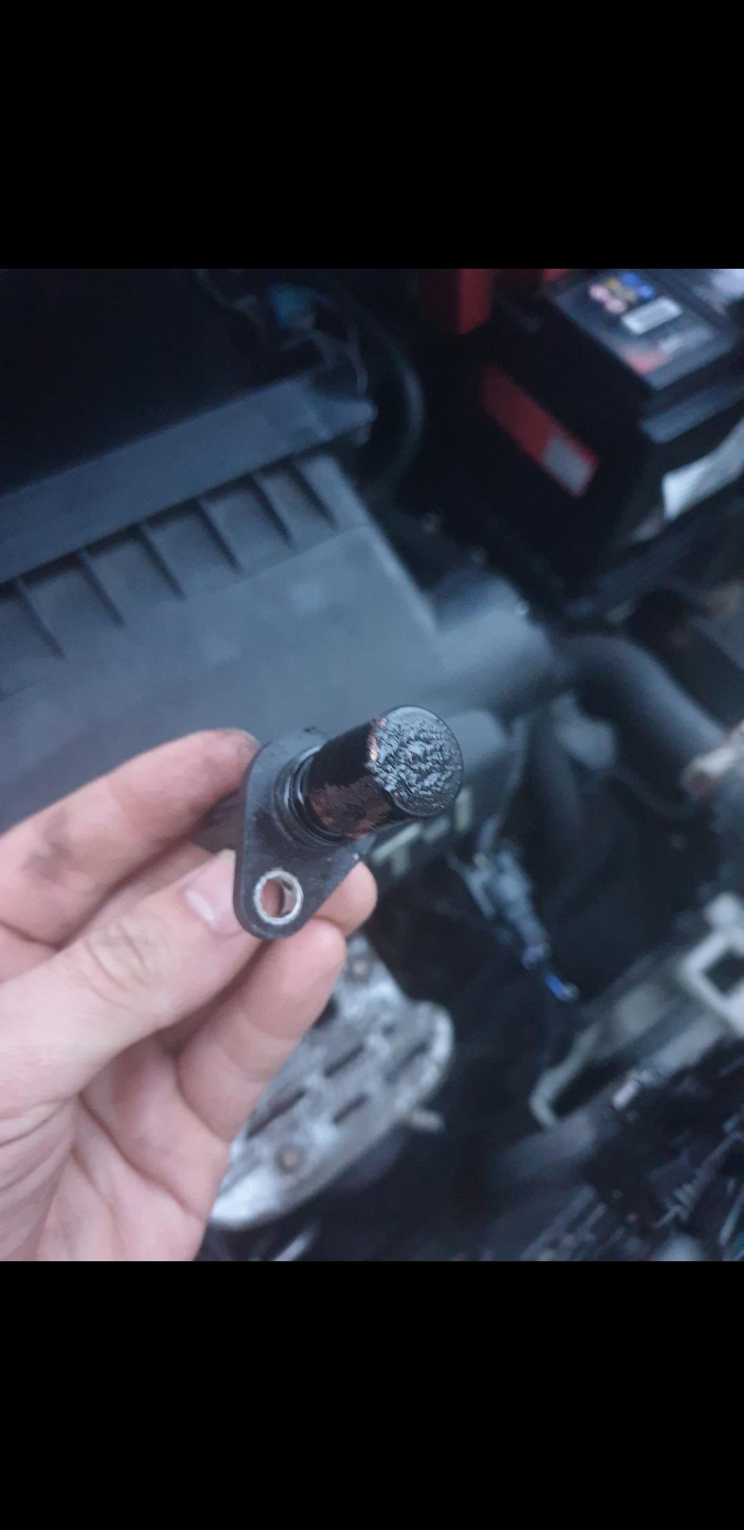

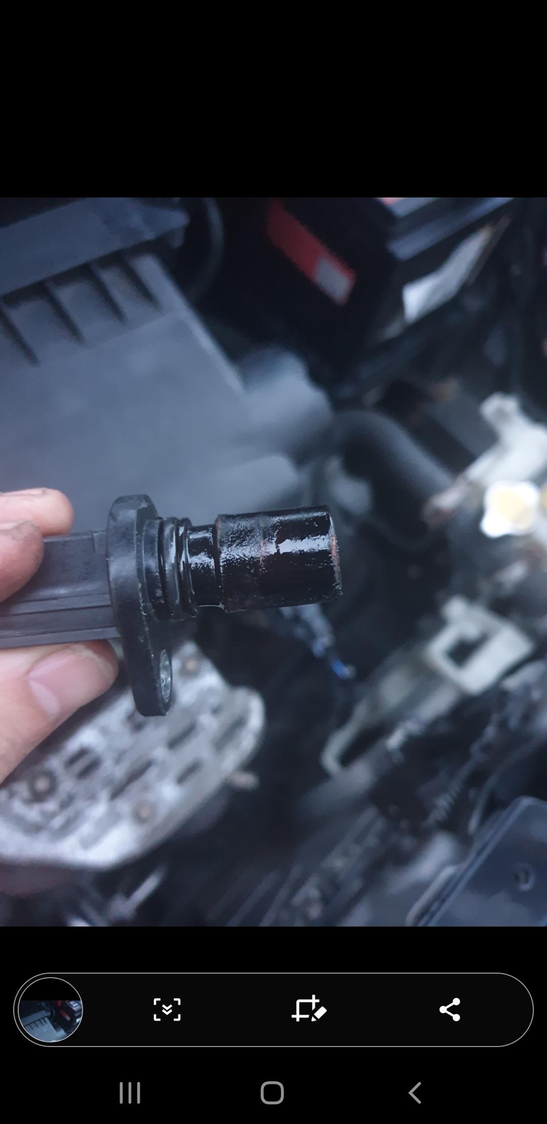

My camshaft sensors is really dirty..
A clean may all it needs!
That was definitely caused by lack of regular oil changes, it's a common fault when oil changes are neglected.
i would also pull the crank sensor and clean it too, no doubt the cam cover is leaking removing it will tell you how it's been looked after it will likely need a good clean

Any chance of the freeze frame data of this fault? Your tame mechanic should be able to show you this on their scanner BEFORE they clear the codes.The data will assist in tracking down the actual fault, rather than guessing.

Could still be a dirty/faulty sensor or wiring that is easily fixed, on the other hand like you say if it's been run with this issue for a while then permanent may have been caused. Still love to see the freeze frame data of this or any other fault codes in order to expand my knowledge.

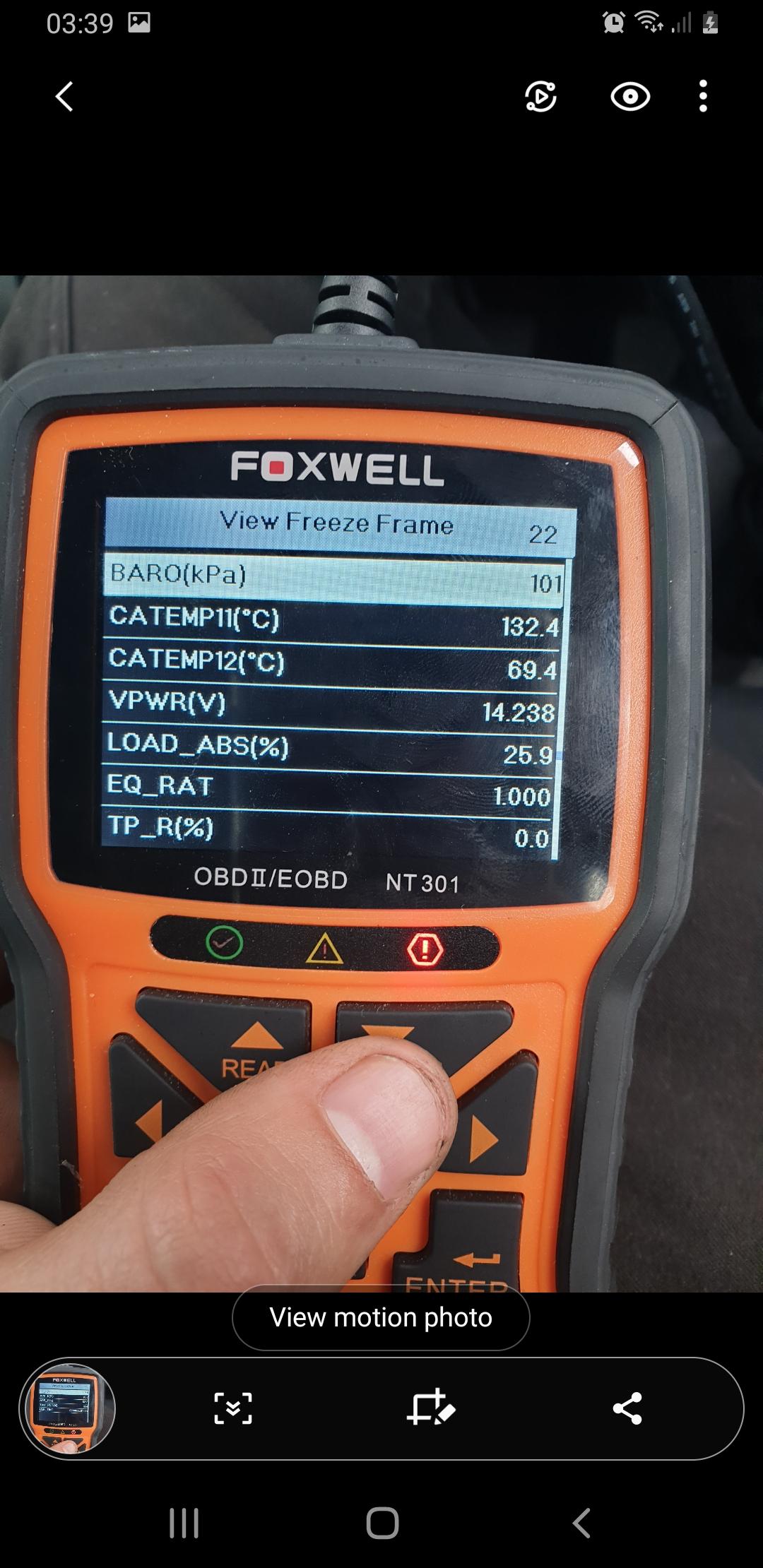

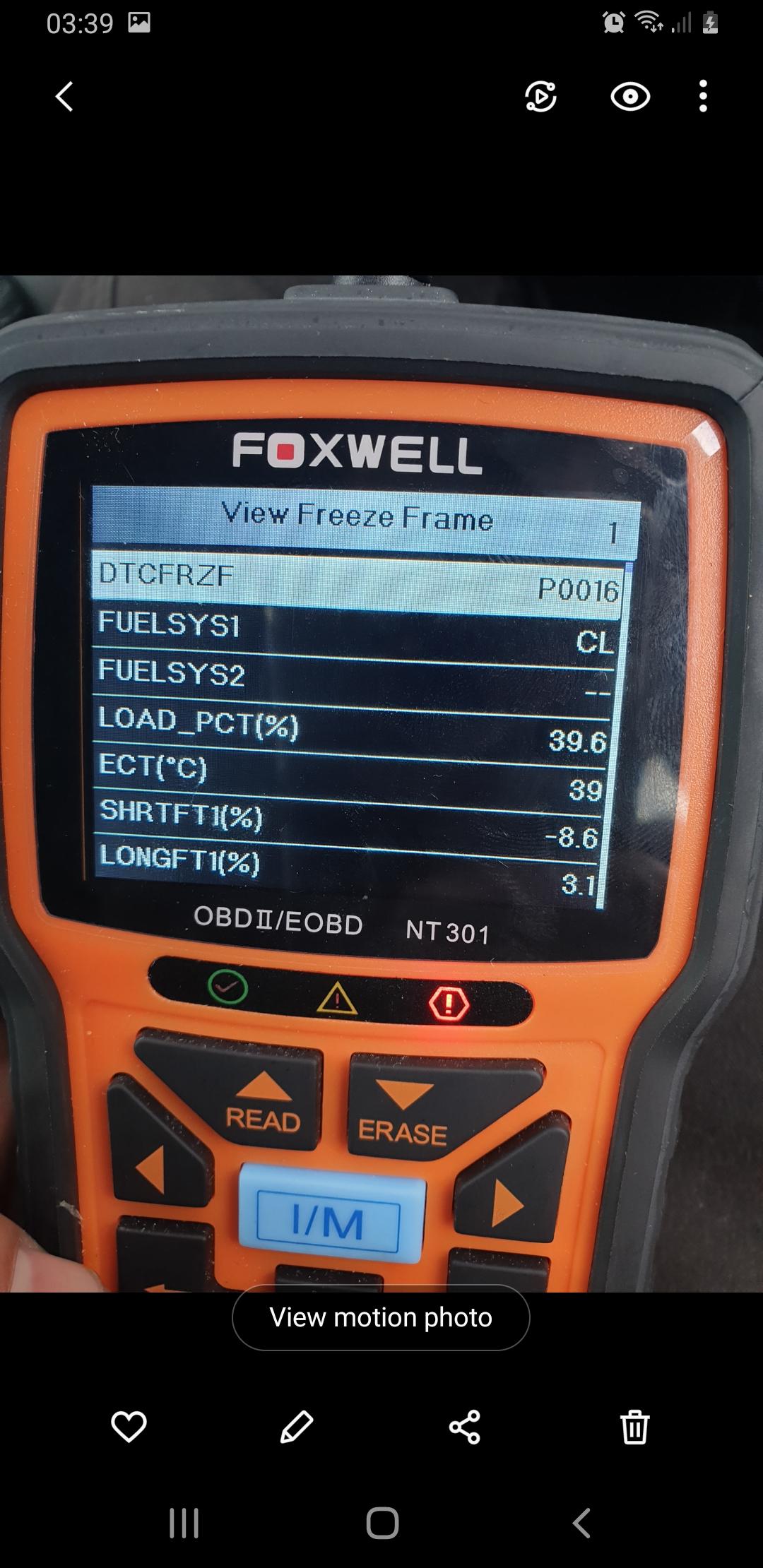

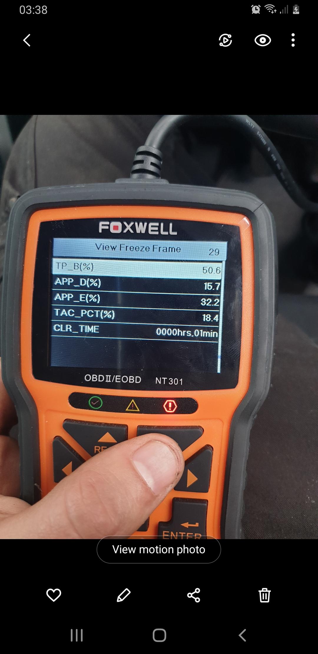

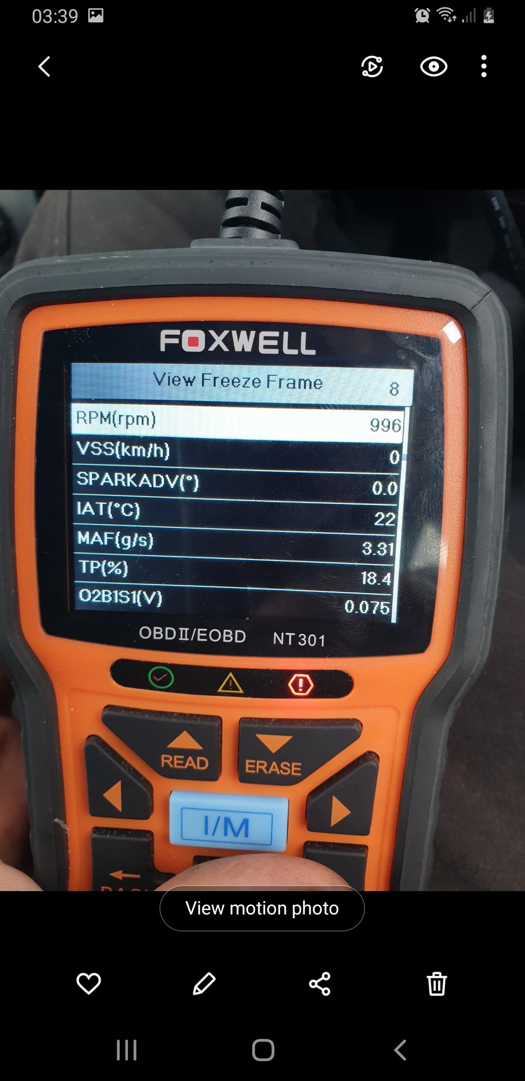

That's my freeze frame
