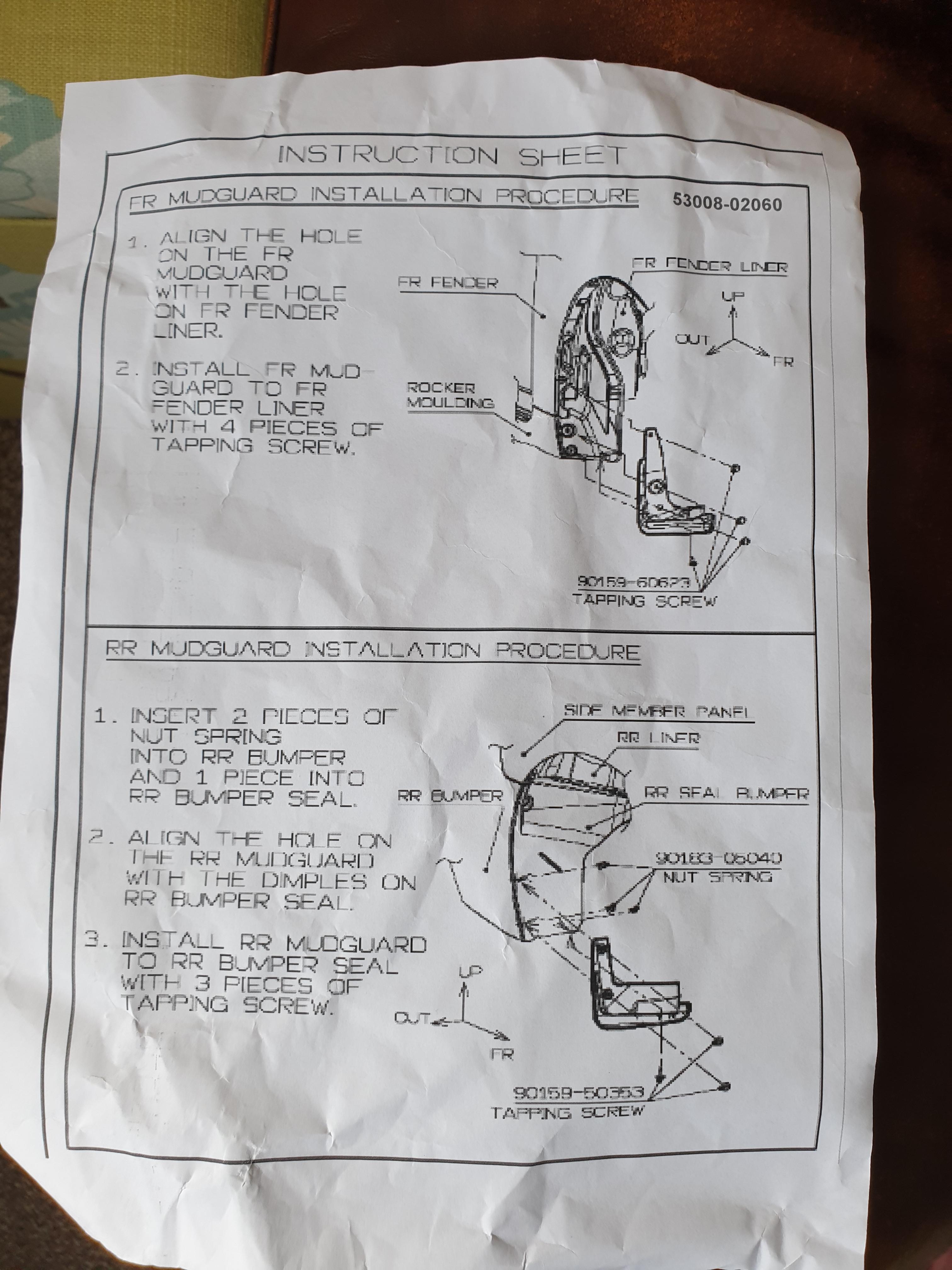

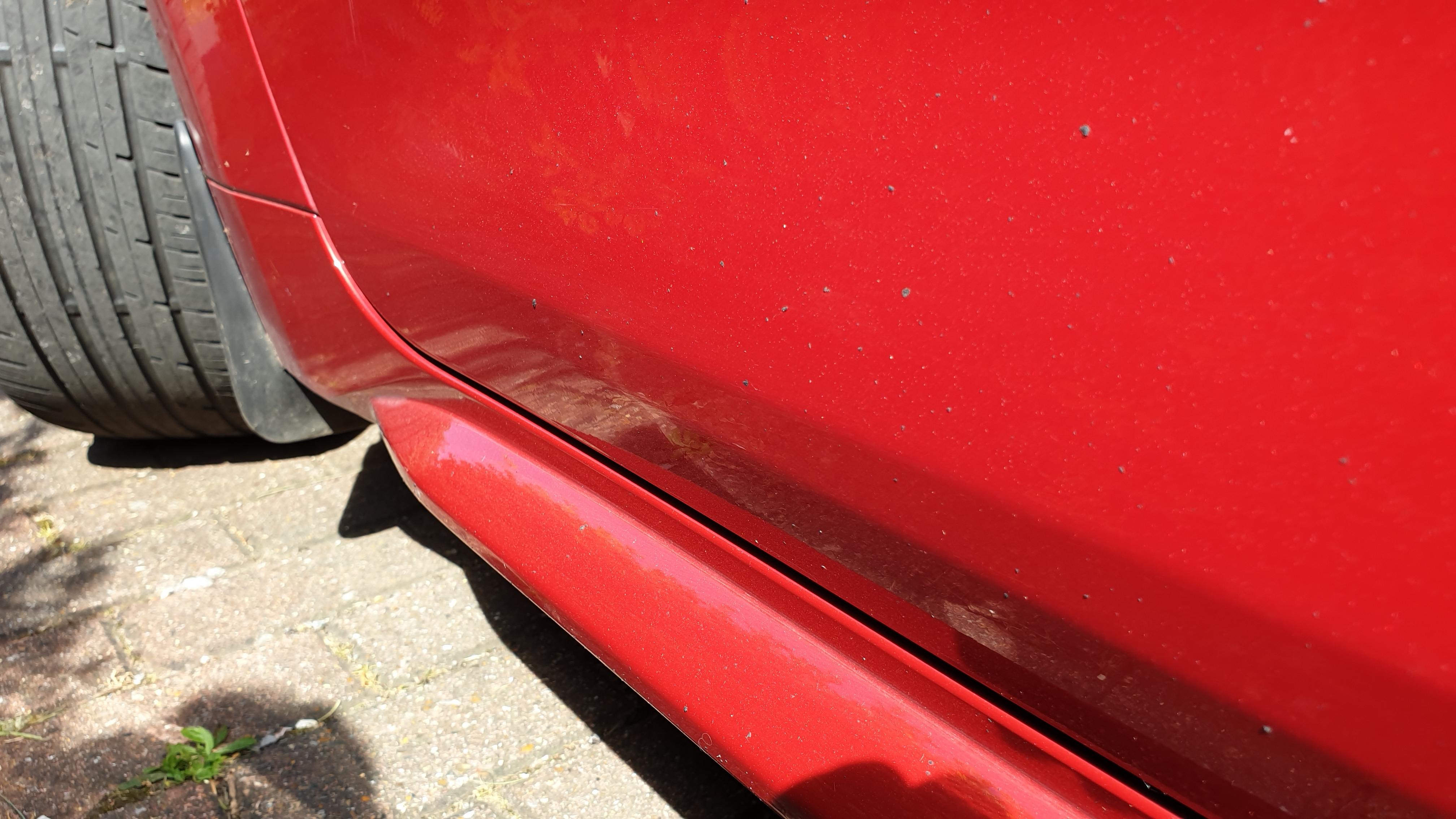

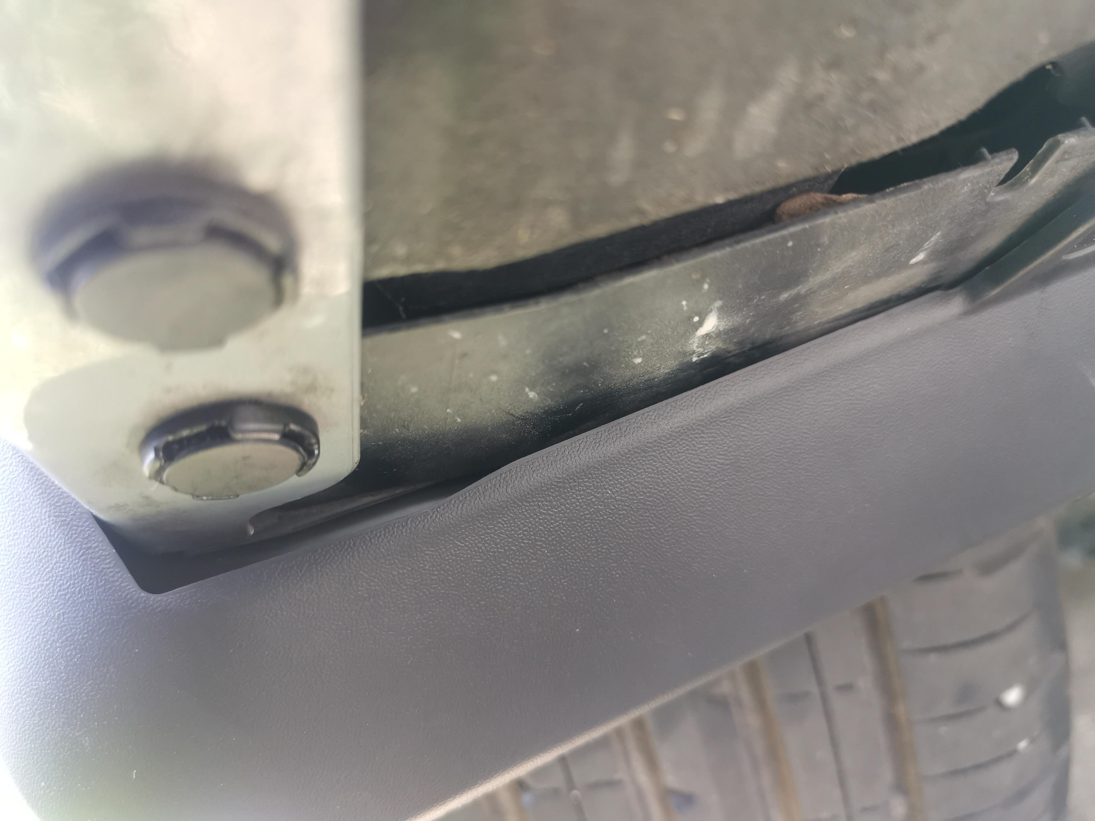

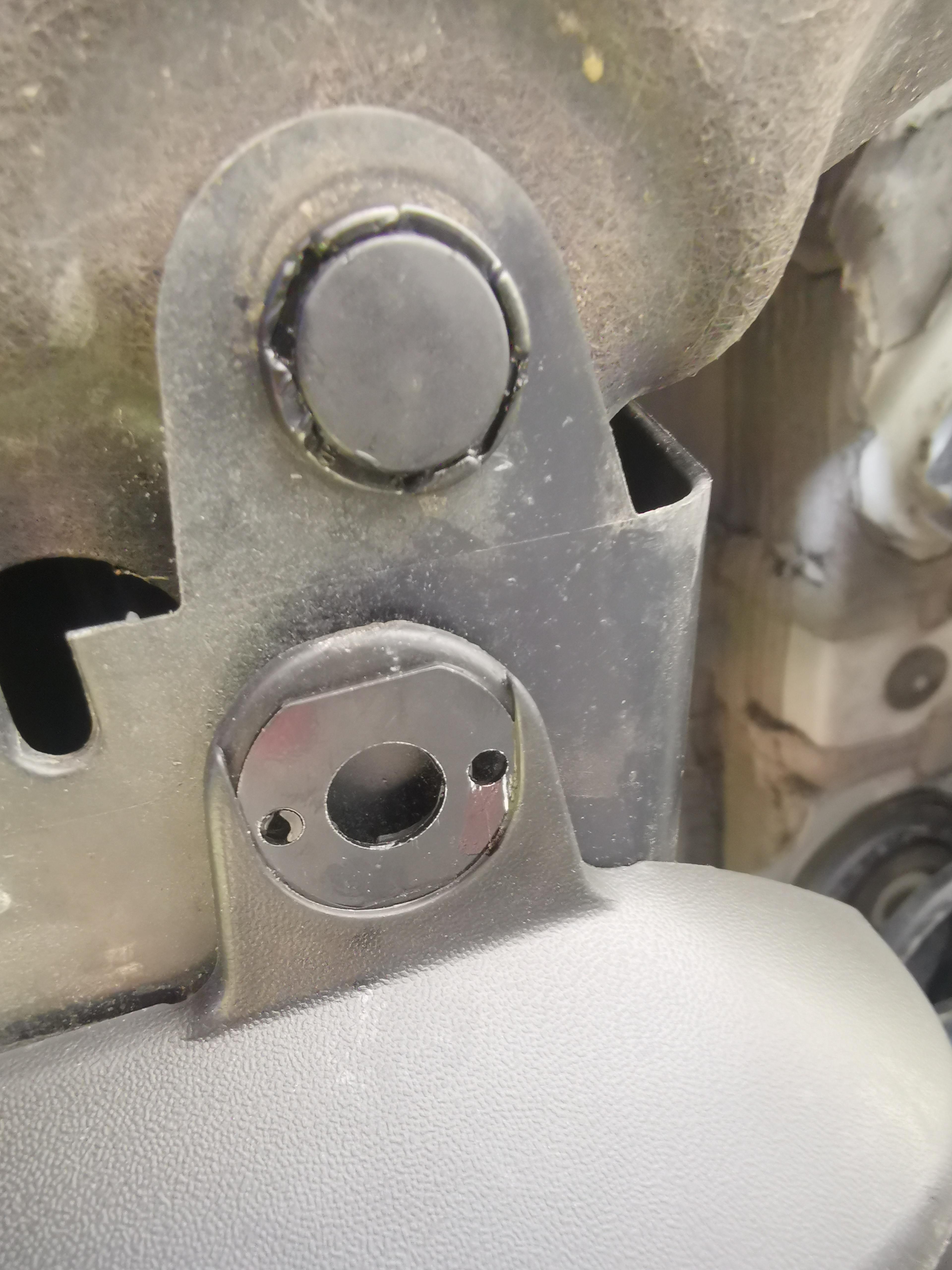

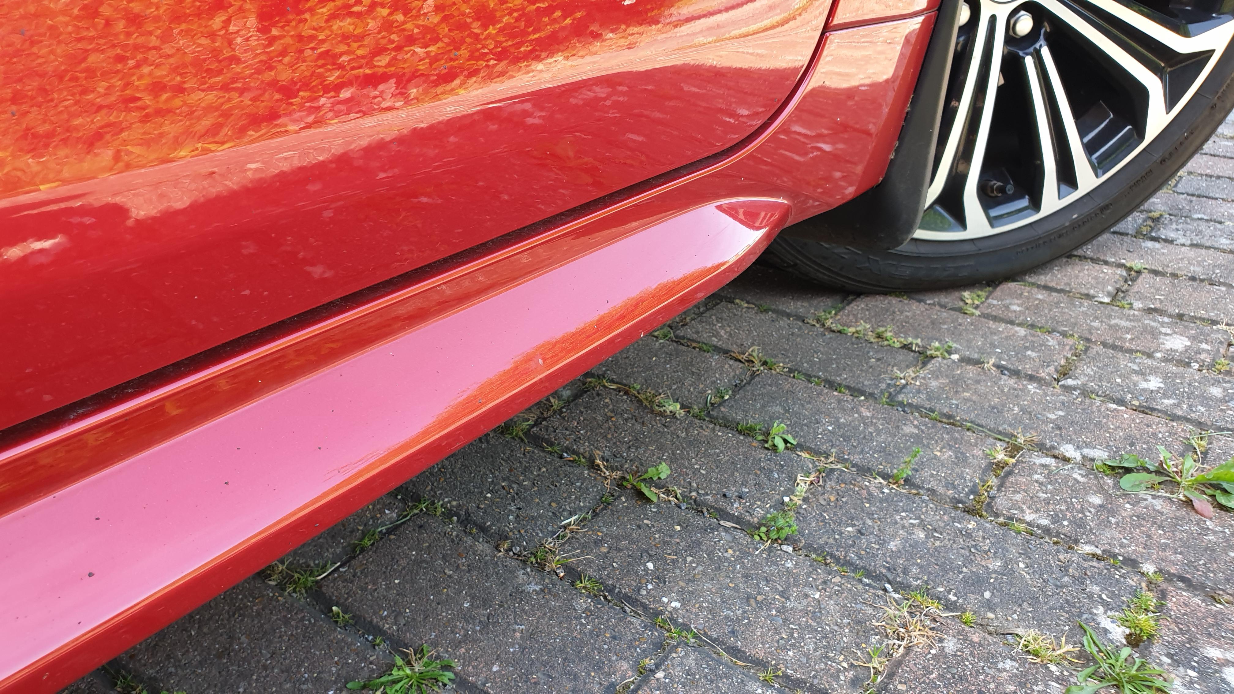

I’m happy to report that my official Toyota mud flaps arrived for the grand total of £32 (not £27 as per my post above) and were very easy to fit; taking me about 60 minutes in total (which includes generally taking my time, faffing, double checking instructions etc).
You do need a 10mm torque wrench ideally, which I had, but otherwise I think anyone could fit them.
‘They’re very secure once in place and I think they’re very svelte and unobtrusive.
The mud flaps on my last car did wear through the paint layer down to the plastic where they rested on the panels. Not an issue if you never remove the mud flaps, but the design on these is the same. Micro vibrations will eventually leave deep marks in the paint where they’re fitted (which won’t be visible if you don’t remove them). Worth noting if you planned to fit them just for the summer, for example (I don’t think anyone would ever fit mud flaps temporarily but I just mention it).

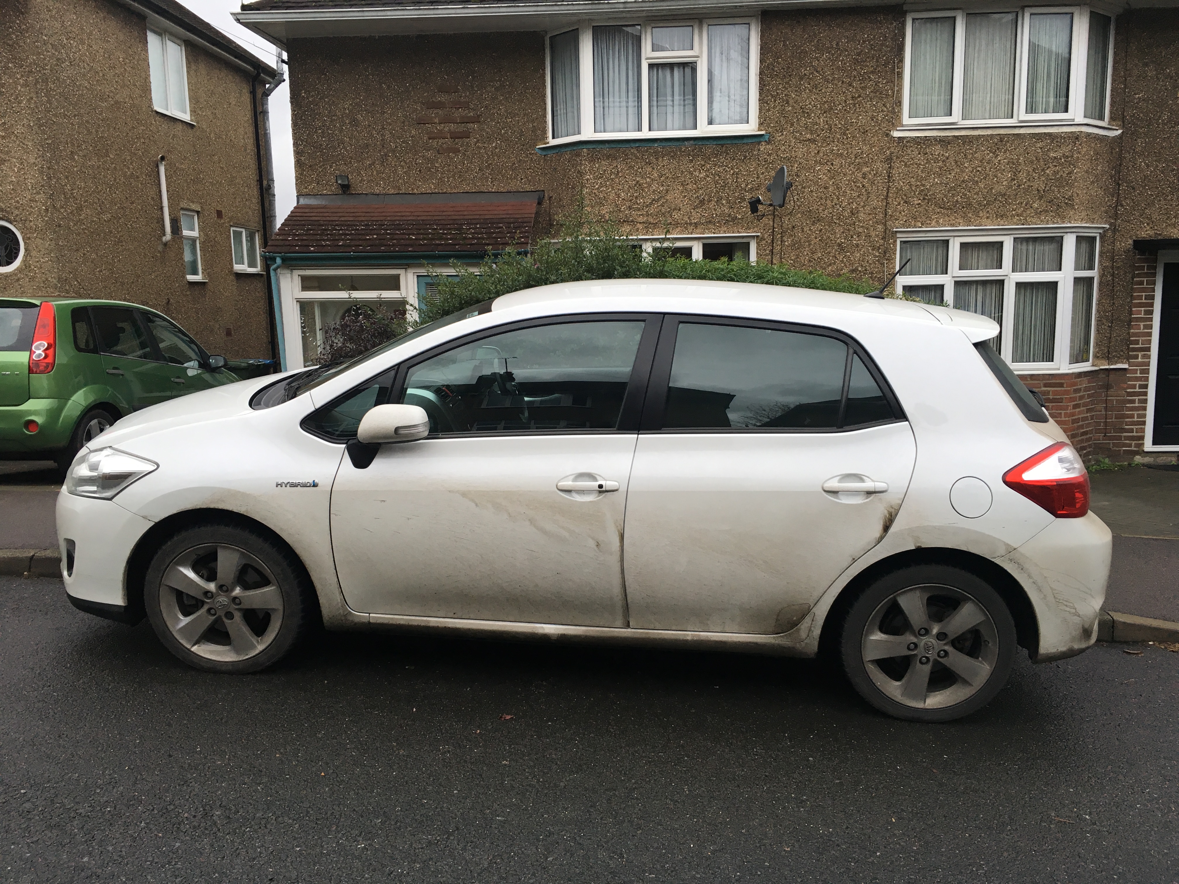

£32 for all 4 or only 2? I was about to purchase some last year as my car gets beautiful in winter motorways driving, but the price was uncomfortable high, plus I was in doubt about aerodynamics after putting 4 mud guards, perhaps will be insignificant but I just left that project unfinished.
The picture of my car after few days work in the winter of 2018.
£32 for all 4, with all bolts and fixtures.
They won’t affect aerodynamics at all, they’re pretty small, but seem to do a very good job!
