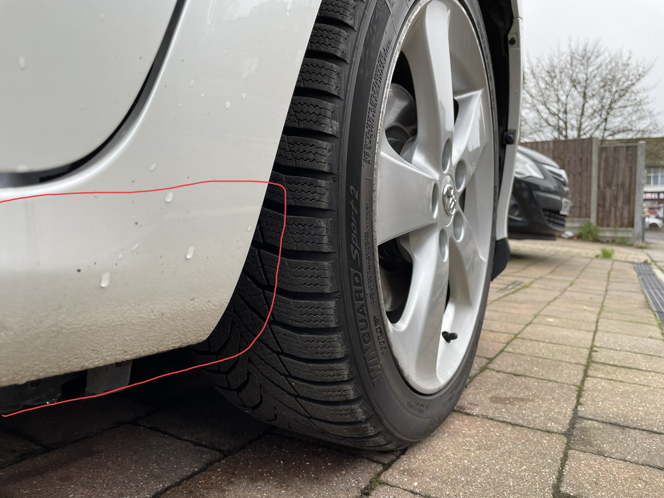

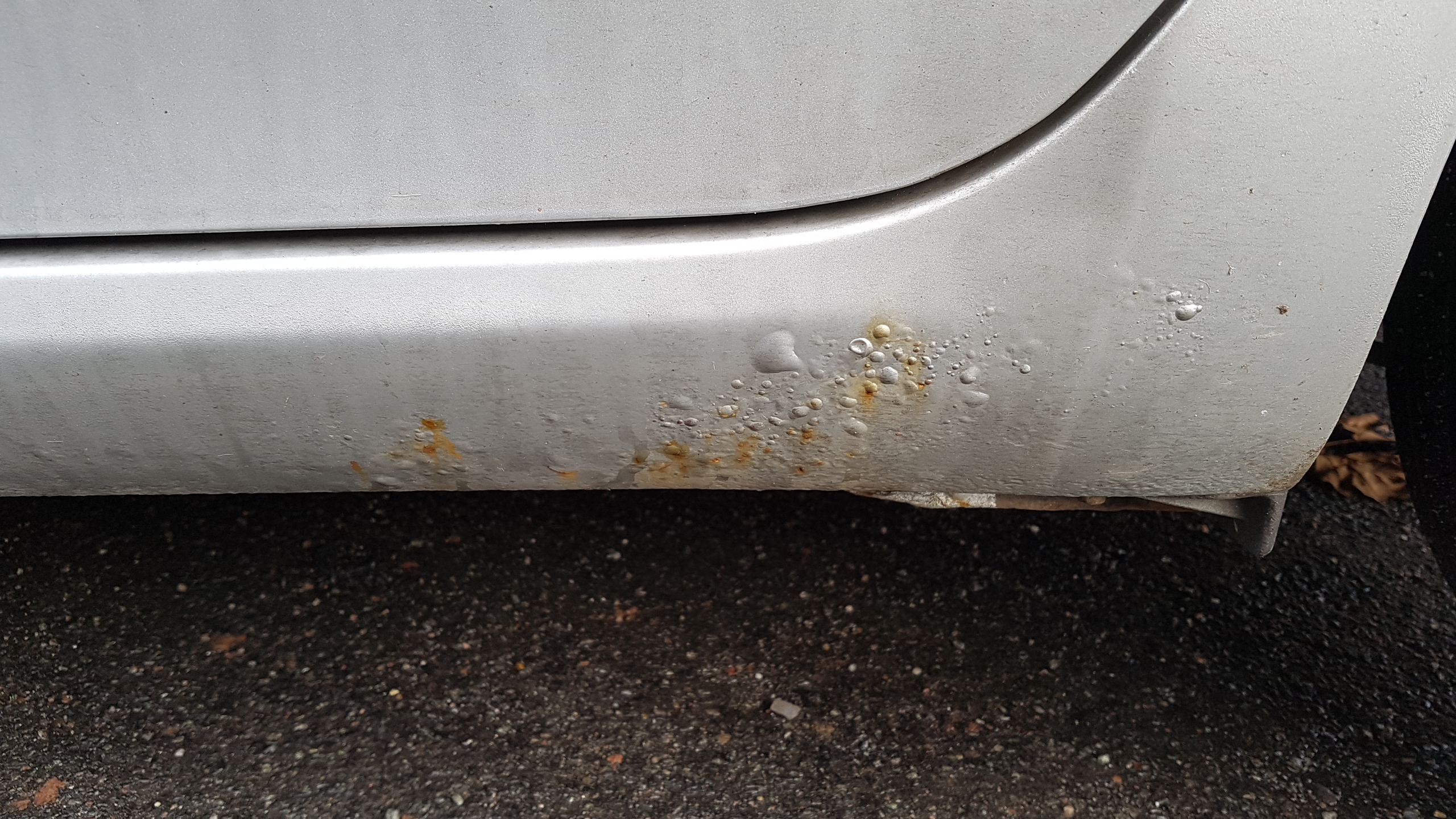

Hi guys and happy new year to you all.
In the summer I had some bodywork done on the Auris. The guy did a good job respraying various parts of the car including some rust on the sill at the rear of the passenger side. He did say at the time that rust might come back. Well it has. I called him and he said bring it in so he can look at it. He said if the rust has come back then the only way to stop it coming back is to replace the sill. Is that the only way and how much roughly would a new sill cost?
It’s the paint work that give up not the metal, IMO he didn’t make as good as the original rust protection and the metal was exposed to the salt and grid, Uk it’s insane how much salt been used on the roads most of the time without need, these destroyed the cars and roads surface. Here is the difference in the protection against stones that comes from the factory for reference, in you pictures is like almost nothing, my pictures shows thick soft layer before the paint.

Hi Tony.  Yes, when I bought the car, it came with rust in the same area but they had done a repair job which although it didn't look good, you couldn't put your finger through the paint, it was solid. With this repair that my guy did, the paint has bubbled and I can put my finger through it.
If you're saying the sill doesn't need replacing, what would you recommend I ask my bodywork repair man to do to fix it? Is there some stuff he can put on before the paint?
Hi, I can’t say what needs changing, but what I can see from the picture you shared is that the stone and grid protection is different from the original one, this is were needs to be addressed, plus of course A new sill if necessary, those only the guy who will work on the car can say it. Maybe seek another quote from different paint shop and see what they will say about it. 👍
Looking at your pictures I would say the sill needs replacing I would imagine you would be able to push a screwdriver through that rust.
you could get a quote to replace and weld in a section of the sill which would be a lot cheaper. If you get a new sill put on make sure they cut the old one off as I had a Vauxhall cavalier once which had the same problem and the body shop just stitched the new sill on top of the old one.
on the bottom of the sill where it is welded to the floor pan are usually small narrow slots that allow any moisture to escape from inside the sills make sure these are clear also at least once a week give the car a good hoseing down underneath to remove as much salt as possible and don’t forget the wheel arches.
as to cost not sure probably around £250 to £300 to replace the sill.
normally when you see bubbles in a body panel its too late
this is rust that has worked its way from the inside to the outsie
the only way is to cut out the rusty area and replace with new metal
i would tell the bodyshop that you want the repair to be invisible
otherwise you may find plate welded on top of the existing cill and it will look awful
