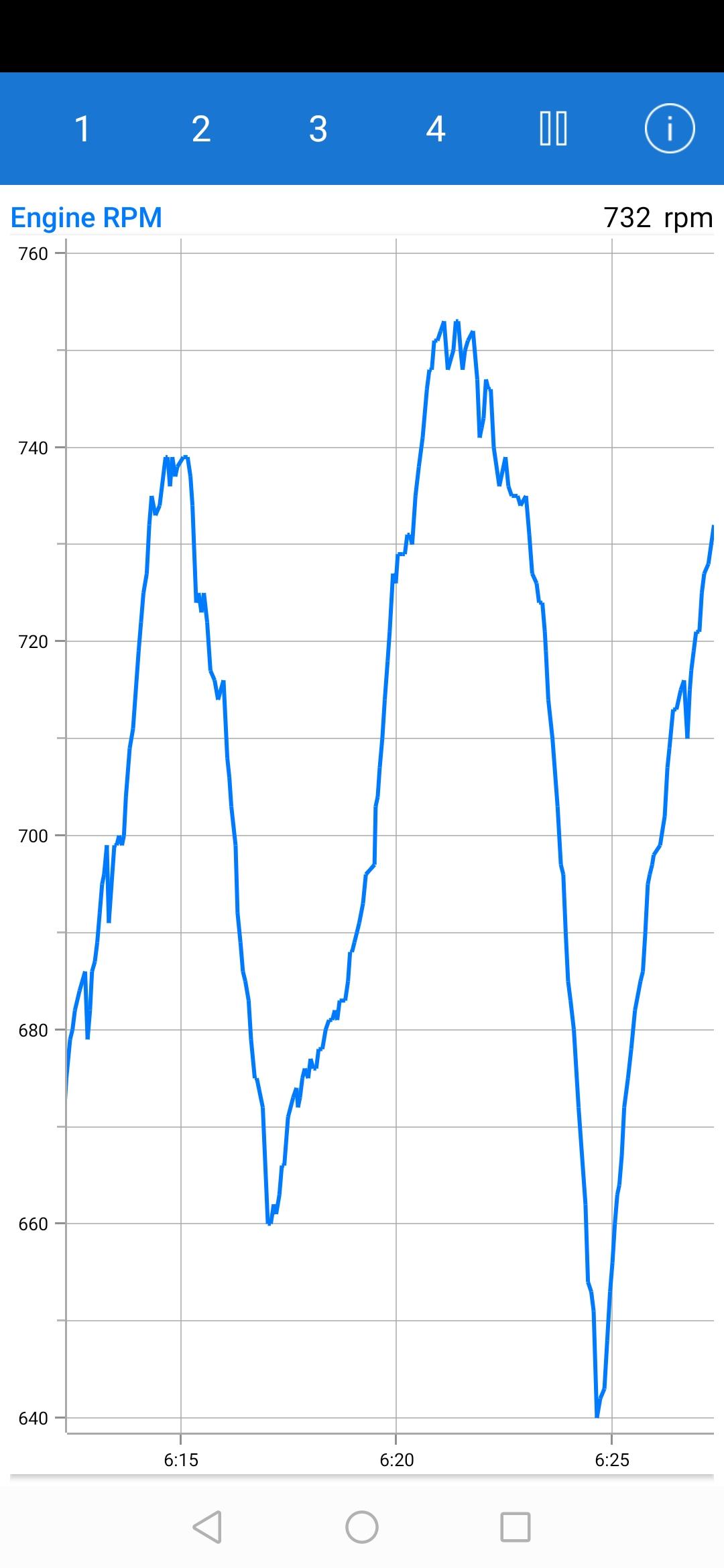

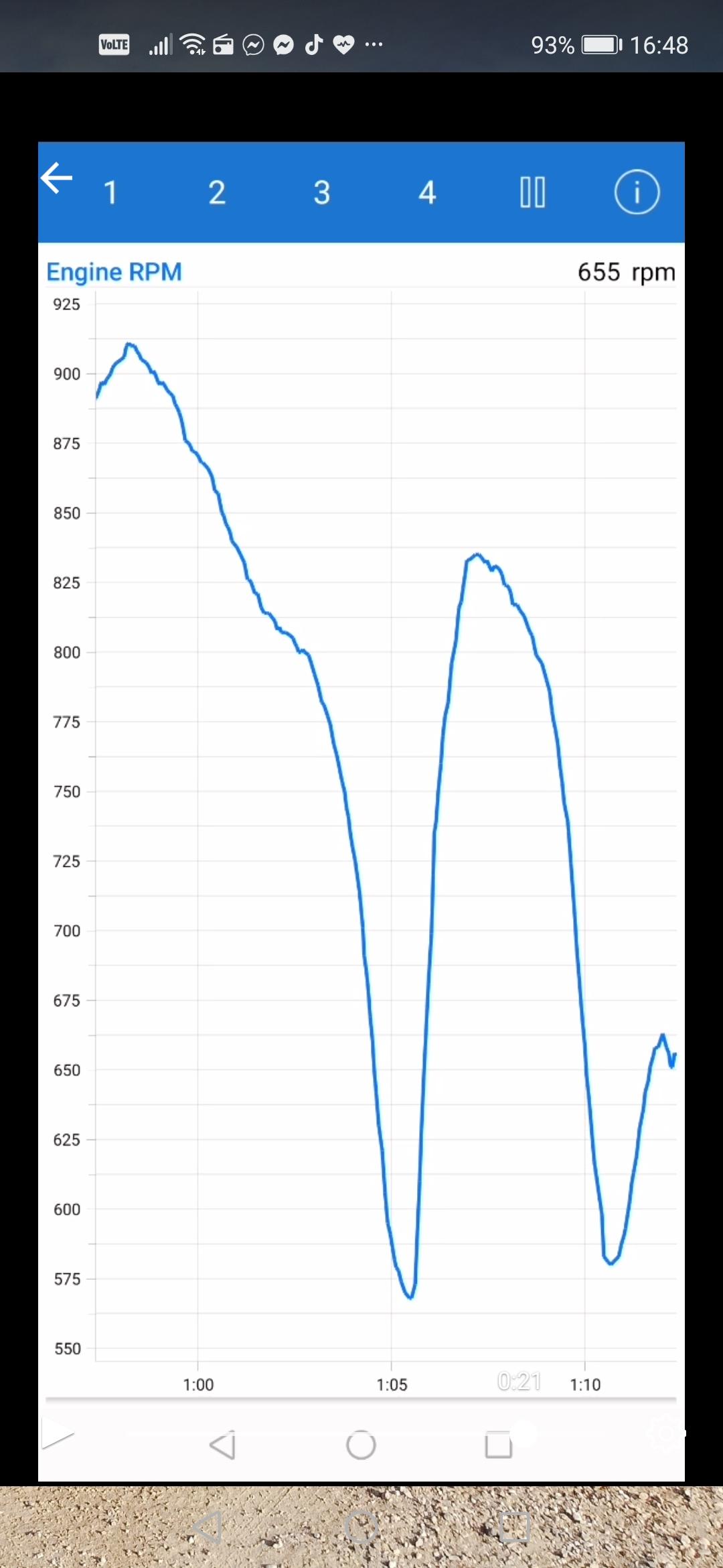

Hello I own a Corolla 2019 1.2 turbo!
EXPERIENCING the same issue!!
35 000 km
When a/c is turned on idle is almost perfect as stated in service manual 650 to 750 rpm....
More like 700 rpm in real
When turning off the a/c, idle goes Nuts from 580 rpm to 850 rpm up and down suddenly like loosing a cylinder!
No check engine nothing....
Suspecting carbon on intake valves, or clogged direct injectors....
Anyone made sense of the issue or figured it out? Screenshot_20210923_221027_com_ovz.carscanner.thumb.jpg.f0ebd7894bcbcf3790a22dc785b39070.jpg
