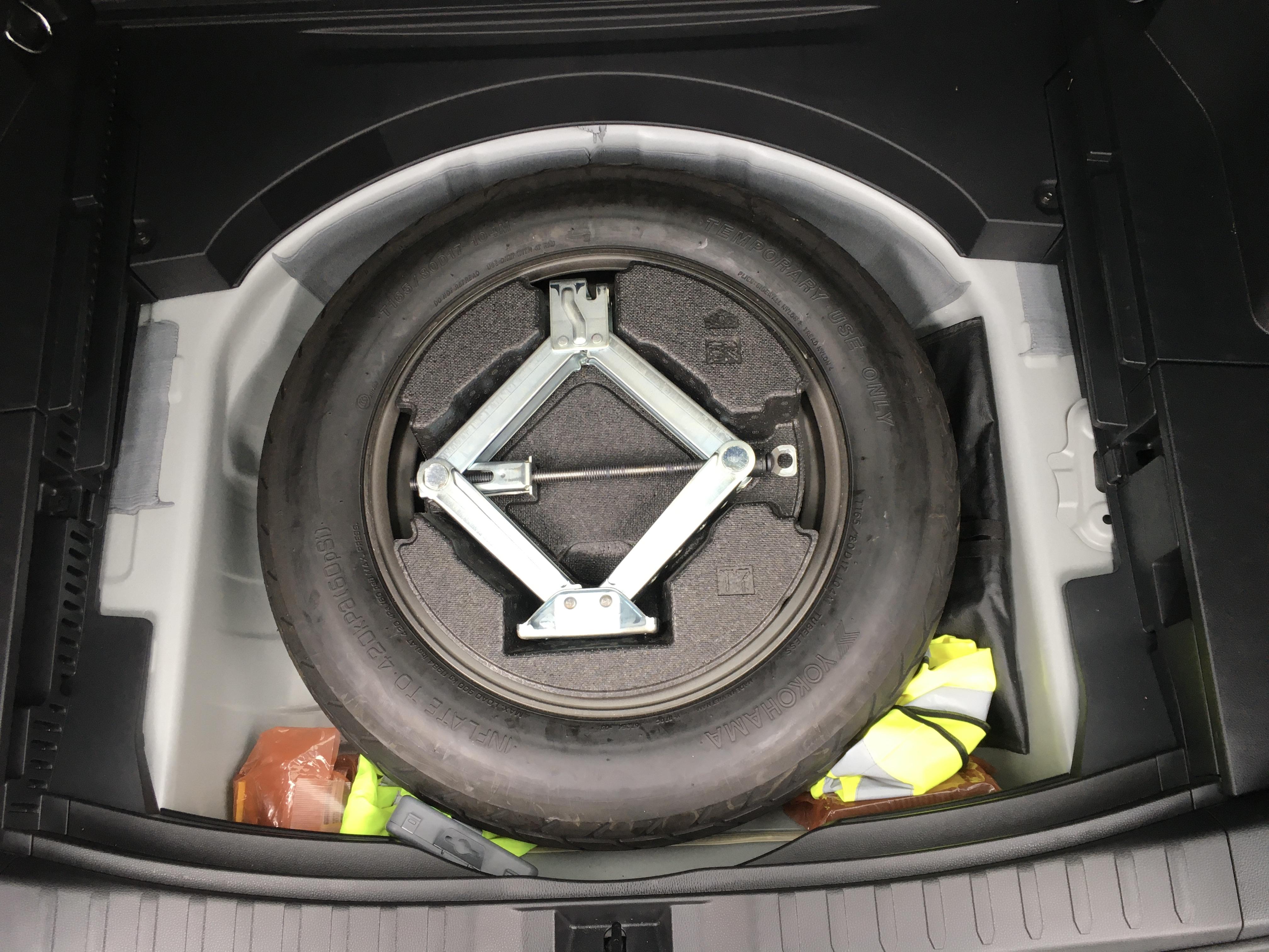

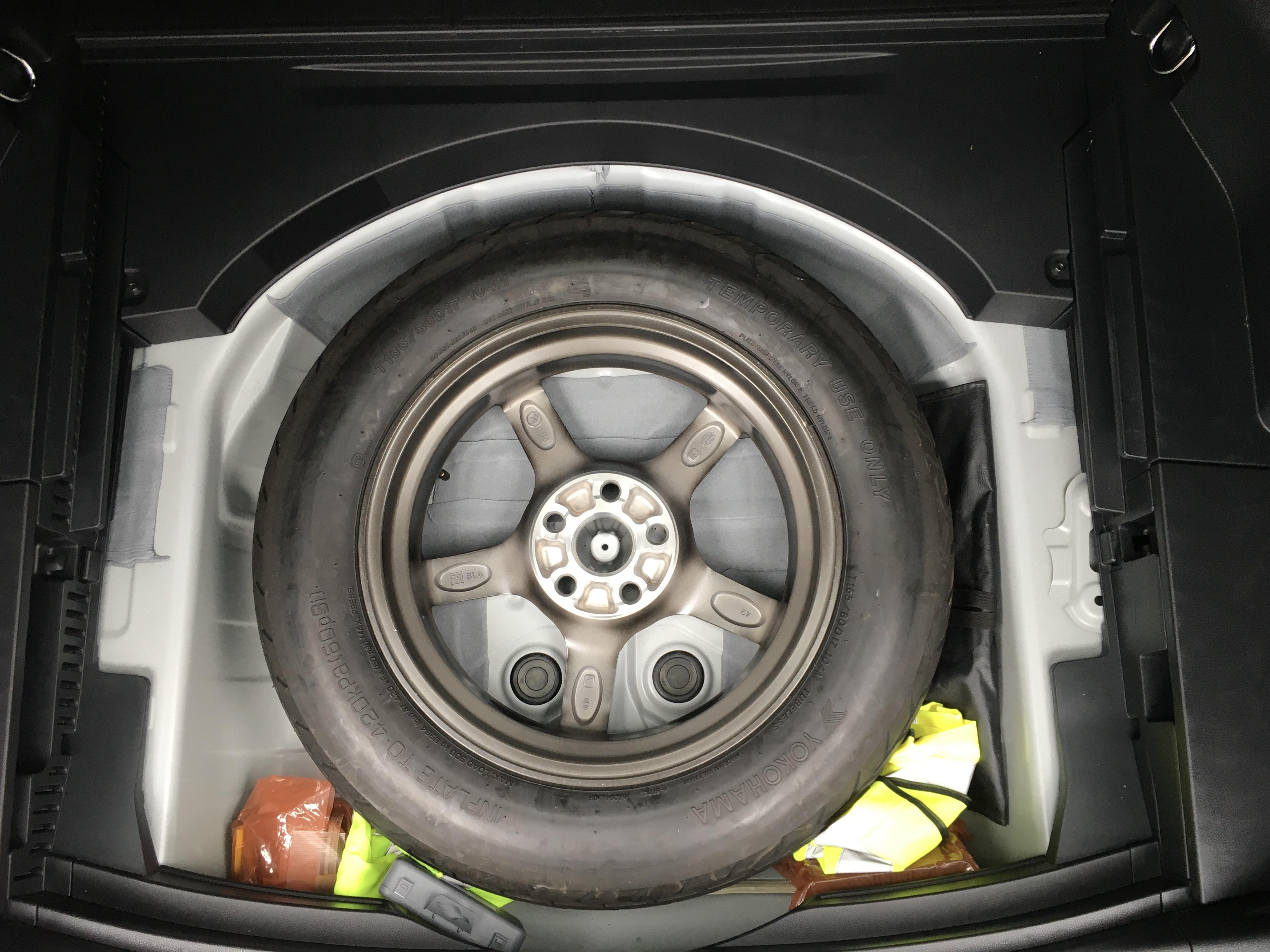

Yes, it was part of the deal. I told them no way i will drive off the forecourt without a spare wheel.
They fitted a space saver on a alloy wheel including the new foam insert, jack, etc... and i keept the pump and gunk as well.

Managed to pick a genuine brand new Toyota Alloy Space Saver, foam insert, jack and tools on eBay for £150.
Still got the inflator and sealant so should be covered 👍

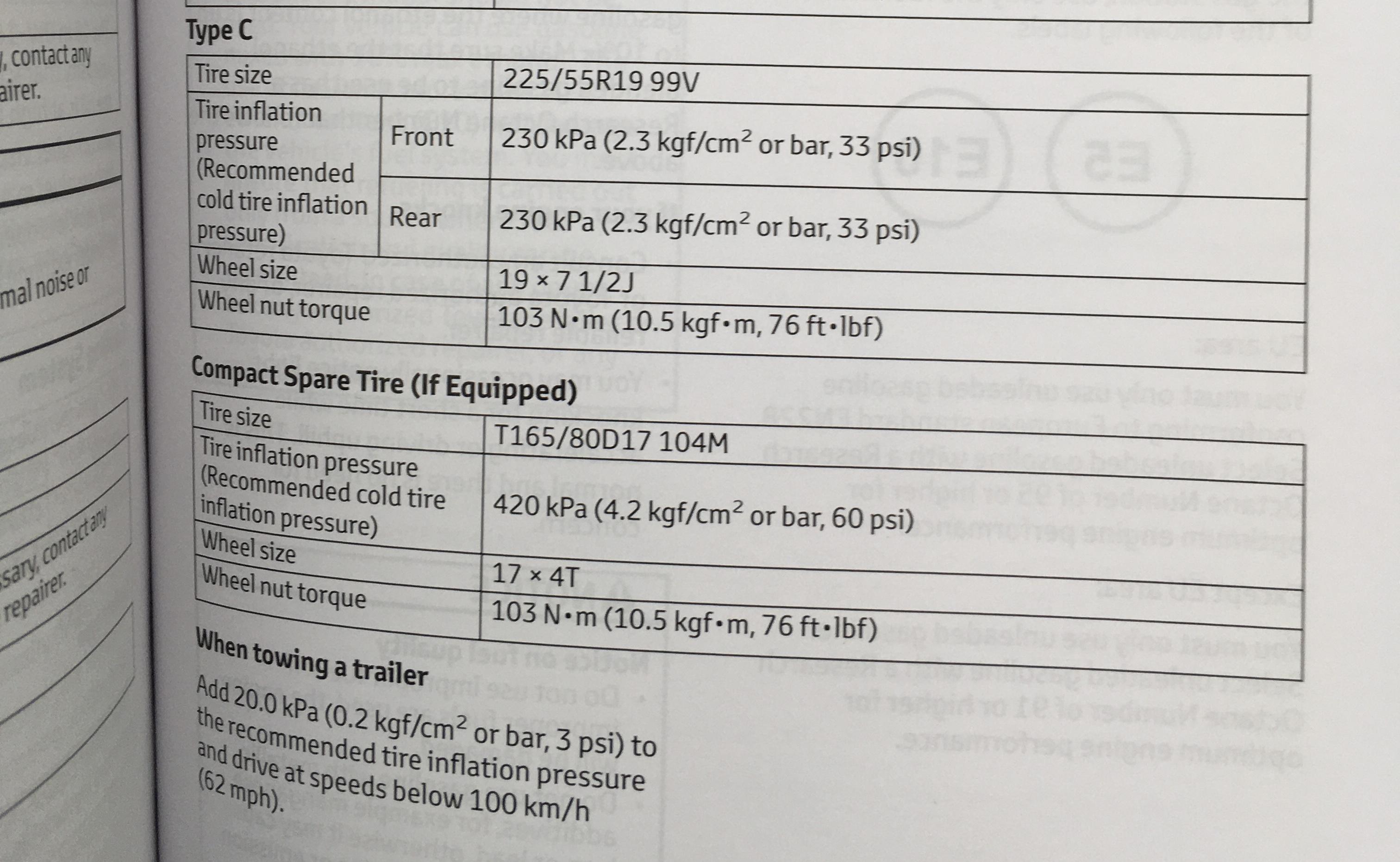

Whether you have 17”, 18” or 19” like my Dynamic the hand book lists the compact spare as T165/80D17 104M

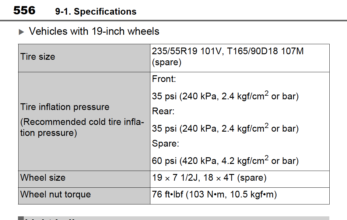

@Rigsby, It might be a weight thing but my manual says differently.

The page I posted was in the paper handbook that was supplied with my new Dynamic in June (UK).
I have the 19” wheels (standard on the Dynamic model, and the tyres are 225/55 19 (as listed in the UK supplied handbook) and not 235/55 19  that are listed on your attachment.
So some conflicting information, did you get your information from your UK handbook or from the internet, if so was it Toyota US or UK site ?
You have an HEV, Ernie has a PHEV - very different cars it would seem ...
So, the RAV 4.3 and 4.4 ran on 235/55R18s (amongst other sizes). The OEM spare was the same 165/80R17 which is 2.9% smaller in diameter that the road wheel and therefore a reasonable 'fit' for a low speed, short range get you home spare.
The RAV4.5 HEV went down to 225 width tyres - I'm guessing that was to reduce rolling resistance etc. and thereby marginally improve fuel economy. The same OEM spare (165/80R17) is now between 4.0% and 4.7% smaller in diameter that the road wheel - so not such a good 'fit' but, presumably, legal and within acceptable tolerances.
The RAV4.5 PHEV went back to 235 width tyres - whether to better spread the vast bulk of the overweight Battery or better handle the torque that the PHEV can put down I really don't know, but that's what Toyota has done. A 165/80R17 space saver would now be 6.6% smaller than the road wheel and I strongly suspect that that is NOT within acceptable tolerances even for a low speed, short range get you home spare. Instead, Toyota have specified a 165/90/R18 which is actually 1.6% larger than the road wheel.
Aftermarket suppliers such as KOM and Road Hero offer a 155/85R18 as a space saver spare (as Ernie noted in the second post of this thread!). That is in practice between 0.4% and 1.1% smaller than the diameters of the road wheels on a RAV4.5 HEV and, thus, a rather better fit than the OEM offering from Toyota. It is also only 2.9% smaller in diameter that the roadwheel fitted to the PHEV and therefore, I believe, a perfectly acceptable alternative to Toyota's 165/90/R18 offering.

@Rigsby, my tyre data image was from the online handbook that’s available when I log into my Toyota account, it’s identical in that respect to the paper manual (which is rubbish).
