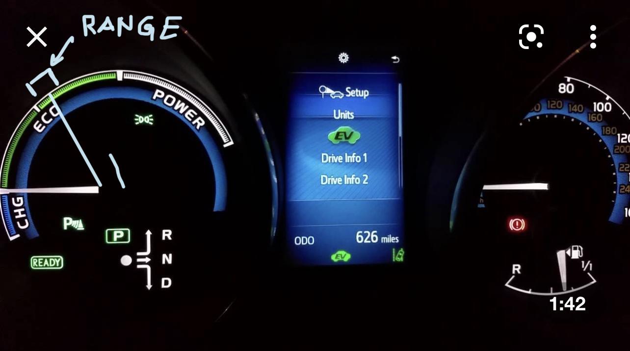

im new to this forum. I’m from Austria and I drive a Toyota Auris Hybrid Touring Sports 2017.
and since a few weeks I’ve got a little (hopefully) problem.
In light load (in the range when both engines are working together, look at the foto) the engine is slightly stuttering. If I get out of the range shown at the foto everything is ok and smooth.

Sorry that’s the problem range

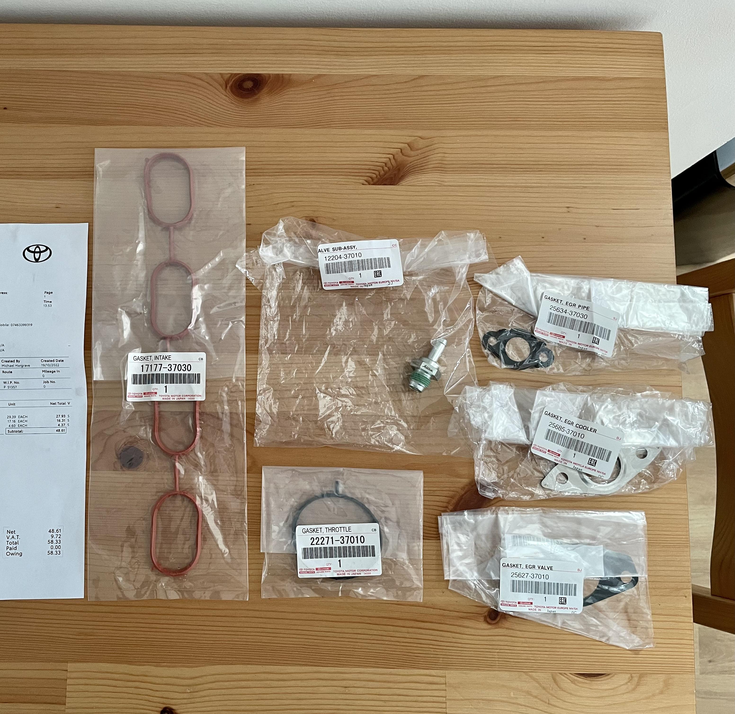

Ok, parts are here and it will be a big job after two weeks if weather allows me to do it. Here all the gasket and the pcv with the oem numbers. No need to change the metal gaskets if you open for first time. All other needs to be changed. Throttle body gasket can also skip first time. They are not expensive so better get a new ones. The price on the invoice is for the intake manifold gasket, throttle body gasket and pcv. The other ones are cheap, perhaps another £15 on top. 👍
