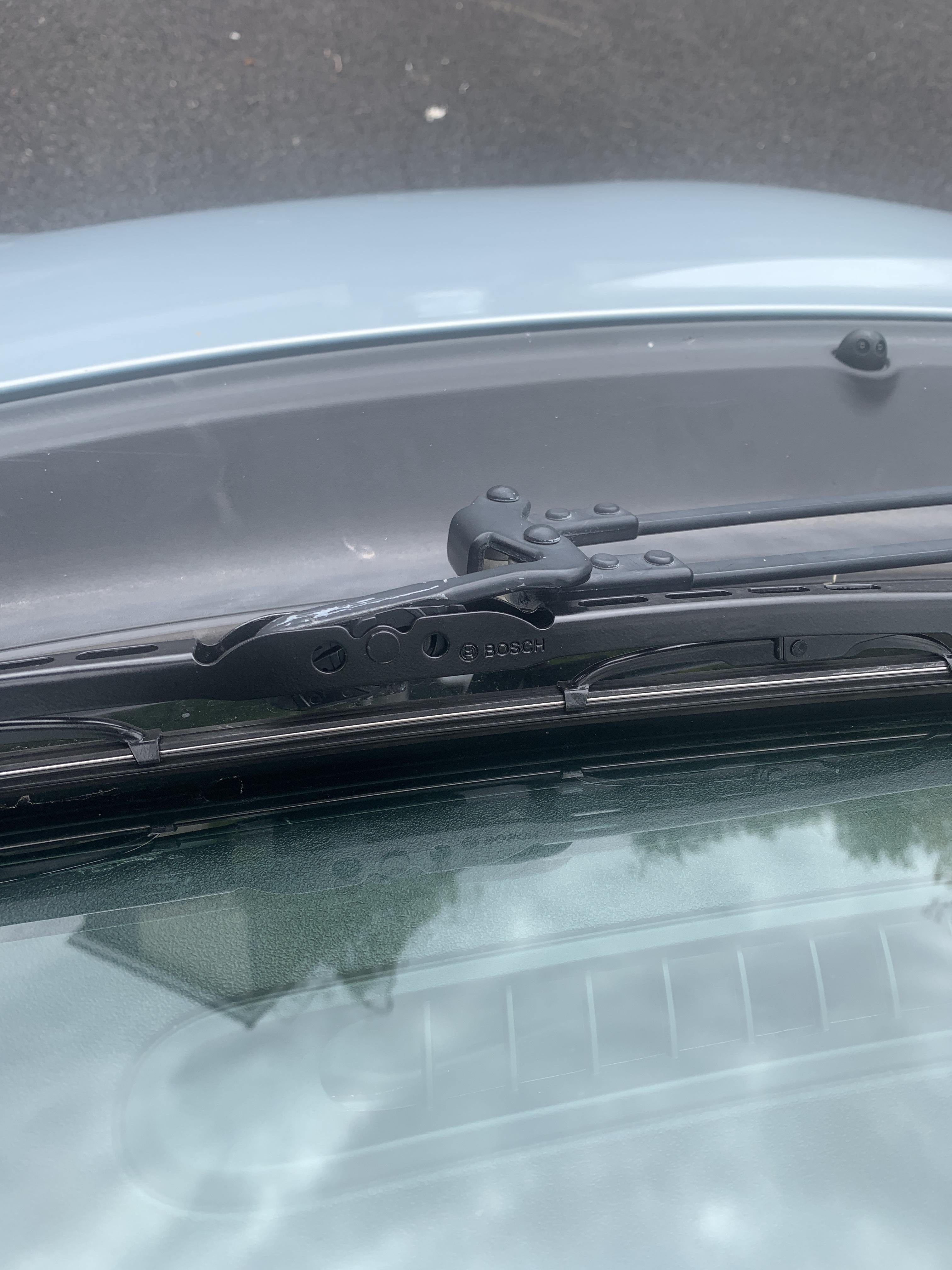

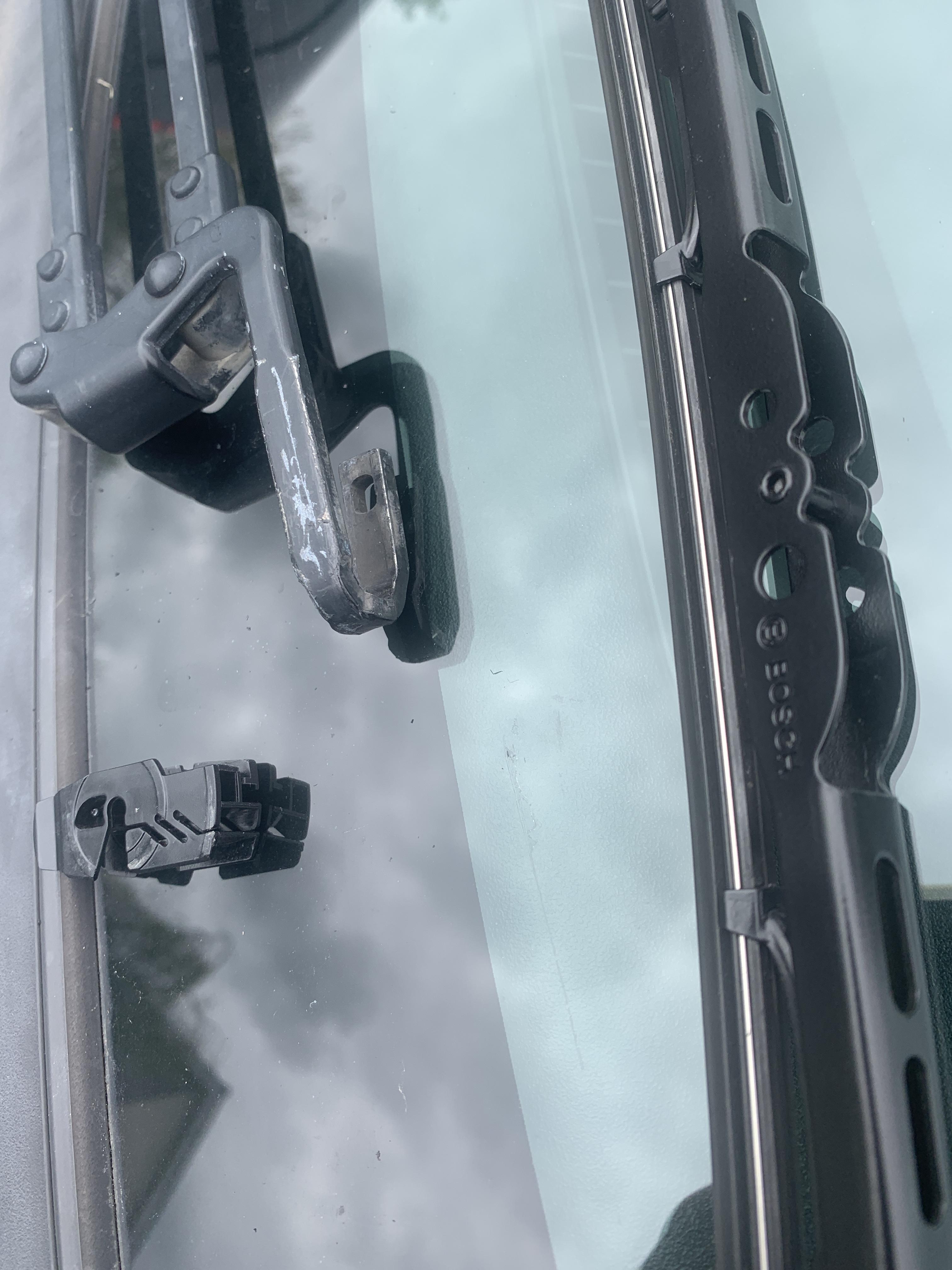

Front wiper blade fitting fail
What's the part number on the blade ? (651U ?) It should have come with a new clip , Do you have the clip the right way around ?
1 hour ago, Billyboy81 said:
It should just slide into place and the little retainer peg clicks home.
That's the one, only one side has a clip and tab
That said, i think ours has an upgraded one (only bought car recently). The plastic part clips on the blade then slides into the hook
Thanks for all the replies
Bosch wiper Blade Super Plus SP26, Length: 650mm - Single Front wiper Blade
Yes, there's a square hole in the arm hook which I thought would receive a matching male square but there's none in the plastic part that slides into the arm hook - so it can easily slide out again.
It's the wrong blade for the Aygo
either 651U or AR26U
stop being a tight wad and pay the extra for the correct blade, the better aero twin blade (AR26U) is cheaper than the standard one  😉😉👍
