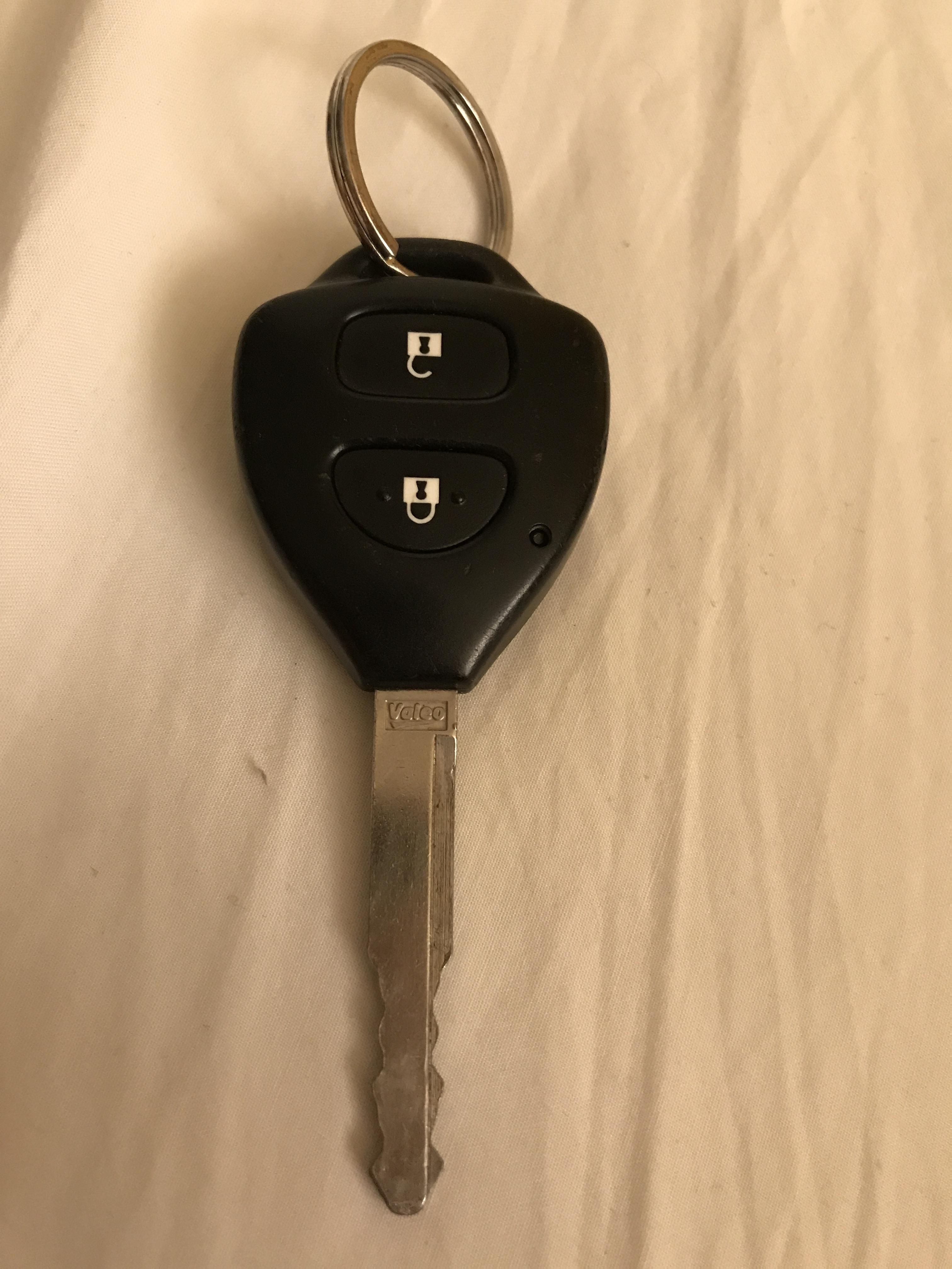

I opened the door using the key manually and none of the other doors opened so I’ll check the Battery to see if it’s that . Thanks.image.thumb.jpg.ef9010795f767b87d1d3371956c9905f.jpg
Do all the doors lock/unlock normally if you use the manual button located on the drivers door control panel (where the window up/down buttons are).
If they do not, and if everything else is normal (starts, drives and operates correctly) then it sounds like a genuine problem/fault somewhere.
If it does not start and drive normally then the first check has to be the Battery voltage as others have mentioned.
Hi , yes they all work normally but is that because at the minute everything is back to normal , I mean the doors all open with the fob, it only happens every week or so that I can’t access with my fob and have to use the key manually, and apart from that the car drives as it always has done with no problems
That sounds a strange problem then and possibly beyond the scope of a simple diy fix. The only two things that I can think of based on you saying earlier that the lights flash but the 'click' was quiet is that there could be some high electrical resistance in the supply to the the four door solenoids.
For reasons that are difficult to explain (as to why just the locking might be affected) I think its worth checking the security (tightness) of the Battery terminals under the bonnet. Make sure the two leads are tightly clamped to the Battery and not slack or loose.
The other thought is possibly a faulty electrical relay for the door locking. The only way to prove that easily is by substitution.
Next time it happens (and this is only any use if you can get into the car manually with the key and still keep the problem of the doors not locking) then put the headlights on (without the engine running) and see if the doors now lock/unlock.
Are the headlights bright in that state?
Beyond that and I think you are looking at more advanced fault finding which if the problem is so intermittent is difficult.
