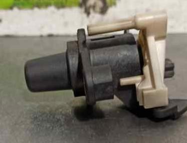

Can you release it by hand ? First step is to clean it all up - i just noticed the solenoid isn't connect to anything
Has the post on the white plastic part snapped off should be a long post that the loop of the solenoid goes on

It's a bumper off job, 2 bolts to remove the lock, the solenoid has more than likely weak, there are plenty on eBay - you should be able to remove the solenoid from inside the car

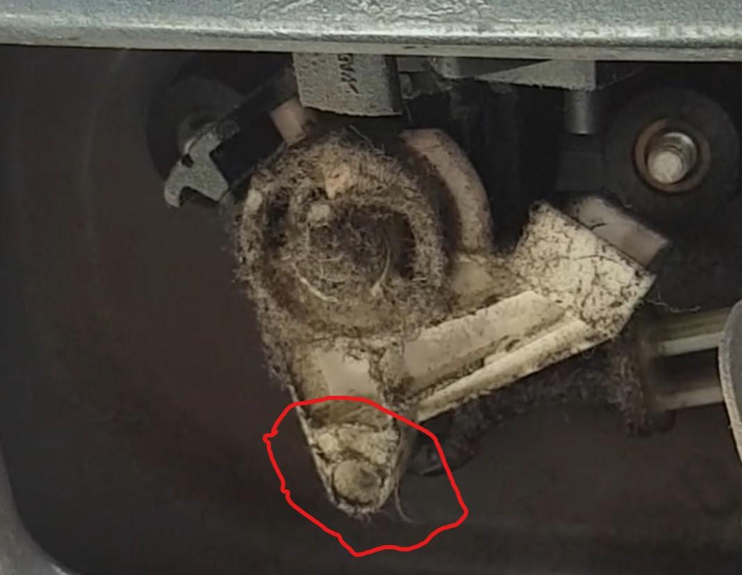

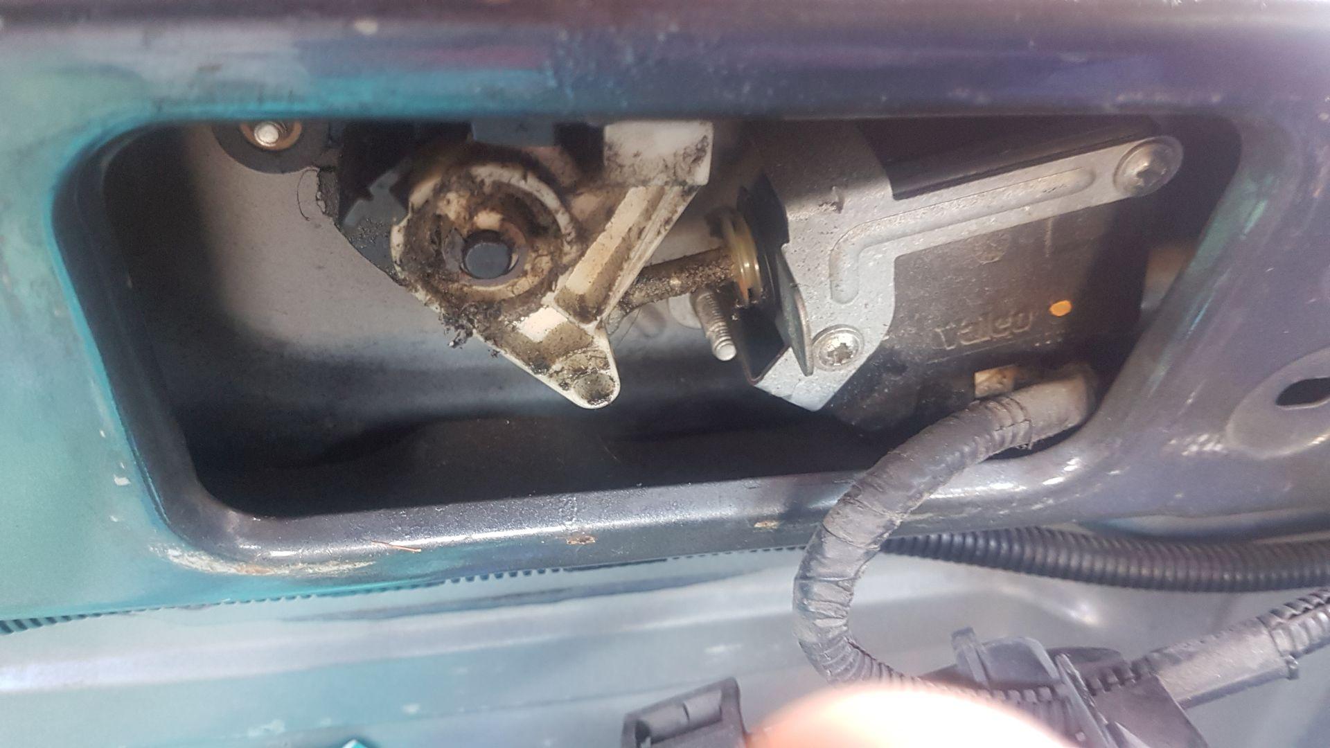

Had another look at it this morning.
Seems not possible to remove the solenoid by merely removing the two philips screws.  Check my pic.  The solenoid end is hooked around the plastic rod of the release/lock mechanism, so that will need to come out first.
Sigh. Back to removing the rear bumper. 😪

If you remove the two cross head screws on the right the solinoid itself you can remove unless shaft is connected via a eylet pin.
Then check on how easy its moves look to see if it will plunger will drop down under its own weight turn it up the other way and it should slide back.
When you unplug it check connections are not coroded.
Remove  circlip then you can tug slightly with a turning action do this with key in unlocked position leave key in barral lock.
If you have to remove the nuts one is just on show top left another lower right under solenoid.
When solonoid is out oil other end of its shaft.
Check its movment when operating key fob before replacing it
I was afraid of that, then you choices are remove it as a compleate assembly or drill a pilet hole into pin if you have no taps then just use a self tapping screw.
After it takes hold try turning it in a clockwise direction while pulling it forward.
If you fail remove compleate assembly then put a socket thats larger than the pin over it and use a punch or a screw to knock it through.
On replacing pin after cleaning and lubricating it use a center punch about 3 times around the circular groove area to keep pin in  locktite just one end of pin push in and lubricate it afterwards.
I sugest you also remove the bracket above solenoid in your picture clean and lubricate the linkage inside.
This is your photo where door D buckle moves into bumper locking mechanism.
The latch is on the car, the striker is on the tail gate, the reverse of most other hatches
The bracket and release button are bolted from the outside of the car, to take them off you need to remove the bumper
