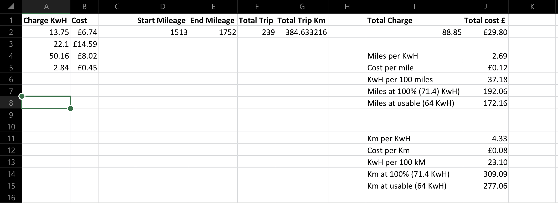

Results of my latest efficiency data analysis. This was a 4 day trip from Nottingham area to Manchester so included motorway driving there and back plus local travel. Had the AC on auto and eco for most of the trip (turned it off for a bit on return journey as it was warm enough in the car ).
Car is the AWD Premium.
I didn’t do any special planning but left with 100% charge at home and charged back up at home to 100% on return). Home is about 16p per KwH at the moment with the government subsidies.
During the trip instead of using fast or rapid chargers I made use of Type 2 A/C destination chargers at 7Kw which means I was comfortable to charge to 100% each time. They cost 45p per KWh at Meadowhall and 66p at Salford Quays. I didn’t choose these locations because they had destination chargers but made use of them when I found them. Both required different apps downloading and accounts setting up.
I’m a firm believer that destination charging is more essential to future EV use than rapid charging, it was fairly painless, no pressure to stay with car for when it got to 100% and no queuing. Both places had plenty of spaces.
So 2 top ups on the journey plus two overnight charges at home to get back to 100% (first one got me to 98)
Full data below but journey cost me 12p per mile or 8p per kilometre. As before that is plug to wheel energy usage and not taking into account any charging losses.
I’ve also done some calculations on theoretical efficiency based on full use of the 71.4kwh Battery and the 64kwh usable Battery.

Malop - thanks. An interesting report. "2.69 Miles per kWh" - not bad in my experience, albeit dire when compared to WLTP. How would you broadly describe your driving mix?  Have you a heavy or light foot?
I don’t hyper mile but also not racing off at very light and straight road. I stick to speed limit.
My MyT driving rating for the return journey was 88 with 3 warnings for hard braking (or bloody idiot drivers as I call them)
