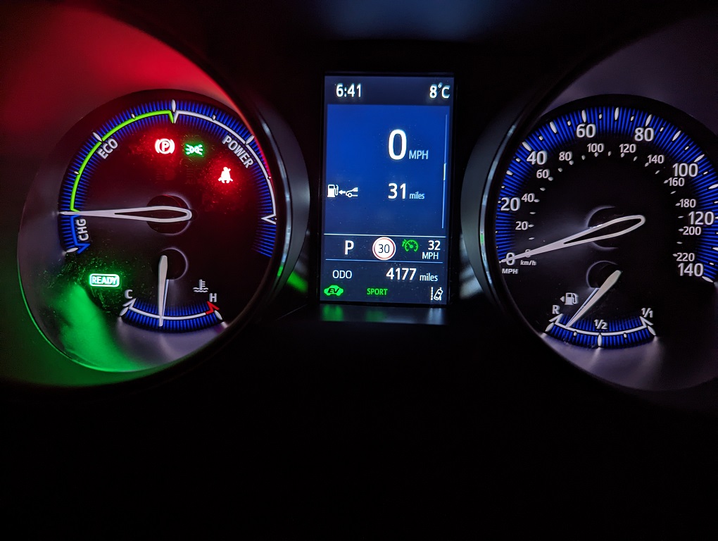

17 minutes ago, Dynamic Mark said:
Thanks for all the messages but it definitely is not an option - I’m off to the dealer to get it sorted 👍

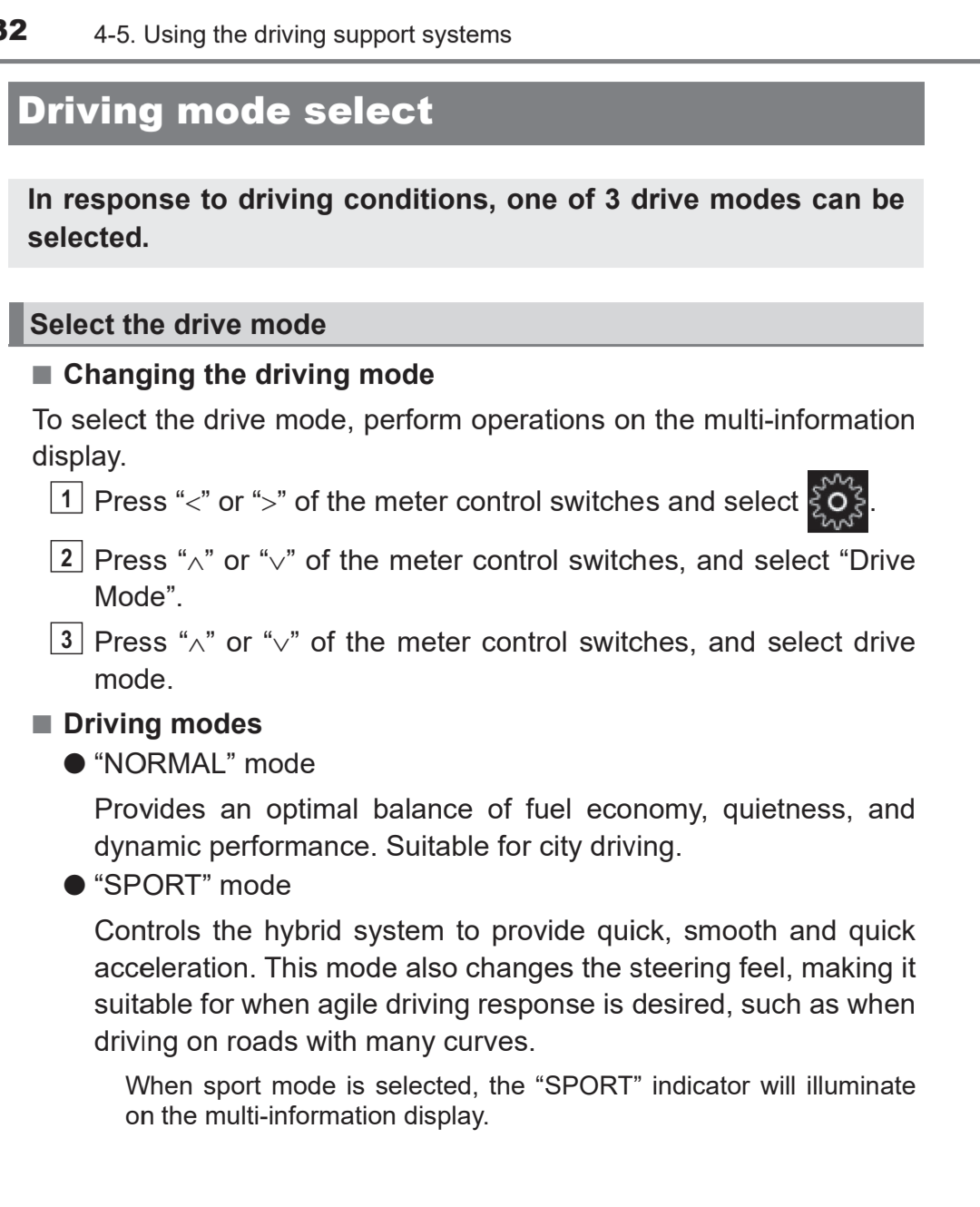

Page 428 of the Owners manual (for a 2021 car):
■ Changing the driving mode
To select the drive mode, perform operations on the multi-information display.
Press “<” or “>” of the meter control switches and select <cog icon>.
Press “up” or “down” of the meter control switches, and select “Drive Mode”.
Press “up” or “down” of the meter control switches, and select drive mode.
■ Driving modes
● “NORMAL” mode
Provides an optimal balance of fuel economy, quietness, and dynamic performance. Suitable for city driving.
● “SPORT” mode
Controls the hybrid system to provide quick, smooth and quick acceleration. This mode also changes the steering feel, making it suitable for when agile driving response is desired, such as when driving on roads with many curves.
When sport mode is selected, the “SPORT” indicator will illuminate on the multi-information display.
Edit: page 432 of your manual I think ...
2 minutes ago, Dynamic Mark said:

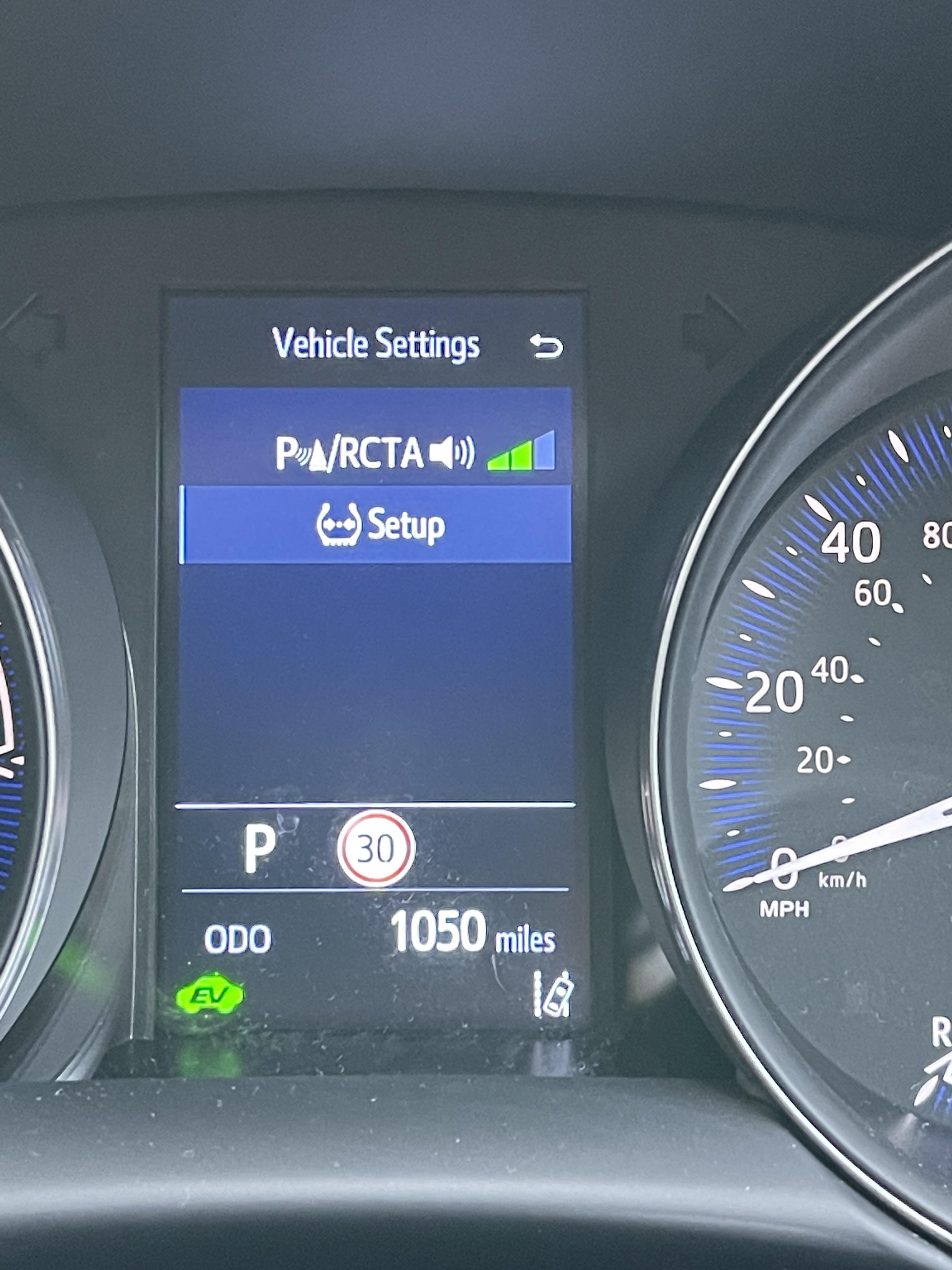

That’s just the issue - if you look at the image I attached earlier in the thread that option is not available ?
OK, your image shows that the car is already in Sport mode ... but you have to press '>' or '<' to get to see the available options (as it states in the owners manual 😉 ).
4 minutes ago, Dynamic Mark said:

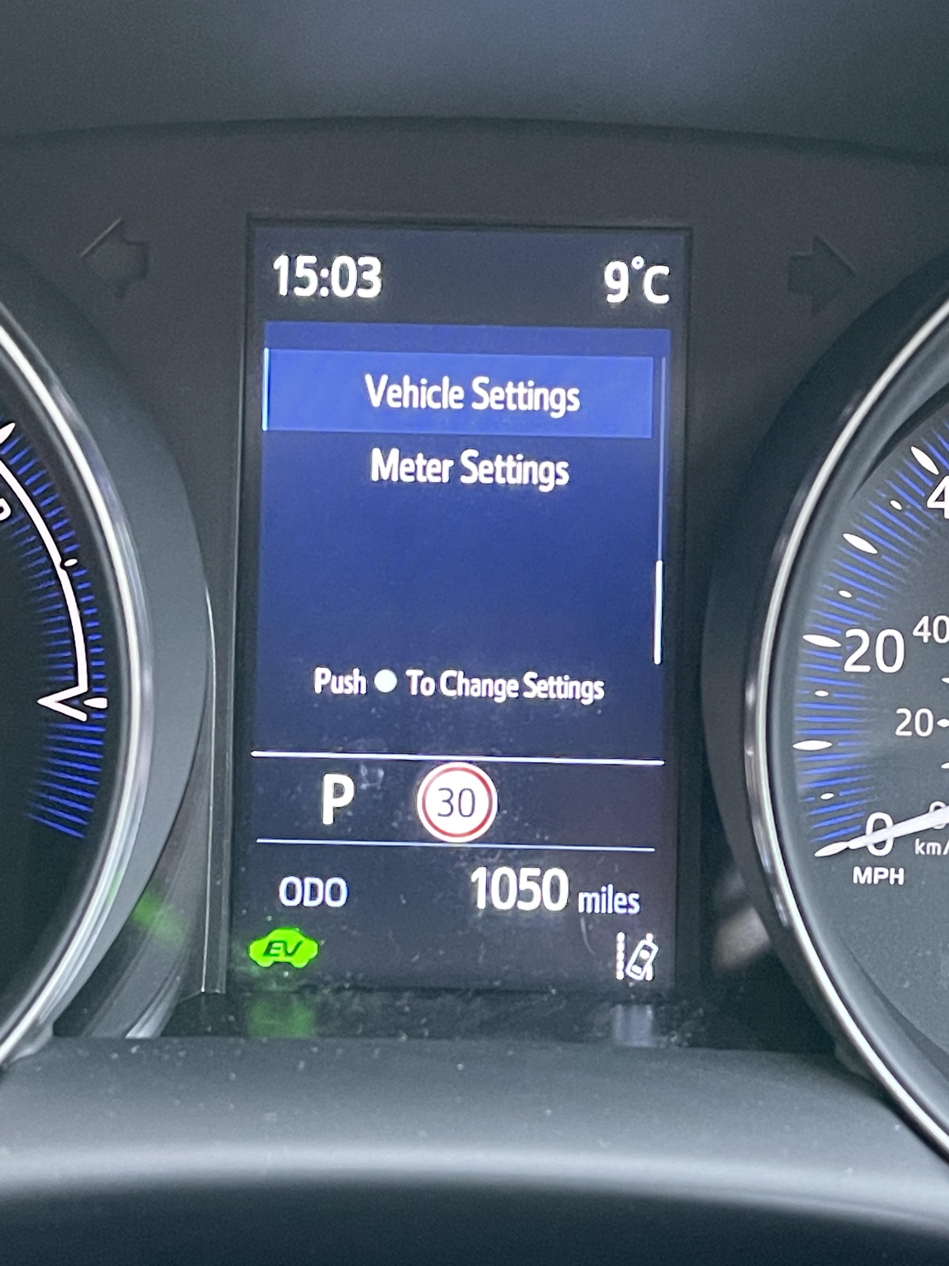

Mine is the first image not the second one as that’s a response - it’s definitely Not available on my car for some reason ?
Sorry, my bad as they say ... your image shows the Vehicle Settings option. Are you saying that there is no Drive Mode option at all?

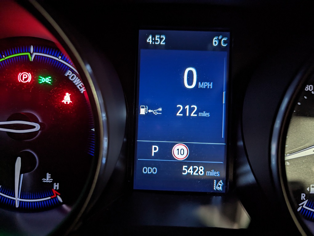

From this screen

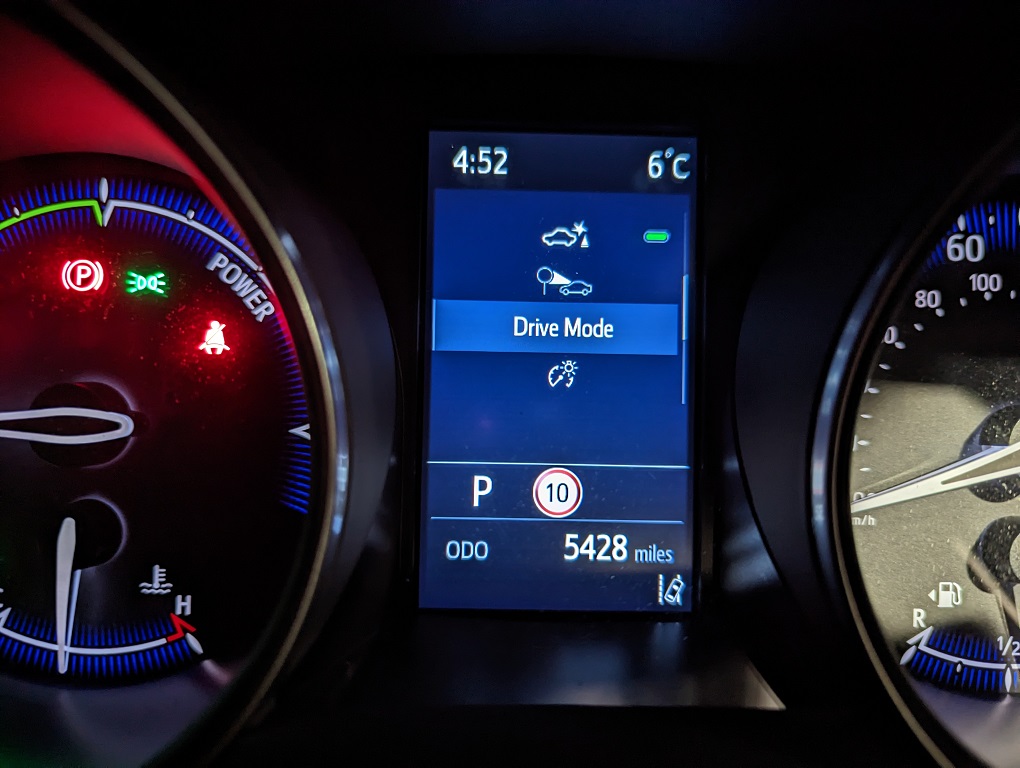

Using the right hand side of the steering wheel buttons, press < button to get to this screen.

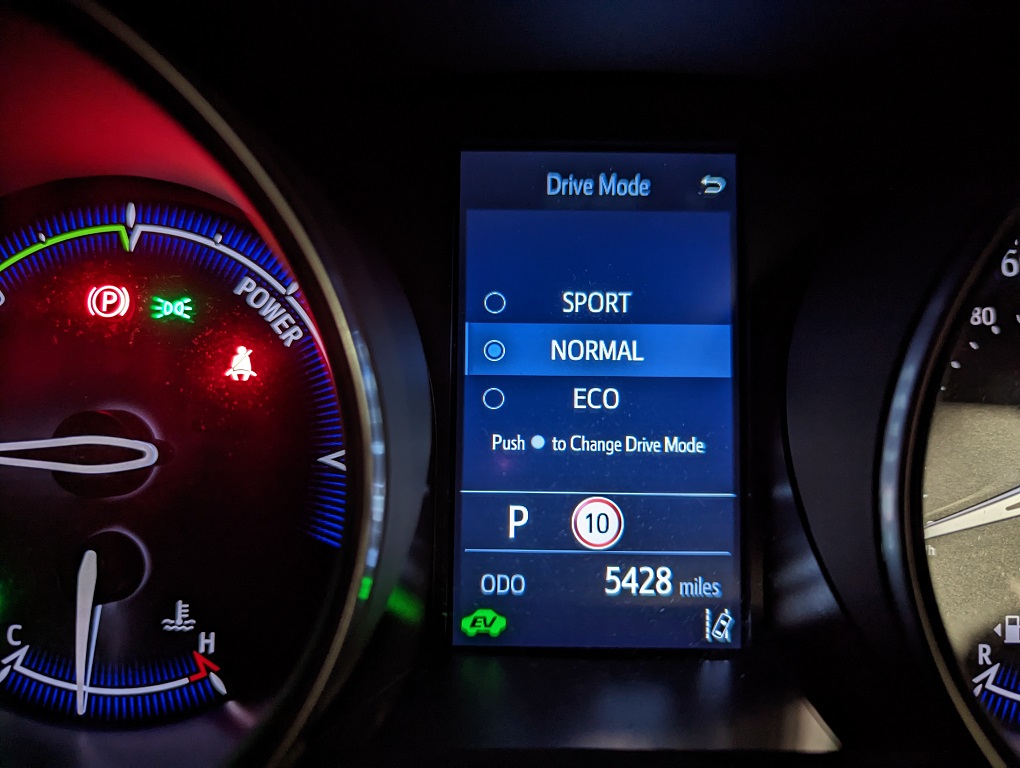

Then press • to get to this screen.
Select the required drive mode using the up / down buttons then press • to select it.
28 minutes ago, Dynamic Mark said:
Hi - following those guidelines I still only see the options attached - Toyota next stop997AC2F9-AEF1-4A7C-B682-6B671A61BED1.thumb.jpeg.86307f0081ceef81d1d537f0bcff5a30.jpeg997AC2F9-AEF1-4A7C-B682-6B671A61BED1.thumb.jpeg.86307f0081ceef81d1d537f0bcff5a30.jpeg
Understand that,
check with Toyota, it might be a software glitch or something. See what they will say and then you may try to disconnect the negative terminal of the 12v Battery for around 20 min. Re connect and go to the settings see if modes are available.
Good luck 👍
just to be sure.. are you sure you aren't in the bottom of the menu, so pressing the up or down arrow you will jump to the other page?
