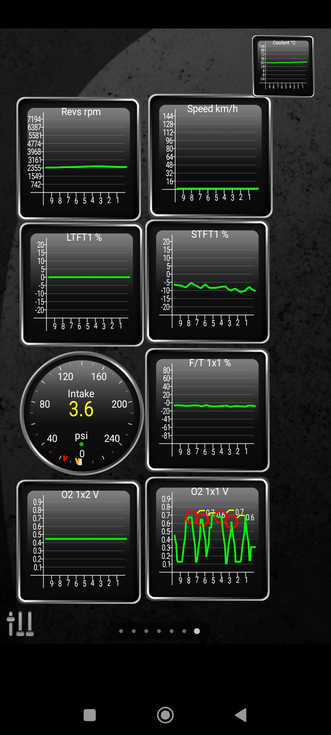

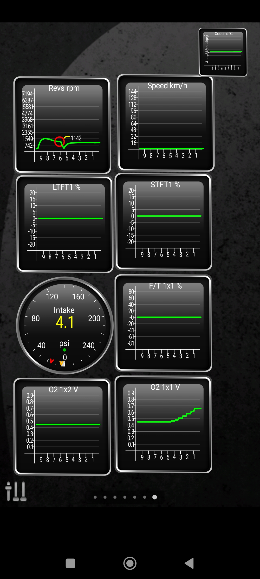

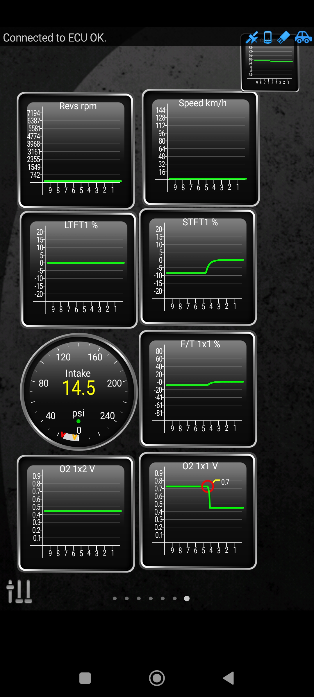

What is the MAP psi at 2500 rpm, and what does it read ignition on, engine off ?
14.5 psi ignition on, engine off
4.1 psi engine on  no press on acc pedal
3.6 psi @2500 rpm
